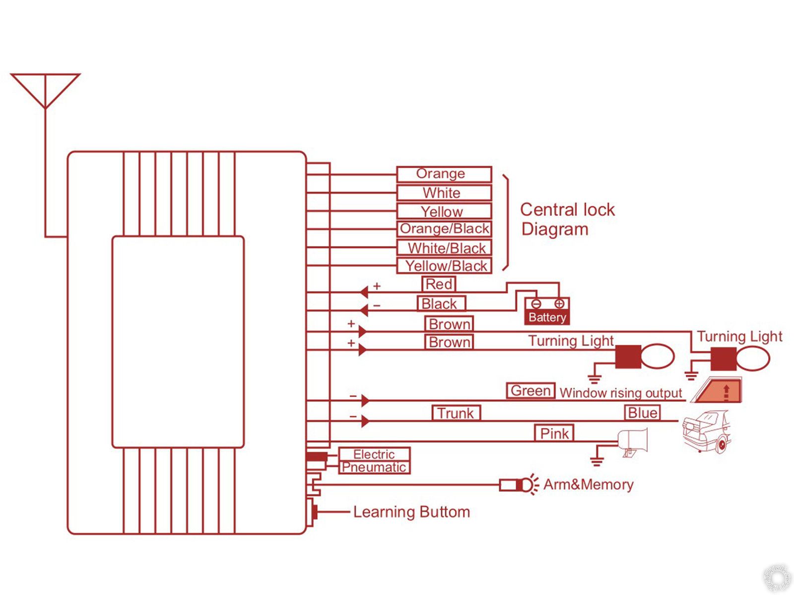

I have installed in my car a Lanbo Lb-405 keyless entry. This unit as per instructions shows a window rising output option.
There is a single wire for this in diagram below. Does any one know what is needed and how this can be wired in the car?
Window Rising Output -- posted image.

This is usually a 15-second negative going output that is used to drive a window rollup module.
Wiring of that module would need to be configured for your specific vehicle (which you haven't identified).

Ok. but in general what type of hardware would I be looking for or need? This car got electric windows throughout if the module it is in car and a straight forward installation I would like do it at the same time keyless installation is done.
I assume the car wouldn't come factory fitted with a roll up module or? If so I don't think this would be fitted in this particular car.
I didn't have any wiring diagram for this car and I have managed just using the multimeter to install the keyless and yes it is harder but possible without any documentation.
I will soon be doing the very same keyless installation in another car and would be helpful to know what to look for to do all the necessary wiring.

You need to buy something like the following:
https://www.ebay.ca/itm/4-doors-car-window-closer-module-working-with-car-alarm-auto-window-up-output/283124465453?hash=item41eb887f2d:g:kwYAAOSwlfxXF1LM
If your vehicle has a no-hold-down type of automatic up/down feature you won't find this to be an easy installation - best to be avoided IMHO

Thanks. Yes I will leave this for now as it is not really necessary for me.
I am satisfied with the end result with the keyless unit on this car. Thanks for your help
