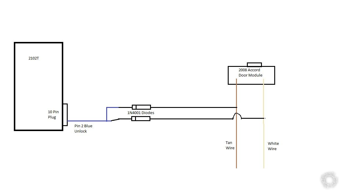

I want to install a dei2102t pke on my Honda Accord I have to diode isolate the disarm and unlock wire just wondering if somebody could make it quick schematic for me on how to do it I can easily follow that hairs the wires for my car LOCK      Orange      At switch in driver door       -
UNLOCK      Brown      At switch in driver door - Double pulse to disarm and unlock. May require a pulse to WHITE wire at same time as BROWN, diode isolate.

POWER UNLOCK    TAN AND WHITE (-)TYPE B, (REQUIRES DOUBLE PULSE to UNLOCK)    @ MODULE INSIDE DRIVERS DOOR
Obtain two 1N4001 diodes. Any 1N400x will work.
Use the 2102T Blue wire at Pin 2.
Connect as follows :
2008 Honda Accord, DEI 2102T -- posted image.
