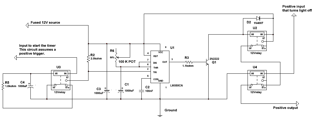

you could base it around this:

The author says about 1/2 a second, hmmm i guess thats not too close to 15 lol... you could increase the cap value for a longer on time, but it might be a bit too large to get the desired effect. If you want i will do it using a 555 timer, then you can adjust from 1 second to 30 seconds what you want.. let me know.

here is what i came up with, by adjusting the pot you can have between 0 seconds and 111 seconds.

nice diagram. Thanks for all the help
