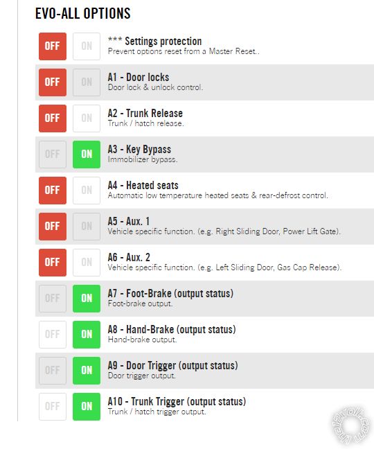

Need help for installation issue
Mazda 5 2012 (regular key) + fortin evo all (Data-link ,D2D) + Viper 4806V Led 2 way remote start
Simple installation, after i found Mazda 5 2012 have anti-theft alarm ( Horn trig when unlock door with viper remote)
I make new connection for door lock \ unlock
Factory Alarm Arm blue/orange (driver door key lock)
Factory Alarm Disarm lt. GREEN/ red (driver door key unlock)
It's ok for lock and unlock with viper remote but when i start with remote start anti-thieft trig again.
Didn't found any option in viper 4806V unlock before remote start for disable oem alarm before start so I make new connection
unlock door and disarm GREEN/ red (driver door key unlock)
And lock with Power Lock blue -1000 ohms kick
So it's like i never arm oem mazda anti-theft.
But it does have better way , didn't find anything helpful in fortin Evo-all did a miss program option in Viper 4806 ?

Sorry my mistake javascript:AddSmileyIcon('Mazda 5 2012 Fortin Evo All Viper 4860V -- posted image.'), my girlfriend change is old mazda 5 2006 (no alarm) by another mazda 5 (2012) i do know at installation about mazda (factory alarm) (never trig)
bit confuse by wiring clor fault by wire color (fortin) and other online web site.javascript:AddSmileyIcon('Mazda 5 2012 Fortin Evo All Viper 4860V -- posted image.')
I forgot the keysense wire, so when i remote start, mazda factory alarm detect ignition but no key so he trig the horn.
+12V keysense wire on ignition 2 on the viper 4806V and voila.
For the door I let unlock with wire form the external key barel (unlock disarm) and lock by the inside switch (lock only ) so factory alarm should never rearm for the doors.
My girlfriend dont want factory alarm for the door , exemple if she goes at grocery and my older kid stay in the car if she lock with the remote and rearm factory alarm , if my kid go out after 20 secondes of the car the alarm will trig at the door opening
She want Simple simple simple. javascript:AddSmileyIcon('Mazda 5 2012 Fortin Evo All Viper 4860V -- posted image.')
Next project , continous 12V for power windows work without key, add heated seat like is previous Mazda and probably extra new android car stereo Mazda 5 2012 Fortin Evo All Viper 4860V -- posted image. javascript:AddSmileyIcon('Mazda 5 2012 Fortin Evo All Viper 4860V -- posted image.')

thanks silvercivicsir you right previous Mazda 5 a use fortin key overide all , but I just go with fortin recommendation. But evo all is nice with foot brake , tachometer, door status direct without wiring and I have a good price for.
