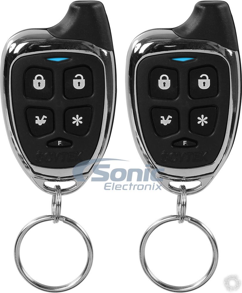

I bet that also means I purchased the incorrect replacement remote... The one I bought looks like this, perhaps I am not able to correctly program things.
Skytek 2000RS Continuously Cranks -- posted image.
