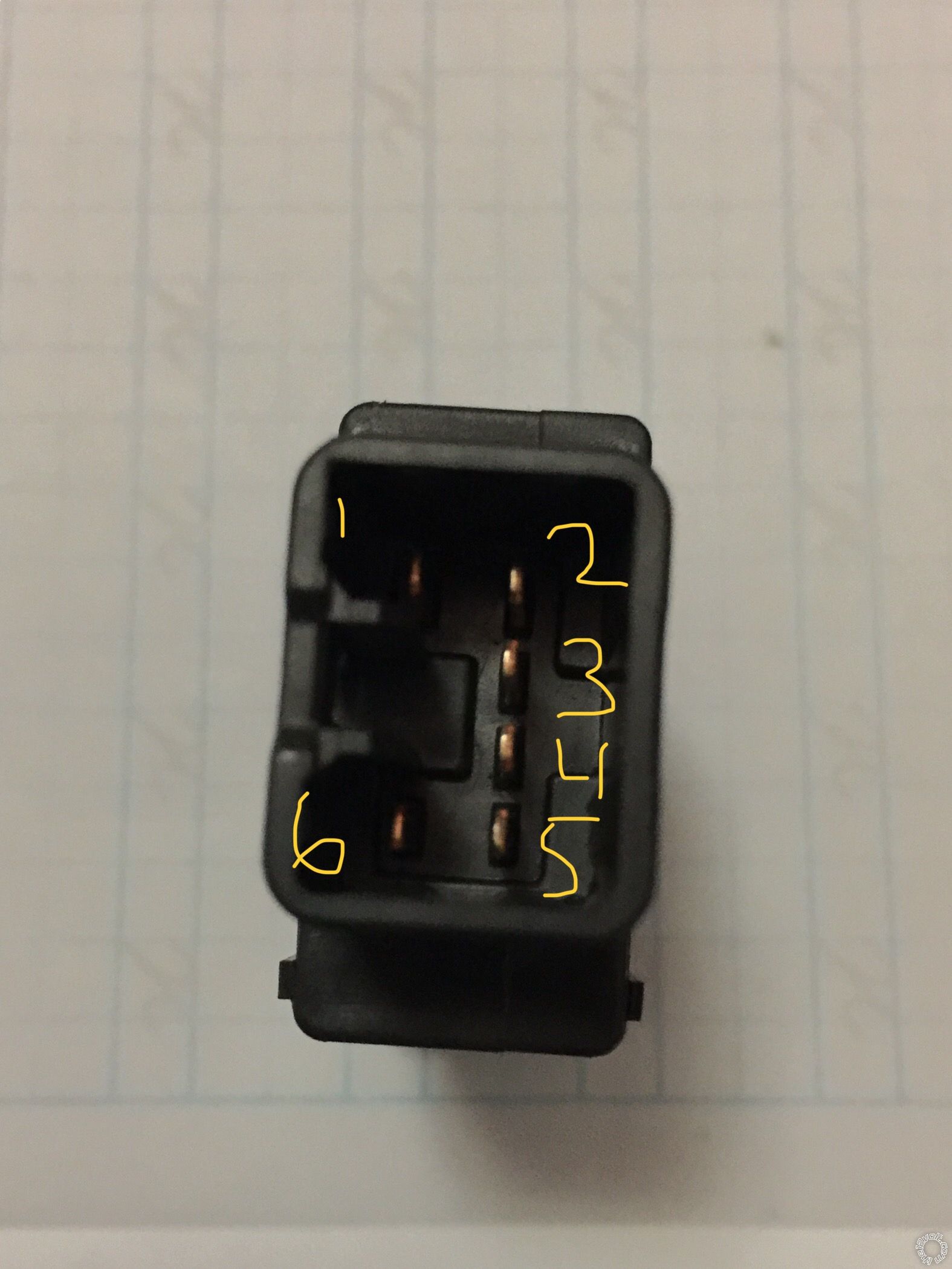

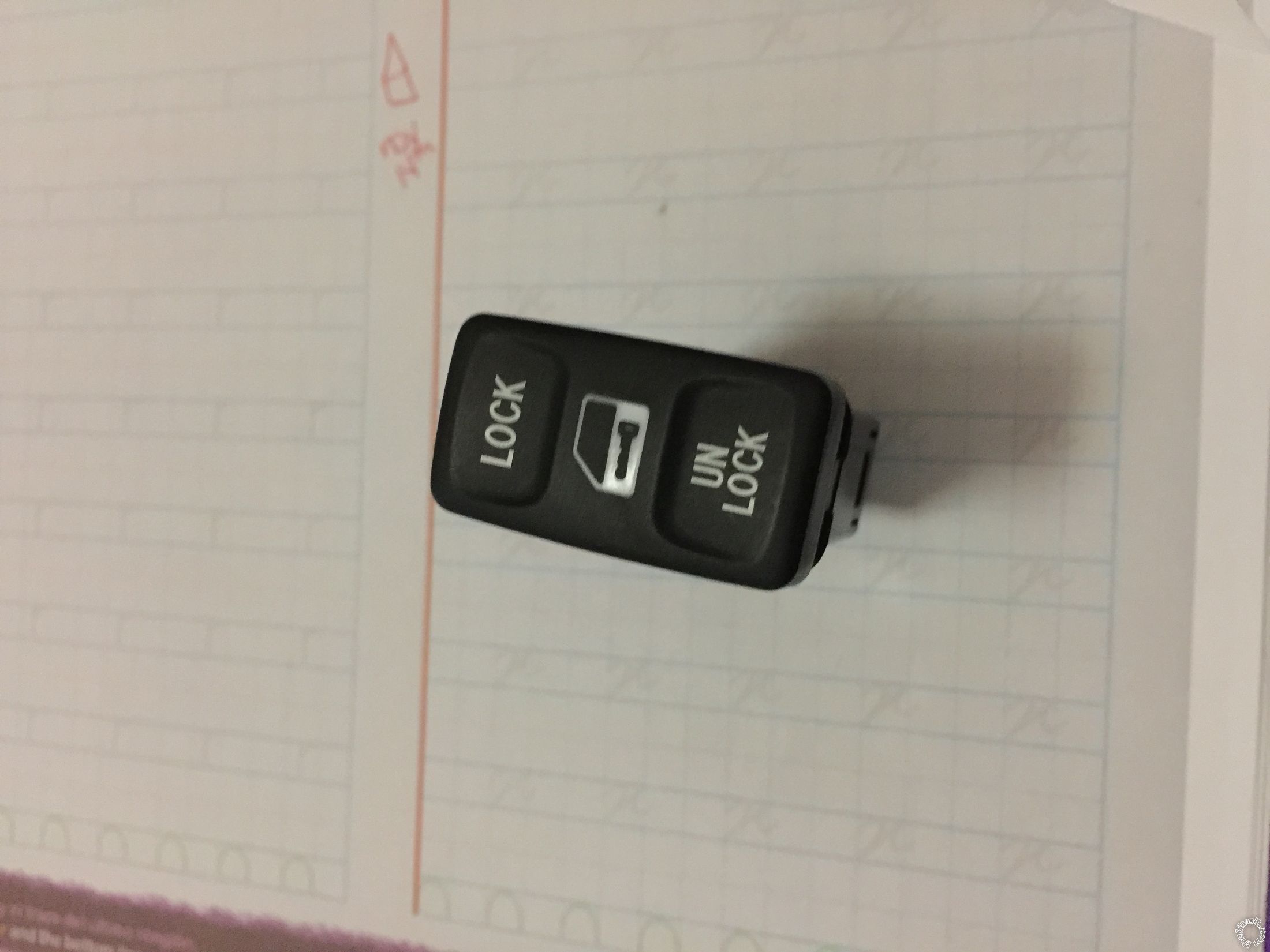

I purchased the original dash mounted door lock/unlock switch from my Toyota dealer and want to add it to the Viper 211HV so that it works in tandem with the remotes. I have read a couple of post regarding adding a DPDT switch (https://www.the12volt.com/installbay/forum_posts.asp?tid=142120 and https://www.the12volt.com/installbay/forum_posts.asp?tid=142157). My switch has 6 pins but I don’t know what type of switch I have. See pictures below.

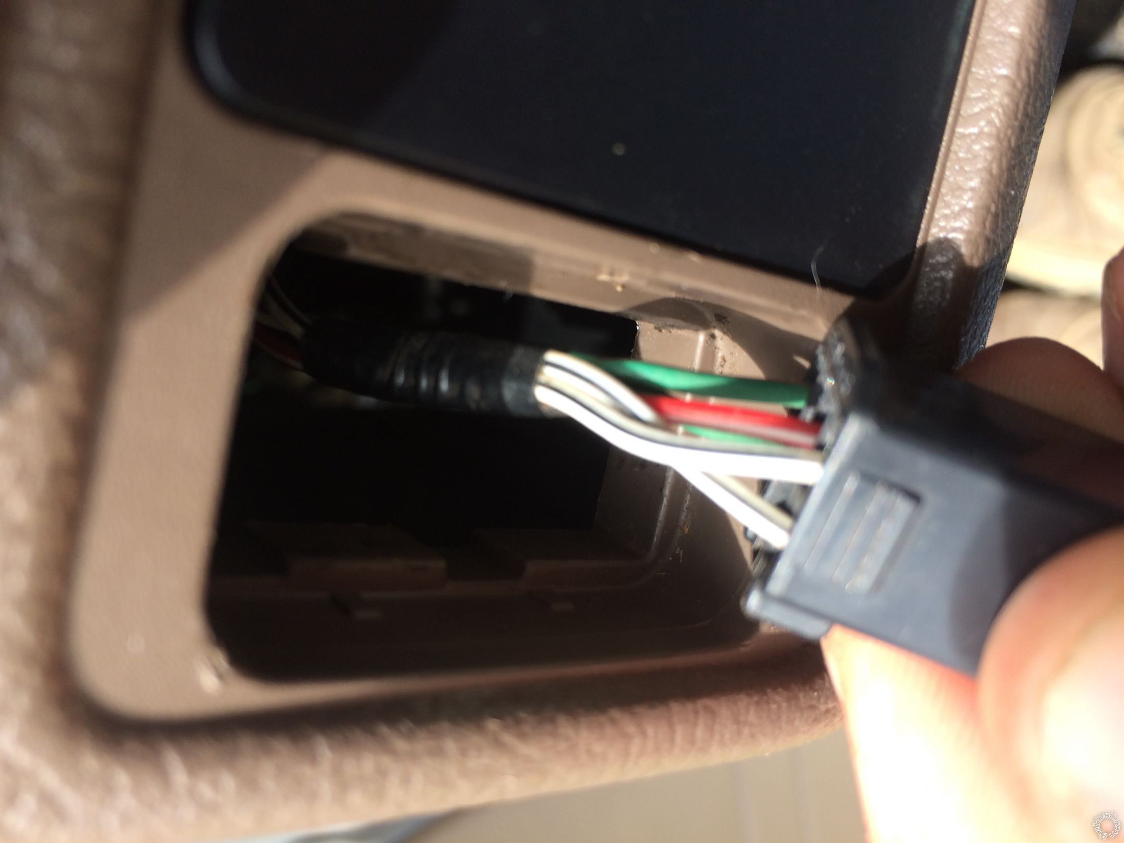

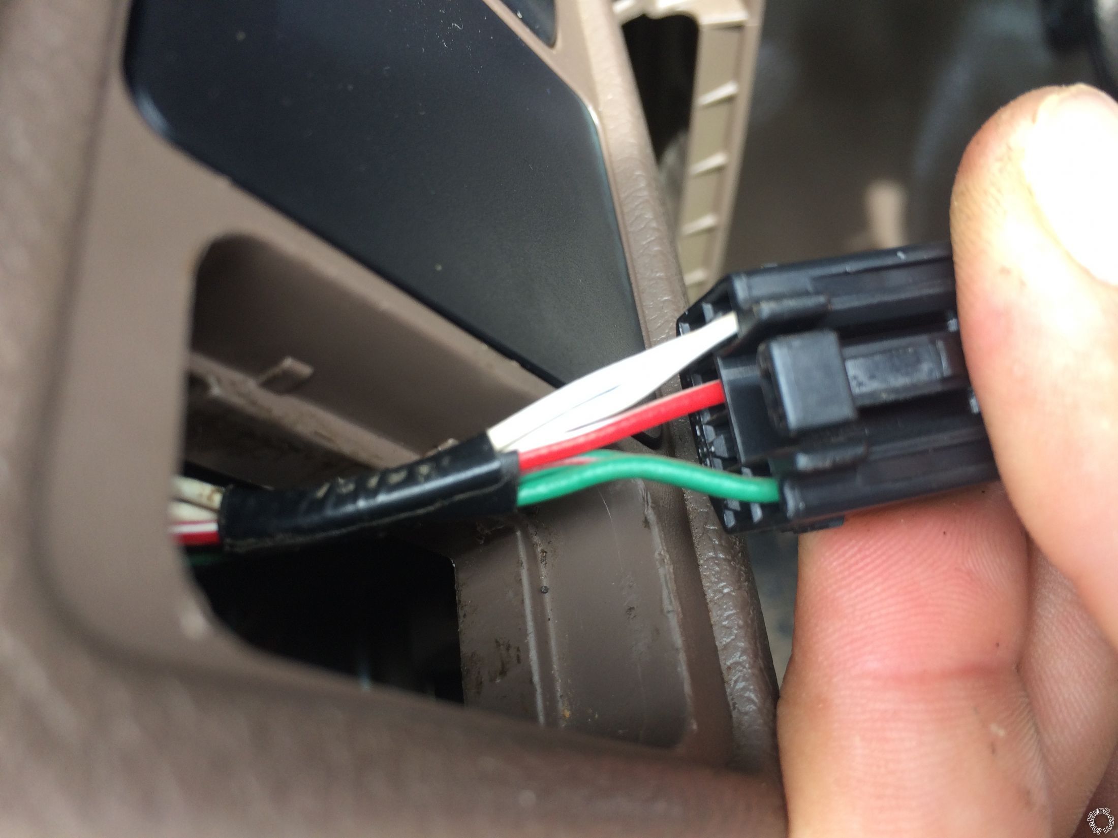

My friend has the exact same truck but his has a factory central locking system. I used a test light to test the wires connected to the switch and these are the results:
1     white/black stripe – ground
2     white/black stripe – ground
3     red/white stripe – unlocks when probe touches but does not light up probe
4     NO WIRE
5     green/red stripe - locks when probe touches but does not light up probe
6     green – dimmer/panel – probe lights up when lateral/head lights turned on
Is this a DPDT switch? Will I need relays as mentioned in the posts noted above?

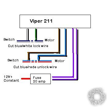

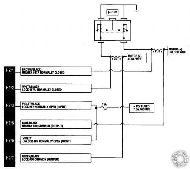

I also found these diagrams on previous post from the12volt.com forum.
Viper 211HV, Add Toyota OEM Door Switch -- posted image.
Or will it work if I connect it like the pictures; where the Viper 06-white/black stripe connects to the switch 05-green/red stripe and the Viper 17-brown/black stripe connects to the switch 03-red/white stripe? Do I need to add +12v to the factory switch? I need help on what wires I need to connect. I don’t want to burn the unit. Thank you.

I failed to post the Toyota OEM switch's continuity:
Pin 1 & Pin 6 - permanent continuity (for the switch's light)
Pin 2 & Pin 5 - continuity when pressing Lock
Pin 3 & Pin 4 - continuity when pressing Lock
Pin 2 & Pin 3 - continuity when pressing Unlock
Pin 4 & Pin 5 - continuity when pressing Unlock

After lots of research and learning about relays, I figured out that I needed two relays. Here is how it’s wired:
Lock Relay:
#30 to actuators wire that is LOCK
#87 = B+, Hot at all times. (Fused)
#87a = H1/5 - Green/Black wire Viper 211 HV
#86 = B+, Hot at all times. (Fused)
#85 = Pin 5 on OEM Toyota switch (LOCK trigger)
Unlock Relay:
#30 to actuators wire that is UNLOCK
#87a = H1/8 - Blue/Black wire Viper 211 HV
#85 = Pin 3 on OEM Toyota switch (UNLOCK trigger)
On the 211HV:
H1/5 Green/Black = #87a, LOCK relay.
H1/8 Blue/Black = #87a, UNLOCK relay.
Dash switch:
Pin 1 = Ground
Pin 2 = Ground
Pin 3 = #85 Unlock Relay
Pin 4 = Not Used
Pin 5 = #85 Lock Relay
Pin 6 = Panel Dimmer Lights
Circuit Description:
I connected the Viper Common Outputs (H1/8 Blue/Black to the Unlock relay & H1/5 Green/Black wire to the Lock relay) to #87a since it is a closed circuit when the relay is at rest. I connected the actuator wires to #30 which is a common and a fused hot wire to #87. Now the Viper unit is in a closed circuit (#87a & #30) when the relay is at rest, the unit will be allowed to send a positive (+) signal to the actuators when activated by the Viper remote and a negative (-) signal when at rest. I connected a fused hot wire to #86 and a switch output wire (which are both negative) to #85. When the OEM switch is pressed the negative signal on #85 and positive signal from #86 causes the relay’s internal switch to close the circuit for #87 & #30 and open the circuit for #87a & #30. Now #87 will only send a positive signal to #30 (actuators) while the OEM switch is pressed. When the OEM switch returns to its resting position, the relay’s internal switch will return to resting position as well; closing the circuit for the Viper unit/actuators and opening the circuit for the OEM switch/actuators.
