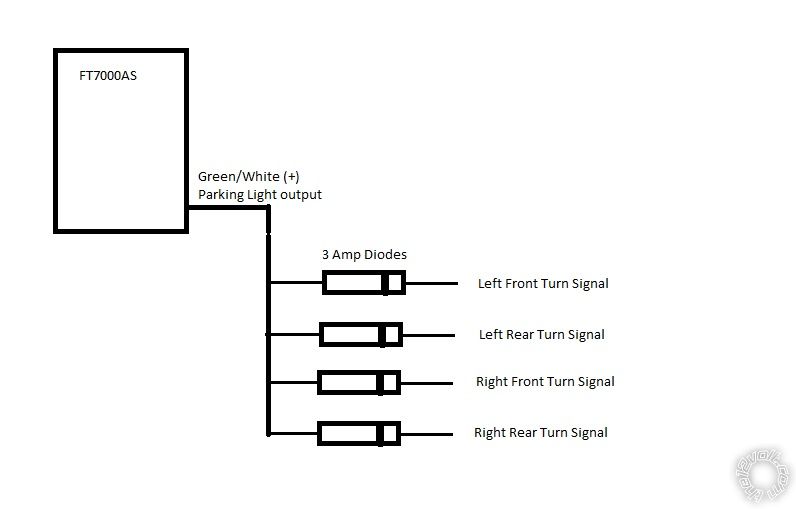

Also on this install, I would like to wire in the hazard/turn signals (same on this truck) to flash during arm/disarm/remote start just like factory lock unlock, rather than the parking lights. The wire for this according to Compustar, is the green high current wire from CN pin 7. Where is the best place to wire this in at…behind the hazard switch, or the main 12+ feeding into the relay from under hood fuse? And does anyone foresee a problem with using hazard/turn signal versus the parking lights?

Yeah, I wasn’t thinking clearly. But, yeah, if I wire in front of the relay it will flash during remoter start. I guess I was mainly thinking of the turn signals flashing while locking and unlocking my truck with the factory remote. Would there be another factory wire I could tap into to accomplish this without using the hazard switch wire?

It should be possible to use the Turn Signal lights. It would require a bit of extra testing and some
additional parts and wiring. Obtain four 3 Amp diodes. Test and locate these wires :
Turn Signal (Left)     yellow (F); yellow (R) (common on models w/o DRL) (+)    @ dash fuse box, wht 11 pin plg (1B), pin 7; wht 13 pin plg (1D), pin 11
Turn Signal (Right)    lt. blu (F); blu/wht (R)(common on models w/o DRL) (+)    @ dash fuse box, wht 11 pin plg (1B), pin 5; wht 13 pin plg (1D), pin 4
Use the diodes to isolate the connections ( bands towards the truck wires ) and the Compustars thick
Green/White Parking Light output wire to supply the needed (+) signal.
2015 Toyota Tacoma 4 Door Compustar Door Lock Wiring -- posted image.
