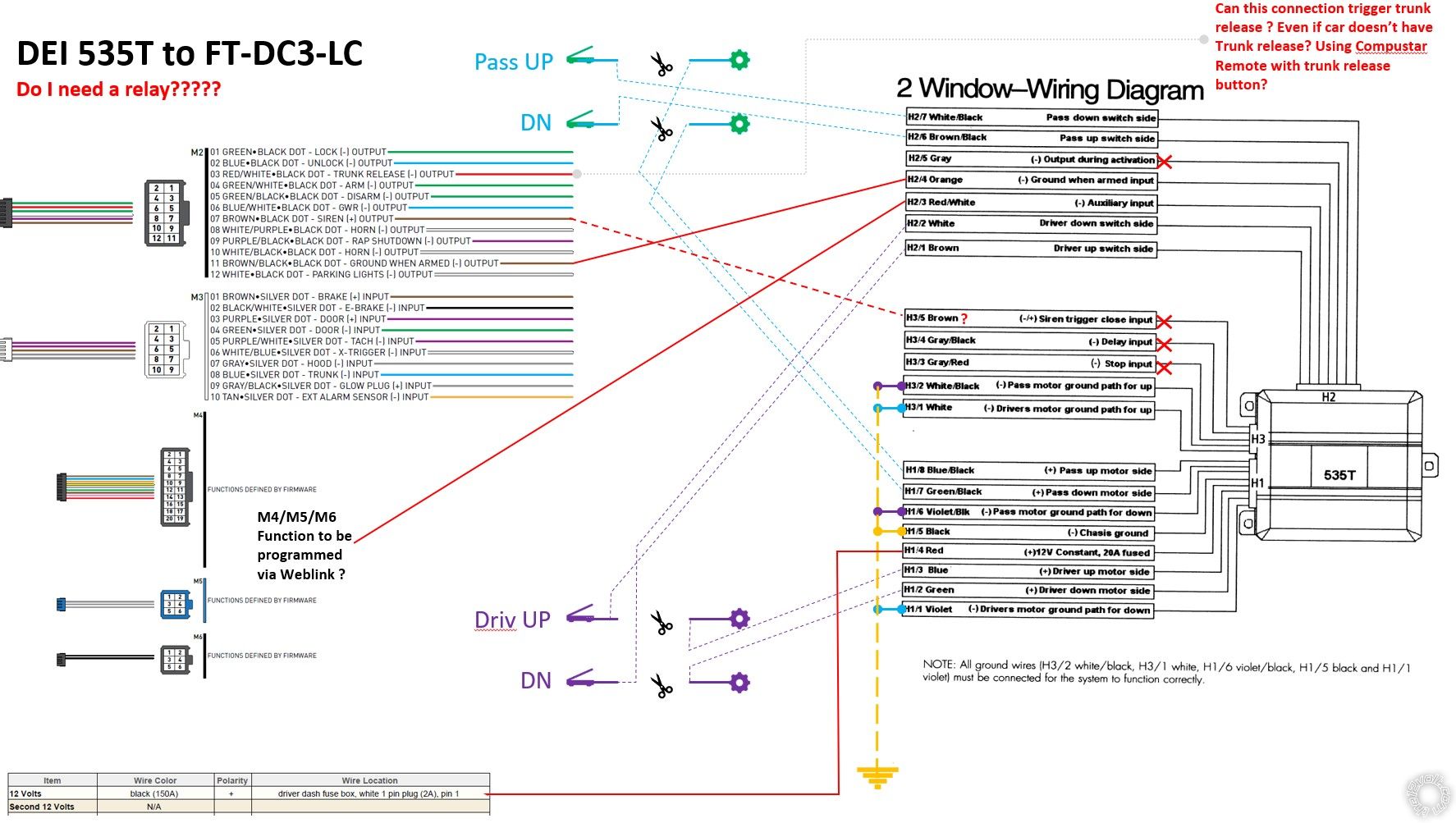

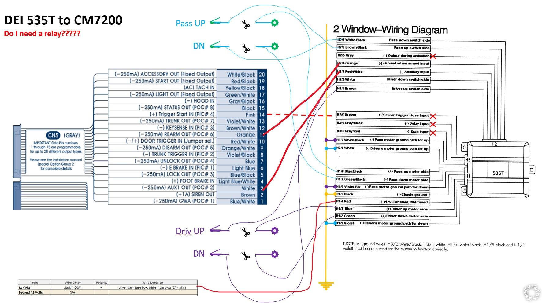

Below is a diagram of what I have figured out from my readings.. to connect the CM7200 to the DEI 535T
How do i know if i need a relay or not?
Do i need to connect the lines crossed out? or can i insulate and leave them not connected to anything?
2008-2015 Toyota Land Cruiser LC 200, Compustar Remote Starter -- posted image.
If i was to have the blade with the CM7200 then does all above remain same or do we have to connect anything to the 20 pin harness from the Blade?
The manual seems to have greyed out all wires not required to be connected..

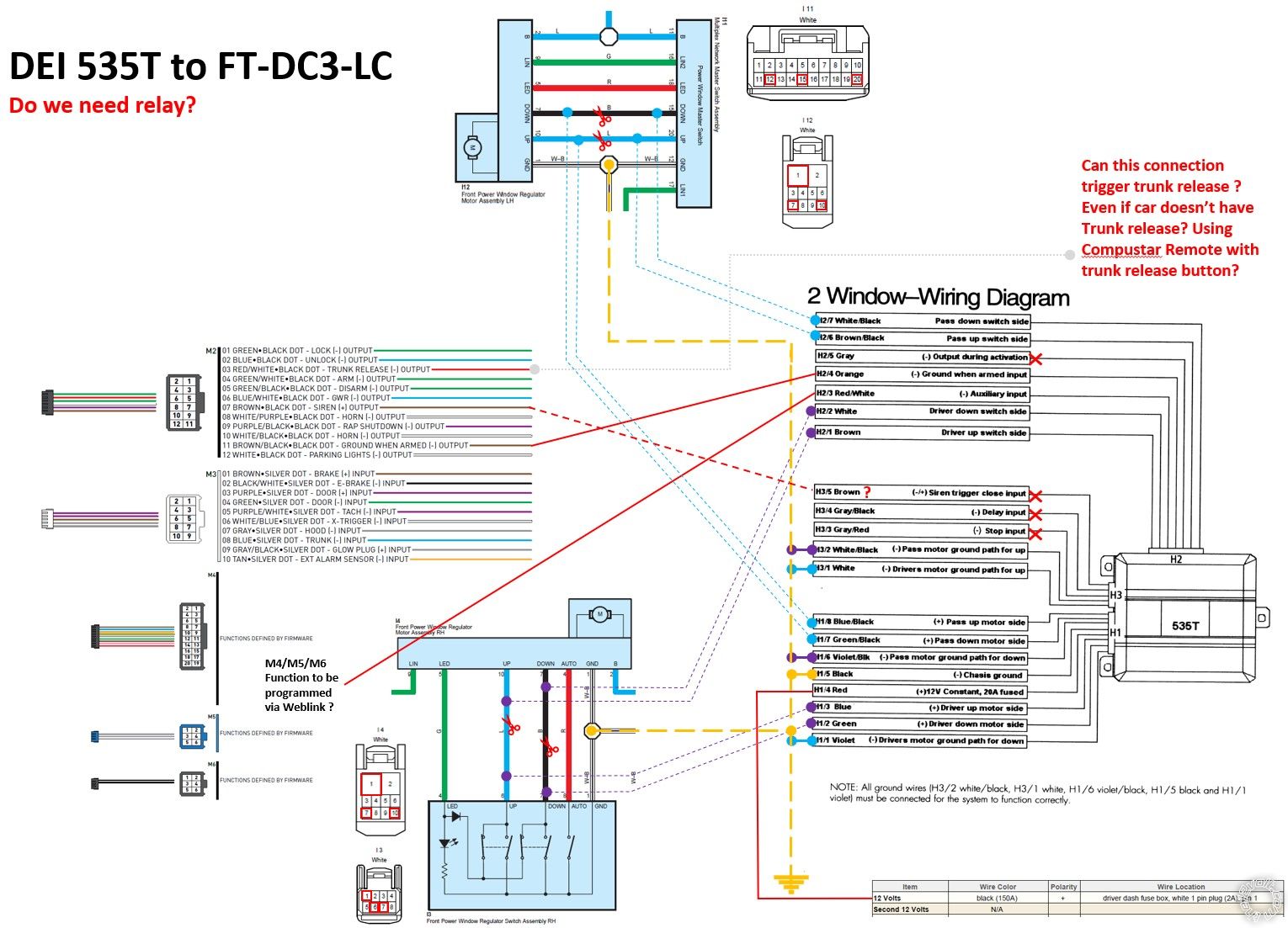

Posted: January 19, 2019 at 1:07 PM / IP Logged Link to Post Post Reply Quote illmas
And below is my understanding of how to wire the 535T to the FT-DC3-LC. for me this seems to be simpler but i have a few questions still to be answered ...
Does the LC200 window switched need relays to work with 535T?
CAn all connection be wired to the driverside window control unit only?
Do we need to do the lines crossed out in red?
Can we trigger trunk release output from the FT-DC3?
What functions are available for programming in auxiliaries? how would i achieve venting, ie partial opening?
Considering between CM7200 and FT-DC3-LC. If trunk release can be achieved from FT-DC3-LC. is there any other reason why i would need to go for the CM7200?
Br

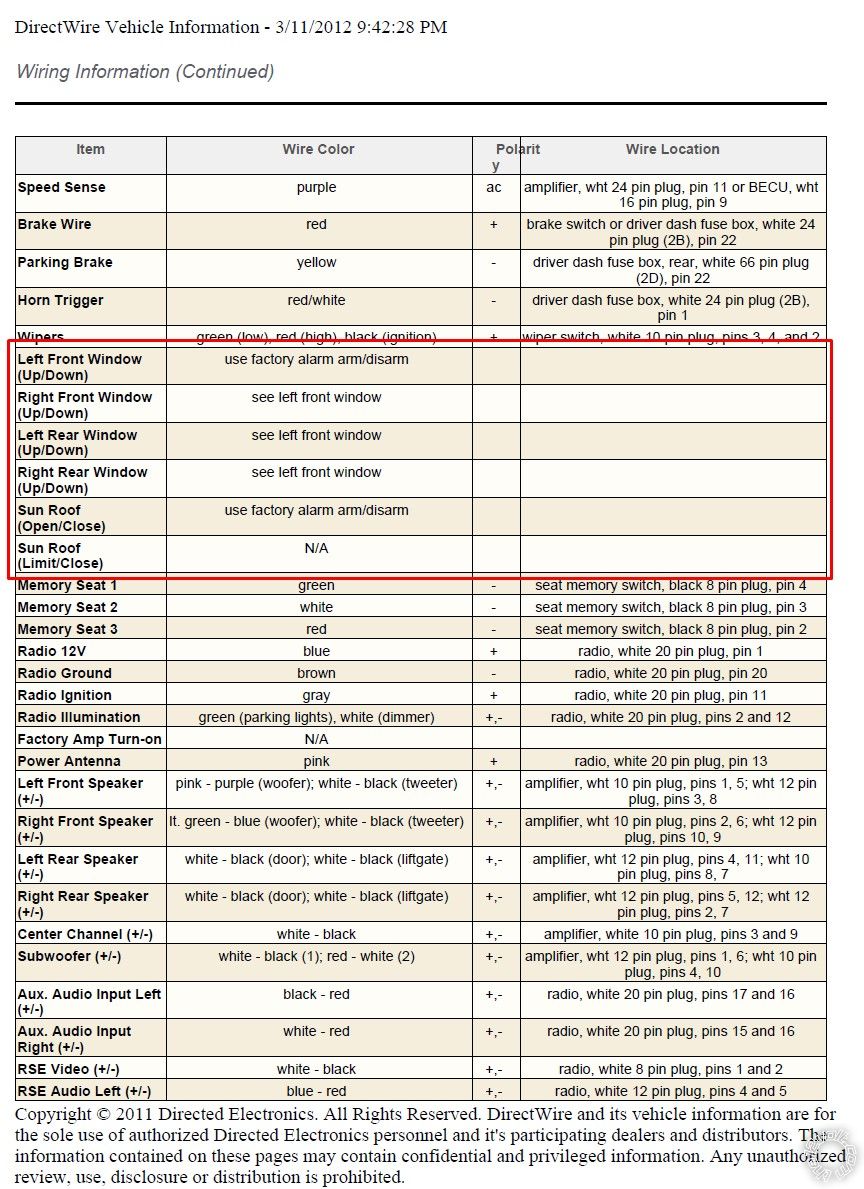

I am also trying to understand the below wiring info i downloaded from the12volt.com,
THe red box shows what clarity i am looking for in, appreciate if anyone can offer some clarity to what this means in context to what i want to achieve.

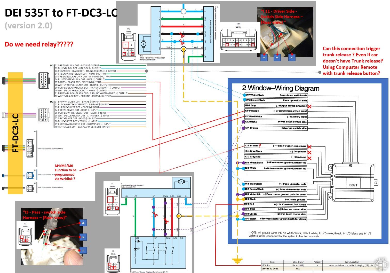

Posted: January 20, 2019 at 11:45 AM / IP Logged Link to Post Post Reply Quote illmas
Hmmm some progress on my understanding.
LC200 has a multiplex system and so this means that i will have to run the wires to doors where the switched and motors are and cannot have all the connections done at the multiplex. SO i have revised the diagram for connecting the DEI 535T to FT-DC3-LC.
Waiting or some expert to confirm i am going in the right direction and clarity on below:
1. Do we need a relay?
2. Do we need to do the lines crossed out in red?
3. Can we trigger trunk release output from the FT-DC3?
4. What functions are available for programming in auxiliaries? how would i achieve venting, ie partial opening?
5. Considering between CM7200 and FT-DC3-LC remote starters. If trunk release can be achieved from FT-DC3-LC. is there any other reason why i would need to go for the CM7200?

Posted: January 22, 2019 at 11:37 PM / IP Logged Link to Post Post Reply Quote illmas
More Progress on the understanding o the wiring and got pictures of the Doors side swich harness and identified the wires.
Still dont know if i need relays?   :(
