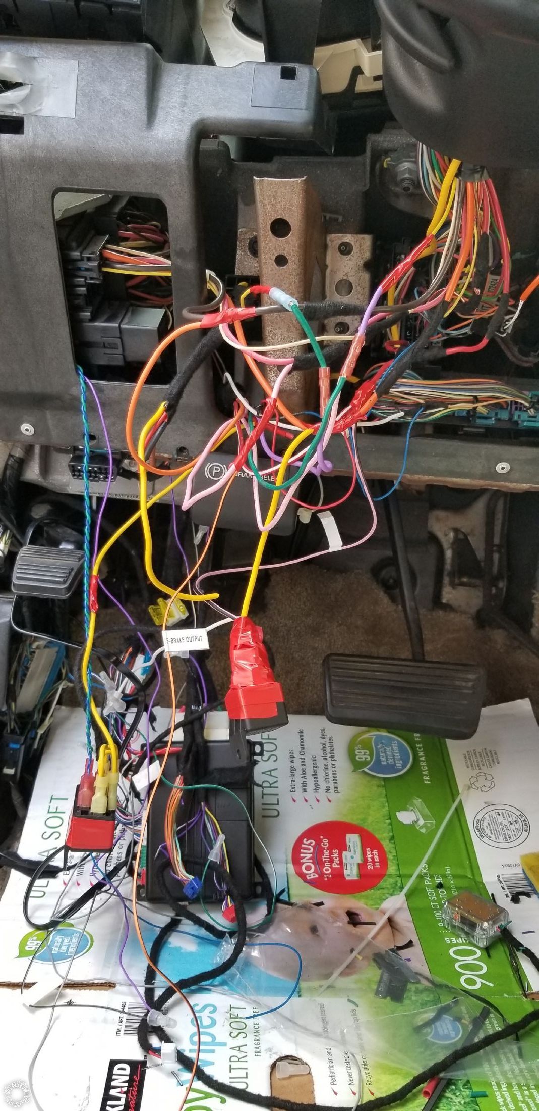

2001 chevy tahoe 5706 viper Db3 bypass module shop took over installation since I didnt get any feedback on my original thread regarding the wiring schematic I had laid out hoping to get sum feed back after this pic of what the shop did to my tahoe and get to fix it. Quick run down they eliminated the Db3 added 3 relays use tape and butchered my wiring after I had solder, shrink wrapped, and tesa tape my harness.

OMG. It's work like that that gives the 12 Volt industry a bad reputation.
First question. Does it work?
( the pre-question is why did you bring it to someone? I'm sorry you didn't get a reply from you original post.
   I don't use Directed products and after their recent purge, don't answer too many questions due to lack of
   current knowledge of their products. )
Even if your Tahoe has a Factory Alarm system, you really don't need a full featured bypass module like the
DB-ALLx series. Sure, they make things easier but a simple Passlock2 bypass module is all you need. And that
appears to be what the install shop did. They used the old school "Relay and Resistor" method to bypass the
Passlock2 during R/S. The other two relays are used convert the Vipers (-) Door Lock outputs to a (+) signal
that the Tahoe needs, one for Lock and the other for Unlock.
Don't know what to tell you. I would be very hesitant to bring it back to that shop. If it didn't work
properly, I would ask for a refund. If it works properly, I'd be tempted to clean up the install, getting
rid of the crimp connectors, soldering and heat shrinking everything, etc, making it neat and call it a day.
Remember that the removed curved metal plate has some unfinished edges on it, so make sure the harnesses are
well protected in that area.

I already had wired up using solder, heat shrink, and Tesa tape all that needed was the programming according to the flashes from the module it wasnt communicating and after reading that this modules dont take on the first try I assumed it needed to be reflashed with the proper software called around only shop that would reprogram it for me.
It locks and unlocks but it doesn't start the tahoe, cranks but doesnt engage. Relays have no resistors from what I see and no they was not payed since they decided to do that work without contacting me and advance they butchered wires that were solder and they left wires without no protection (bare wires).

Check the instrument cluster to see if the "Security" light is on during R/S cranking.
That would indicate that the Passlock2 is not being bypassed and preventing fuel from
getting to the engine.
Platinum - Posts: 7,827
Posted: February 17, 2019 at 6:18 PM / IP Logged Link to Post Post Reply Quote kreg357
Can't see the wires all that well, but it looks like the Yellow Passlock2 wire has something
connected to it. Guess that the 3rd relay was for the Brown ACC2 wire. If that's the case,
you will need a bypass module for the Passlock2 being as the DB-ALL3 is removed. If you
trust the Viper alarm system to protect the Tahoe, you could do a permanent bypass on the
Passlock2 or get a Fortin Passlock SL2 or a Directed 556 LW bypass module.

When I use the key it starts up fine when I use the rs it just cranks three times and then everything and the cluster goes dark (no lights).

Any "Security" light on the instrument cluster during R/S crank attempts?

Seems that they connected the orange from Rs to my brown ignition harness the black/white rap off to my passlock and no it doesnt show security it does show my battery when I start using the Rs.
