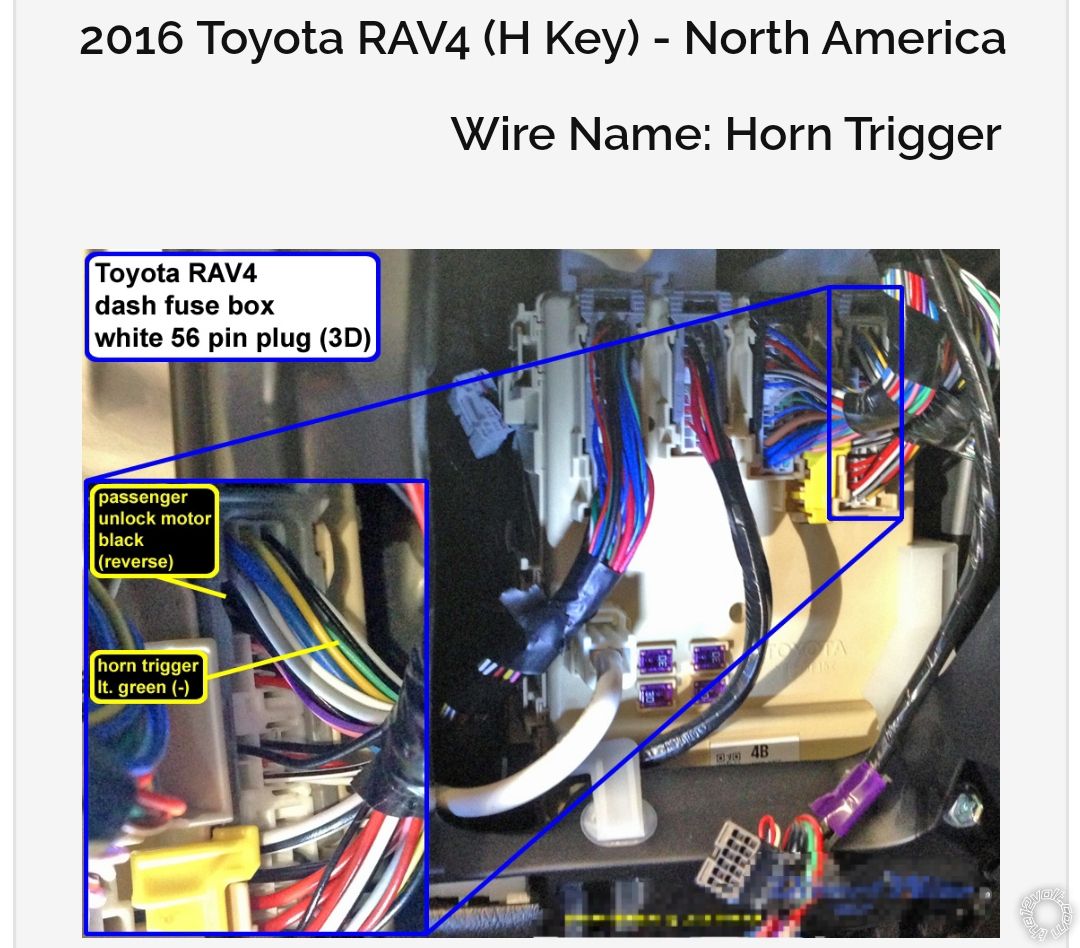

I was thinking to use the factory alarm disarm on the horn wire I think it will work cause that wire will pulse negative signal before the car starts up ,what you guys think thanks
guerra_85
Joined: April 28, 2016
Posted: February 15, 2019 at 12:12 AM / IP Logged Link to Post Post Reply Quote guerra_85
Horn Honk, Avital 4105, 2016 Toyota Rav4 -- posted image.

Posted: February 15, 2019 at 10:05 PM / IP Logged Link to Post Post Reply Quote iskidoo
Should work. I’d use some alligator clips to temporarily connect the relay to insure it behaves the way you want it to before connecting it all up for good. Seems like you are on the right track.
