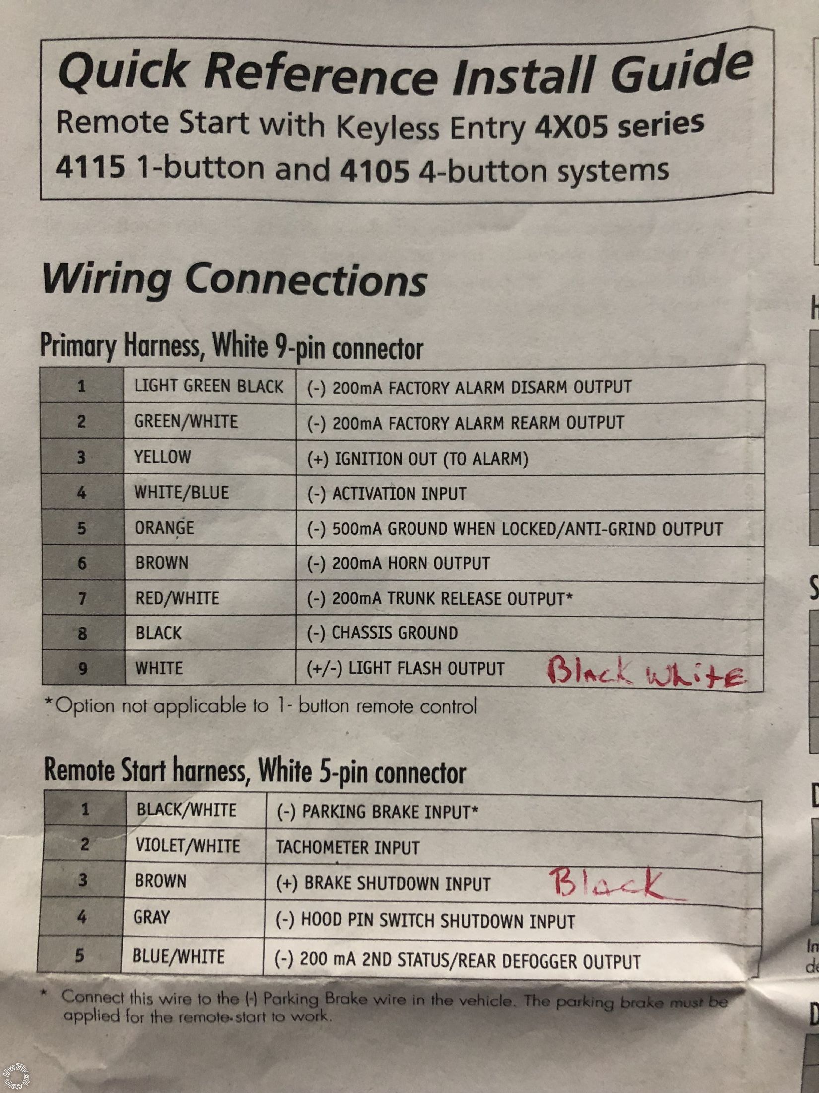

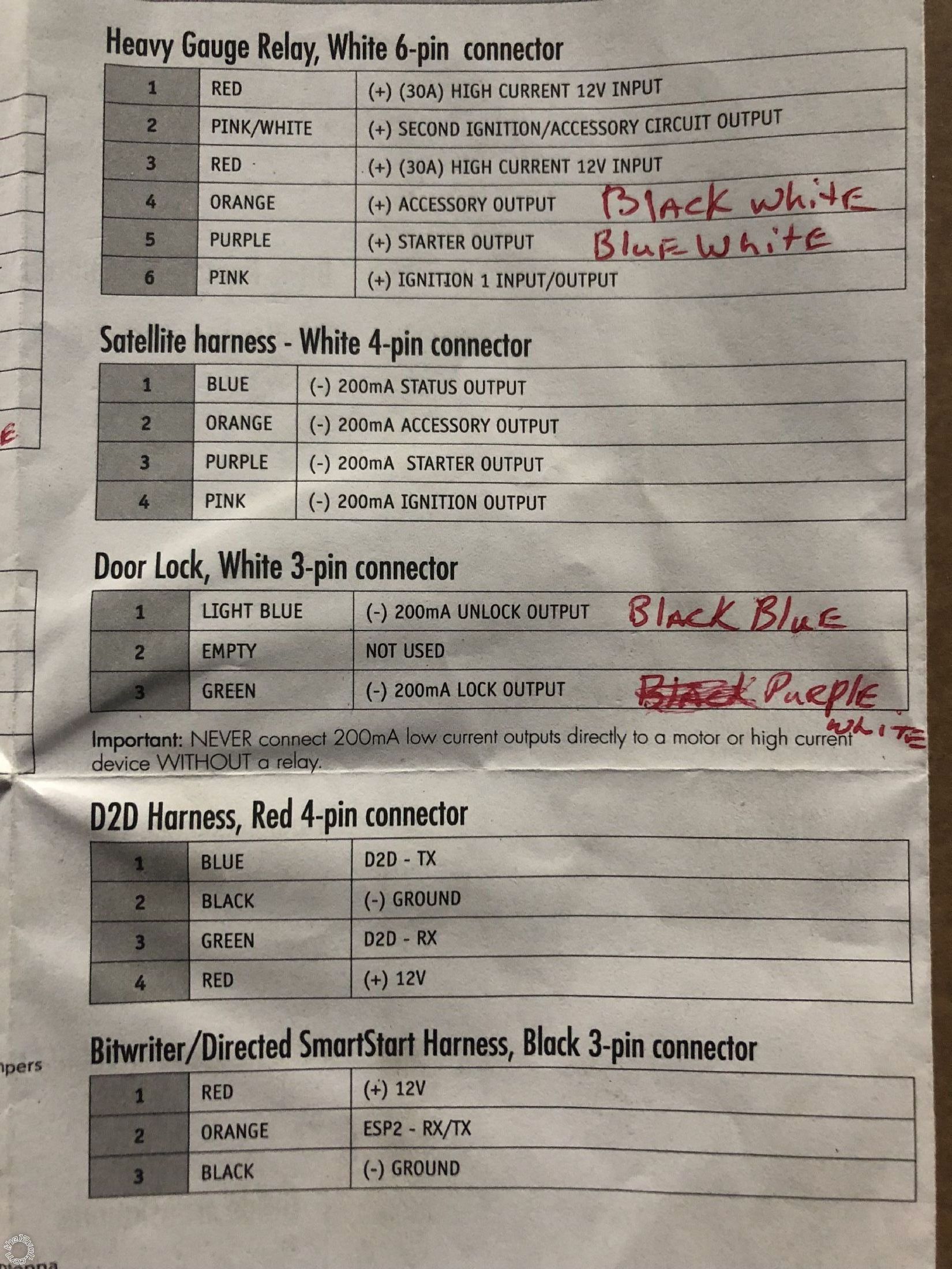

ADS-TB was flashed for my application. (I programmed with 2 keys) However I don't have the special cable to program the ADS-TB.I am not sure which wire from the unit is (-) Status Output. I appreciate the assistance.
2009 Ford F-150, Python 4105P, ADS-TB FM2 -- posted image.2009 Ford F-150, Python 4105P, ADS-TB FM2 -- posted image.
Platinum - Posts: 7,828
Posted: February 13, 2019 at 7:08 PM / IP Logged Link to Post Post Reply Quote kreg357
White 4 Pin Satellite Harness
Pin 1 Blue wire (-) Status Output.
Did you set the ADS TB to Installation Mode = Standard prior to doing the vehicle 2 key programming?
