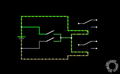

Hello, I need to take a single wire and have it activate one of two different relays depending on polarity. For example a negative pulse would energise relay 1, a positive pulse would activate relay 2. Pulses would always be separate.
It is part of a larger circuit, but the rest I am confident with and I'm trying to keep this simple in the hope of some advice. The issue that I cannot overcome is how to connect the two relays without them bypassing the switch. Some variation of diodes may work but I am not sure. A quick diagram below, 12V automotive application.

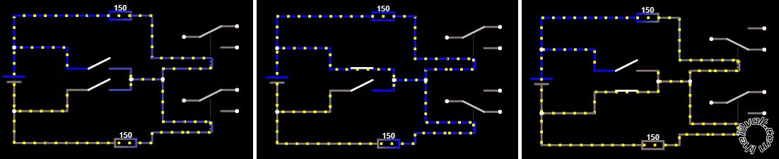

Suggested elsewhere was the use of two resistors at half the activation current of the relays. So current through both wouldn't be sufficient to activate, but one would. As drawn out below in it's three states. If done properly would this be reliable and consistent long term, without large current draw / burning out contacts etc?
