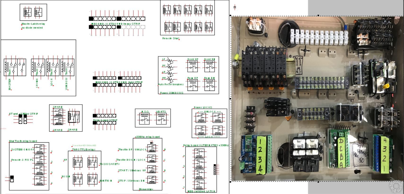

Hello all, I figured out a work around with my hardware.
Thanks anyway for the help.
I am running 11 channels from my original 8, that frees up buttons for separate inputs.
    __________________________________________
____BT phone____ |      ___remote control___        ___SLAVE board__
[BOARD of 4    ] |      [    BOARD of 4    ]        [GANG/BANK of 4]
[1 NO or NC   ]-/       [1 MOMENTARY NO/NC ] - - - > [    ganged    ]1A or 1B \
[2 open channel]        [2 MOMENTARY NO/NC ] - - - > [    ganged    ]2A or 2B \\__\ Forwards remote board 1-4 to A or B based on BT 1 setting.
[3 open channel]        [3 MOMENTARY NO/NC ] - - - > [    ganged    ]3A or 3B // /
[4 open channel]        [4 MOMENTARY NO/NC ] - - - > [    ganged    ]4A or 4B/
3 channels8 channels
They are ganged as;           Throttle UP, DOWN, Engine START, STOP (carburetor needs to be pumped and fast idle)
     then when switched it is Locks UNLOCK, LOCK, Windows UP, DOWN Reverse Polarity Every Time From Single Input -- posted image.

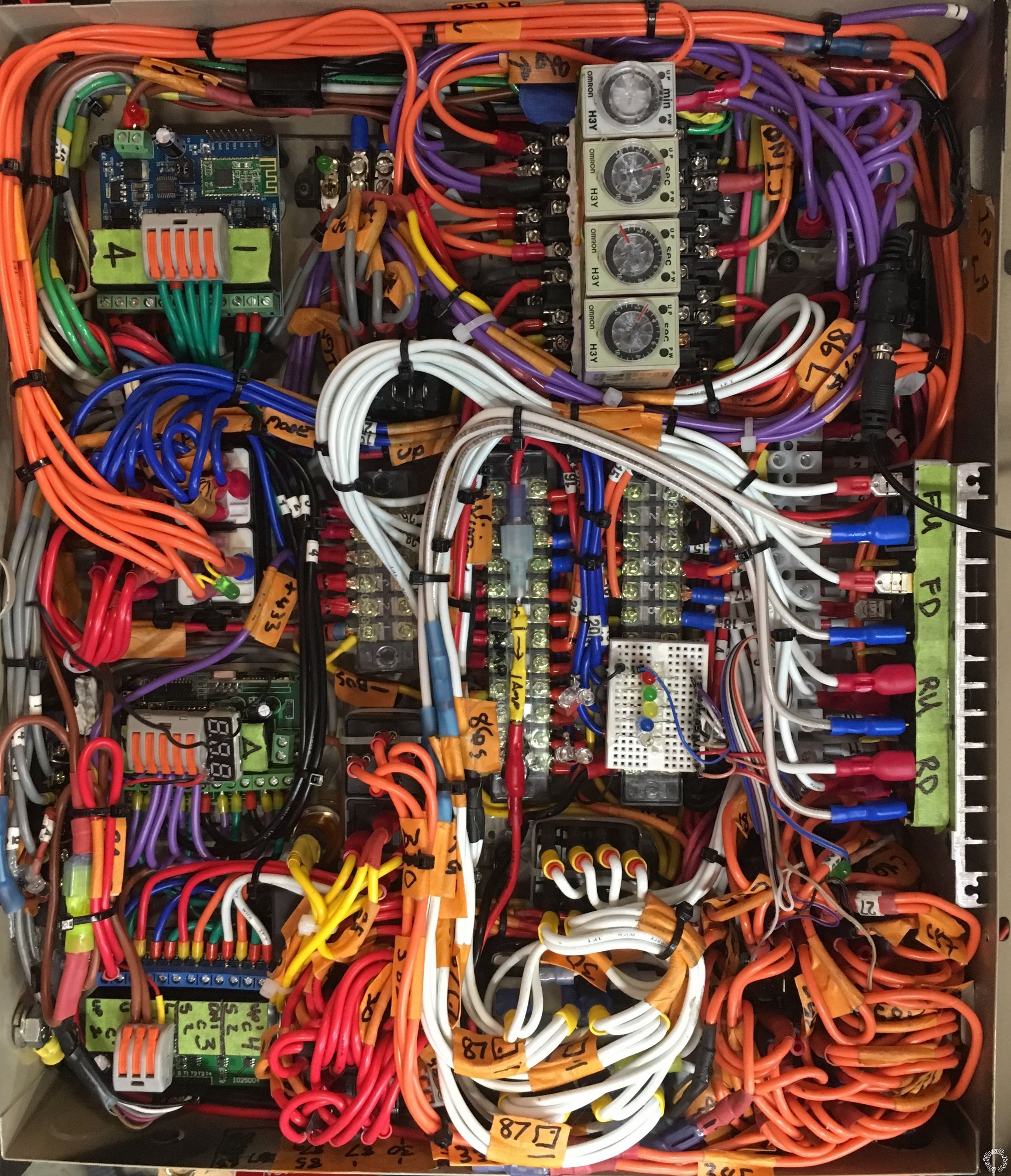

Posted: July 23, 2019 at 9:57 AM / IP Logged Link to Post Post Reply Quote landmaster1
If anyone cares I ended up using a digital FlipFlop Relay.
Here is the nearly finished panel.Reverse Polarity Every Time From Single Input -- posted image.
