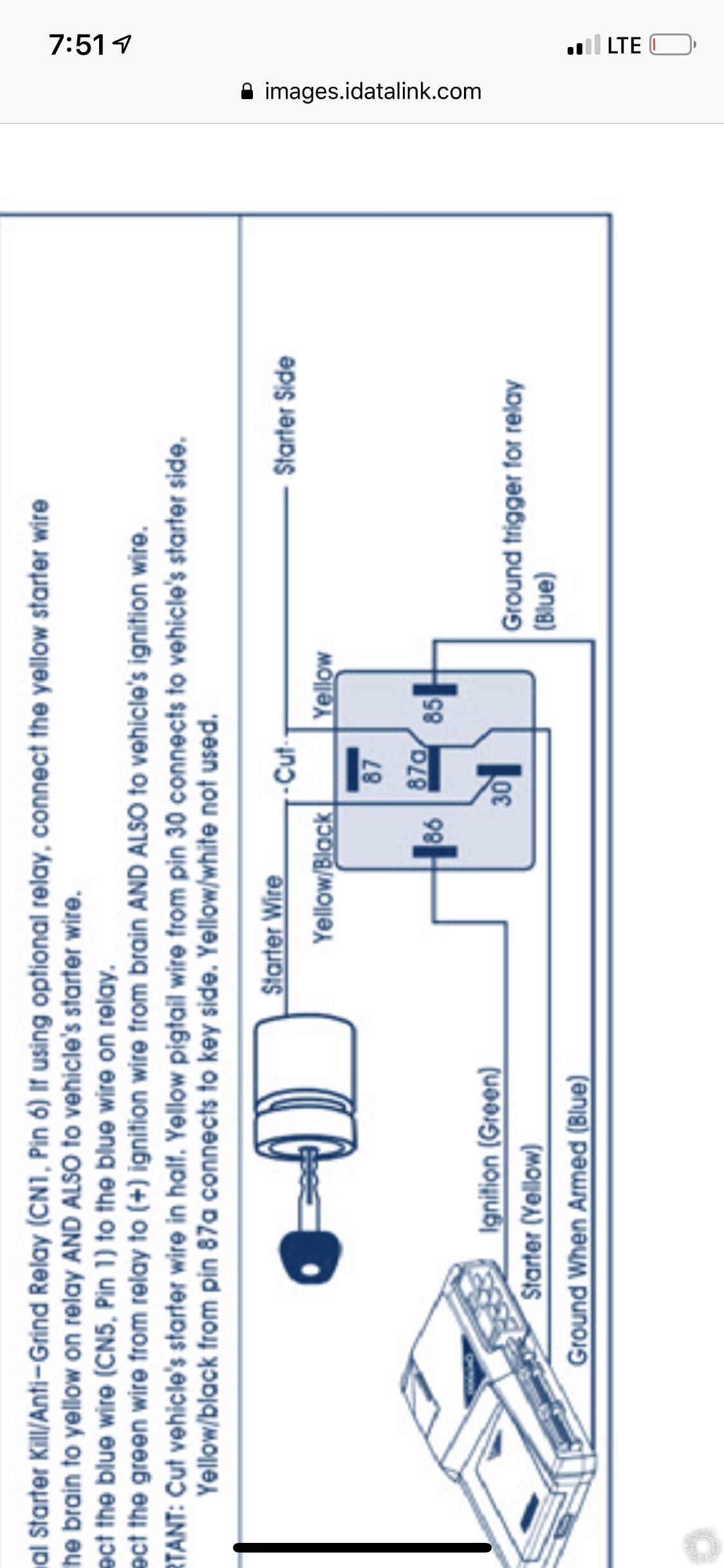

whitleyca
Member - Posts: 6
Joined: July 30, 2019
Posted: August 23, 2019 at 11:55 PM / IP Logged Link to Post Post Reply Quote whitleyca
1991 Toyota 4Runner, 5 Speed, Remote Start Issues -- posted image.
Okay, so I found out I have a negative triggered clutch switch. How can I integrate it into the relay in the picture I attached? I tried the diagrams provided, but it doesn’t run to ground, and I need the current figuration to get the vehicle to start.
