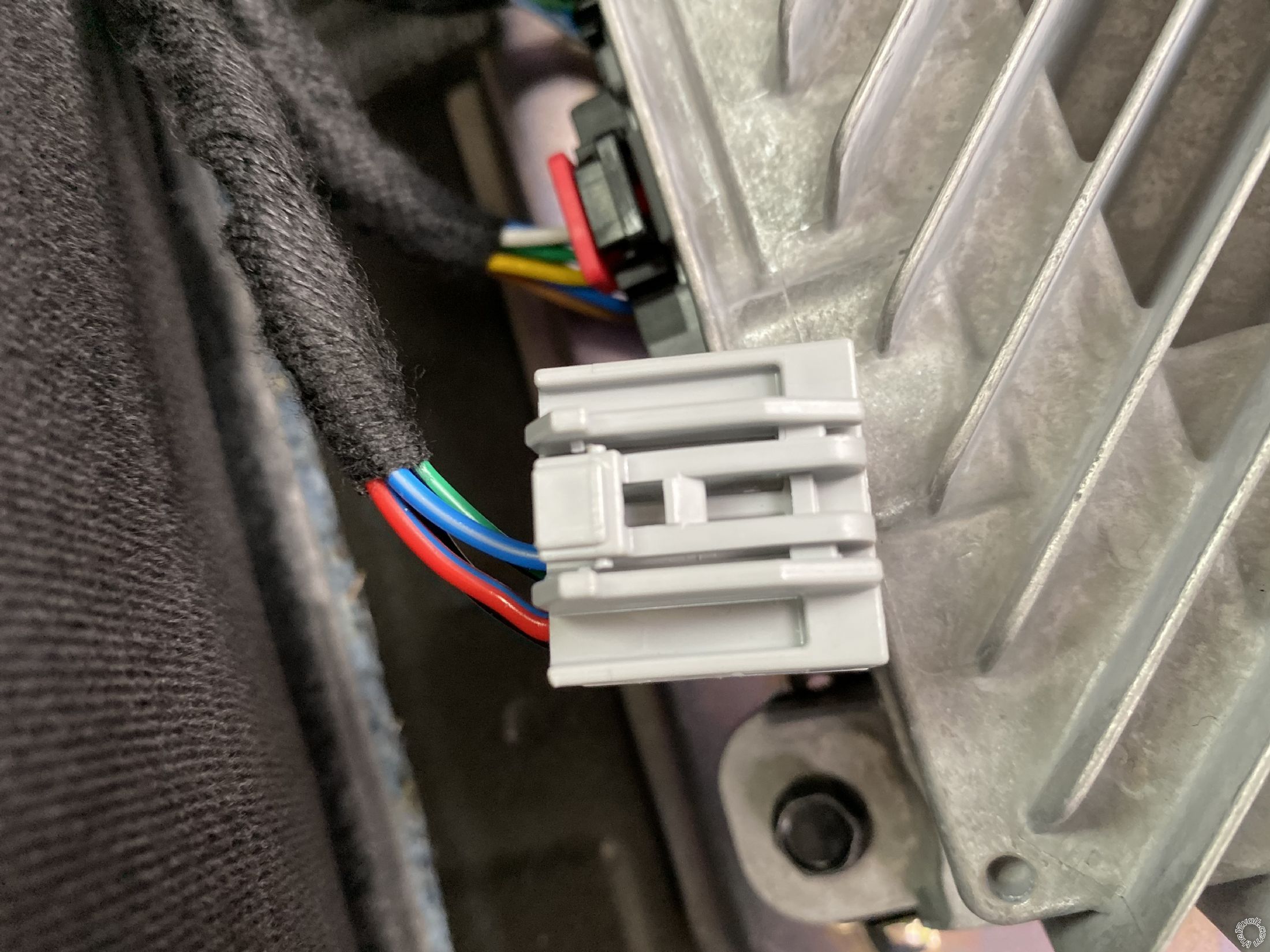

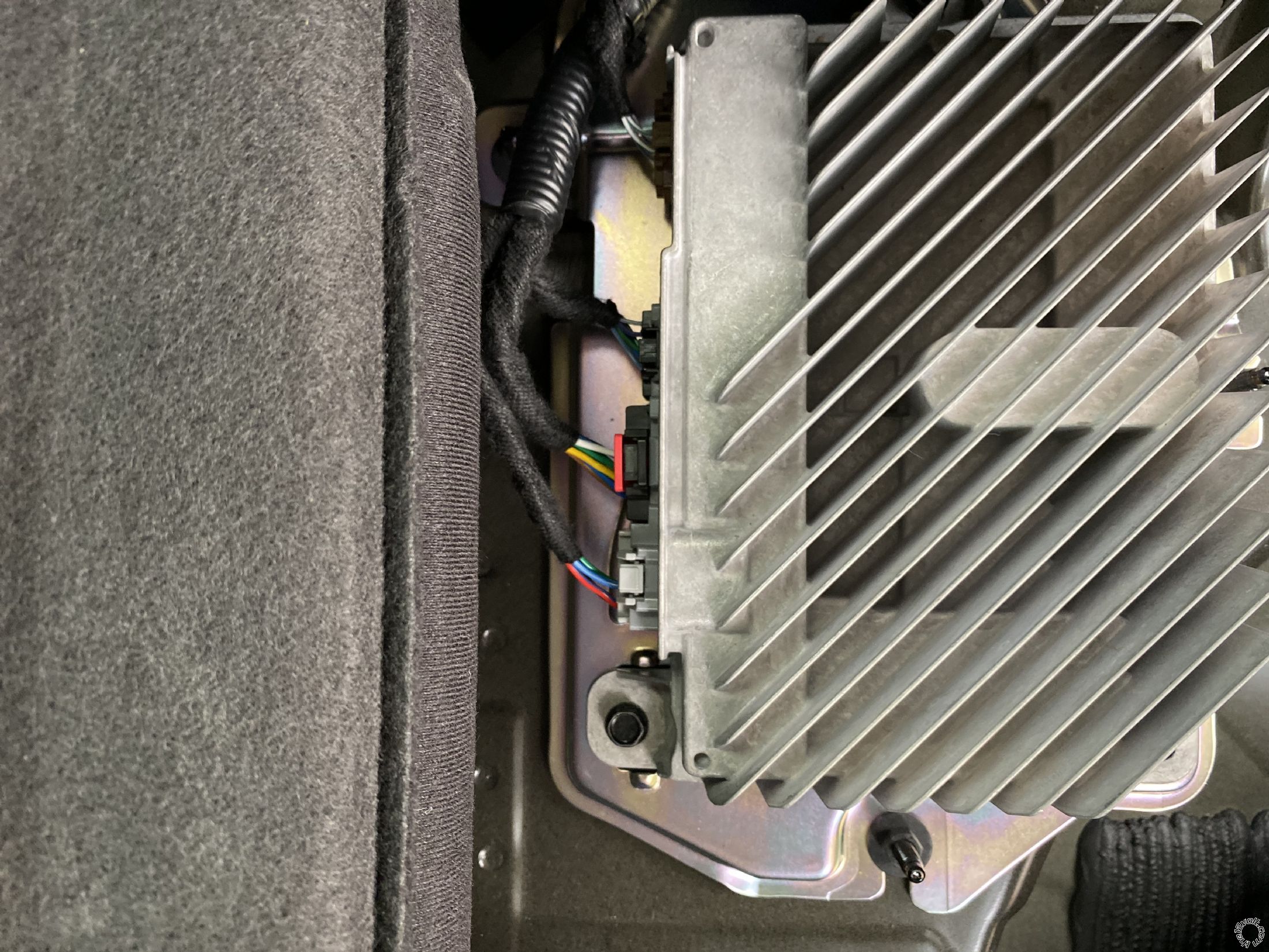

Take a picture of the plugs at the amplifier. Post them here.

Take a picture of the plugs on your amplifier and post them. I can probably help you with the ANC if I see the photos.
Catch the subwoofer wires. The door speakers are crossed over. The only place to get low frequency is from the sub wires.

2019 Buick Encore Preferred, Speaker Wires -- posted image.
I posted some pics, sorry for the huge size. I have more close ups of the plugs but didn't want to clutter the post with too many huge pics. Let me know of you need the others close up.
This vehicle has the ANC "frisbee" on the spare tire if that helps at all. It is not a Bose system, but looks like it has the Bose amp and the Bose ANC but I am not sure. There is very little info out there on an Encore. Not many people adding bass LOL
Platinum - Posts: 13,726
Posted: October 03, 2019 at 2:50 PM / IP Logged Link to Post Post Reply Quote i am an idiot
That is not the amplifier I am familiar with. I know it is not a Terrain, nor is it the same vehicle, but the following video may help you. Should be similar.
