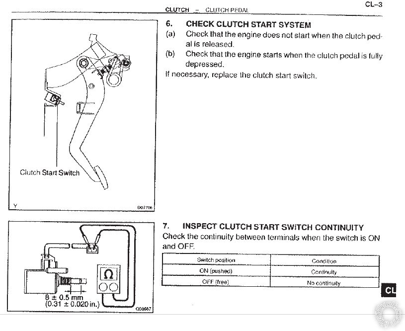

How is your relay wired?
2000 Toyota Celica, Manual Transmission, Clutch Wire -- posted image.
