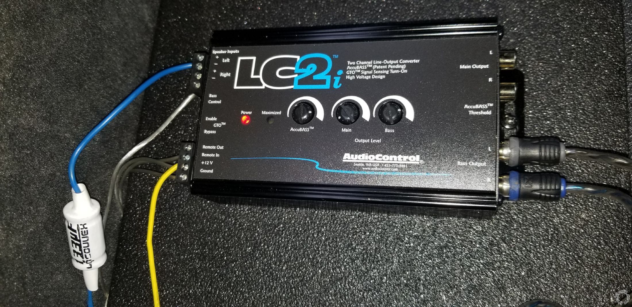

Just dealt with this in my buddies mega cab. We went the route of depinning and he hated the noise cancellation being totally disconnected. Too much road noise. So I hooked mics back up and installed a bass blocker before the lc2i. No more noise cancellation tones in the sub and the lc2i replaces the missing bass. 2014 Chevrolet Impala, Subwoofer Install, Noise Cancellation Issue -- posted image.

Installing the bass blockers before the LOC didn’t block the bass notes going to the LOC? I feel like it would...

Bass blockers depend on the impedance of the speaker to work. Same bass blocker, 2 different crossover frequencies 4 ohm vs. 8 ohm. The input impedance of the LC2 is probably 1,000 ohms.

Honestly man I was shocked it worked, I figured poweres subwoofer wire it was 2 or 4ohm. I bridged one if the pair of wires instead of running both sets to lc2, i had to do the same on a vette because there was too much signal. I found this way just works and sounds good. I also figured the lc2 might add back the missing bass with the bass blocker. Like i said it was a shot in the dark and my buddy is happy. And i feel ya i charged him $150 and spent like 16 hours on his truck. This kinda doodie makes me not even wanna fw the new stuff anymore. Miss the good ole days.
