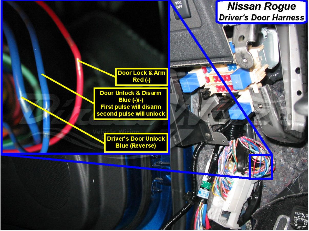

use the factory arm / disarm in the door boot. remove the 10mm bolt holding the "massive harness" in the drivers kick (same place where you got park lights / brake).. and pull out the door harness going into the drivers door. Slice it open, and use red (arm), and blue for disarm
2010 Nissan Rogue, Viper 4806V and EVO All Bypass -- posted image.

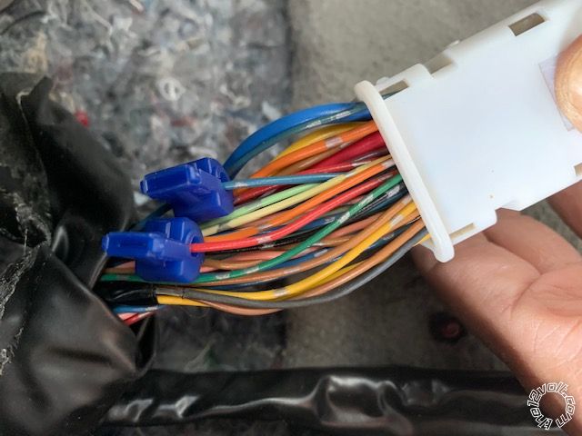

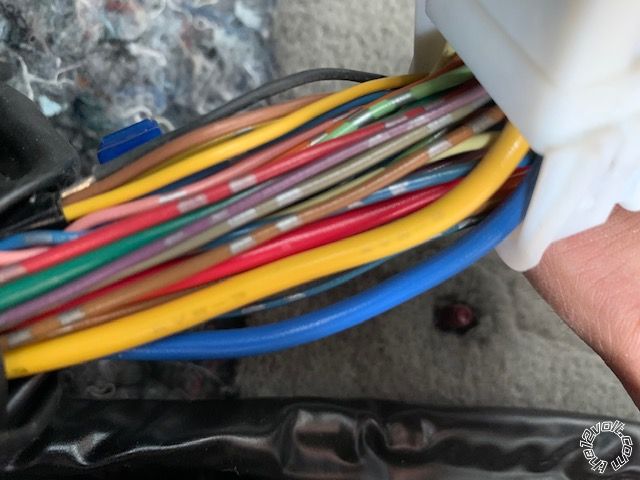

buddyle2002
Member - Posts: 39
Joined: December 04, 2005
Posted: March 07, 2020 at 5:32 PM / IP Logged Link to Post Post Reply Quote buddyle2002
I can't seem to find the right wires, I see multiple red and blue as you can see the picture attached. Unsure which one are the right one to connect.
2010 Nissan Rogue, Viper 4806V and EVO All Bypass -- posted image. 2010 Nissan Rogue, Viper 4806V and EVO All Bypass -- posted image.
djdeito
Copper - Posts: 100
Joined: February 19, 2019
Posted: March 07, 2020 at 7:14 PM / IP Logged Link to Post Post Reply Quote djdeito
Have you checked in the location suggested by "silvercivicsir"?
