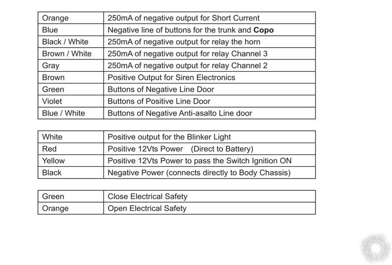

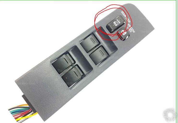

i located the lock/unlock wires as you said using the multi meter when i tried to connect them nothing happened but i didn't used any diodes it was a little bit confusing because some people worked out for them with direct connection to lock/unlock wires some got lucky with the wires before the central door control unit , but i had no luck anyway
last try was to connect the wires to the main lock/unlock switch i hacked the rear cover the button has 3 wires 3.2.1 if i want to lock it 1 and 2 will contact so the car locks to unlock it 2 and 3 will connect to each other so it opens , there were my problem what to do about the 3rd wire or how to connect it , some people worked out for them with direct connection to lock/unlock wires some got lucky with the wires before the central door control unit , but i had no luck anyway

It might be easier to use relays controlled by the aftermarket RKE system to duplicate what the central locking switch does.
You would need two 30/40 Amp SPDT relays and the 5 wire harness.
Lock Relay :
Relay Pin 85 to RKE (-) Lock output
Relay Pin 86 to +12V constant
Relay Pin 30 to central locking switch Pin 2
Relay Pin 87 to central locking switch Pin 1
Unlock Relay :
Relay Pin 85 to RKE (-) Unlock output
Relay Pin 87 to central locking switch Pin 3
All that is left is to figure out which two wires from the RKE system supply a (-) output with the remotes lock/unlock commands.
