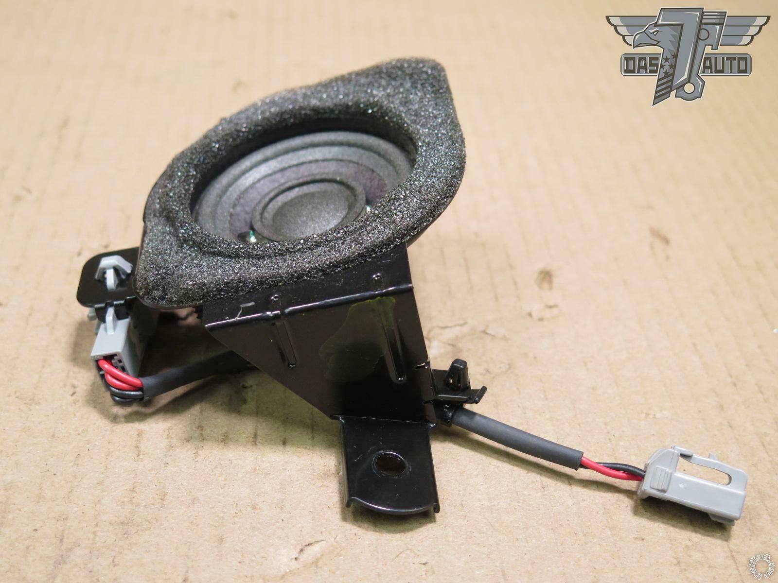

Posted: March 13, 2020 at 3:31 PM / IP Logged Link to Post Post Reply Quote siggie
I found a picture of the speaker and housing in case that can help someone answer my questions.
siggie
2002 Lexus SC430, 6.5 cm Midrange Speaker Driver -- posted image.

Posted: March 15, 2020 at 12:18 PM / IP Logged Link to Post Post Reply Quote siggie
Well, I removed the door panel and discovered that, although it sounded like the rattle was coming from the midrange, it was in fact coming from the 6x9 woofer, which has many possible replacements available.
