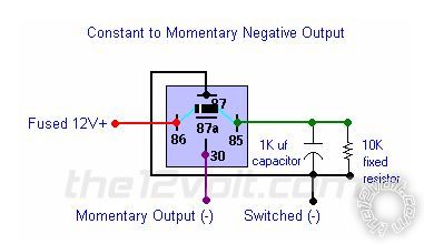

Here is another option that might work. You would need some parts to try it.
How about using the Compustars Black GWR output as an input to a "Constant to Momentary" relay?
The output of the relay would be connected to the wire shown below with a 1k ohm resistor in-line.
Lock     BLUE/YELLOW (-1K OHMS)     @ BCM GREEN 60 PIN CONN, PIN 53
Look in this sites Relay Diagrams area for the "Constant to Momentary" relay wiring.

Thanks kreg. I have the relay (the elock that came with the kit(I think it's the same)) but this looks a little complicated to try right now. I'm going to talk to support tomorrow and see what they say. Another odd thing is that I can arm the system when the door is opened and the remote shows that the vehicle is locked but no lock command is ever sent.
