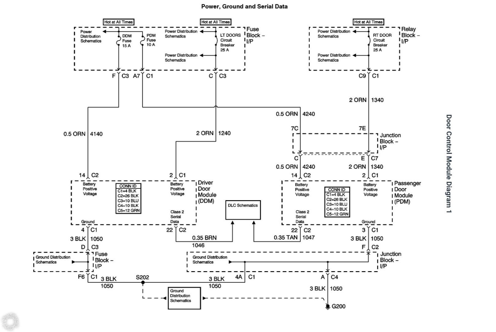

I have a 2004 chevy silverado base edition without power windows and door locks. I was told that i could swap out doors and everything would be plug and play. So I went out and got some doors from a 2004 silverado with power windows and door locks. Swapped out all the internal parts plugged them in and came to find out its not plug and play. My truck does not have factory wiring for power doors and windows. The only electrical connections to the door was the speaker wires and the door ajar switch signal, which comes from the lock actuators. The new door panels have the ddm and pdm to control the windows and locks. Can these be wired as a stand alone unit or can I wire them into the gm data bus interface. I will also be connecting an Avital 5305L and was wondering how i would be able to get door lock signal since i wont be able to get it from the bcm.
Platinum - Posts: 13,723
Posted: July 03, 2020 at 9:41 PM / IP Logged Link to Post Post Reply Quote i am an idiot
https://www.the12volt.com/relays/relaydiagram48.html
From switch = door lock and unlock wires of your alarm system.

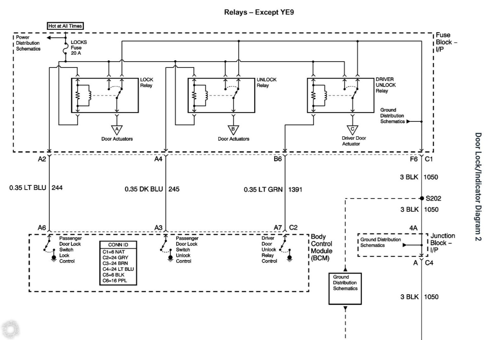

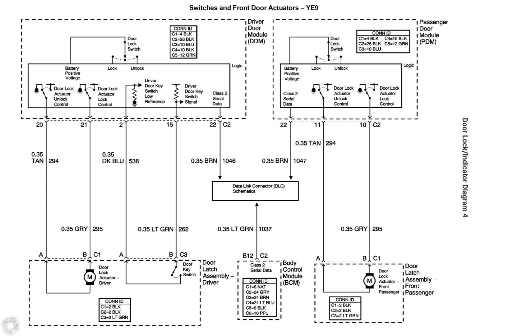

Thanks for the reply. Im still a little confused on this wiring. Looking at this diagram 2004 Chevrolet Silverado, Manual to Auto Door Locks, Avital 5305L -- posted image.
Will the door locks work without the brown wire going to the data link connector. I was hoping that i could just connect power and ground to each door module and run 2 wires from the driver door to the passenger door switch. A wire from tan to tan and one from grey to grey.
Or would I need to completely rewire each switch with new relays to get this to work. Im going to provide some extra wiring diagrams that may help.
2004 Chevrolet Silverado, Manual to Auto Door Locks, Avital 5305L -- posted image. 2004 Chevrolet Silverado, Manual to Auto Door Locks, Avital 5305L -- posted image.
Posted: July 05, 2020 at 7:48 PM / IP Logged Link to Post Post Reply Quote i am an idiot
Is there a tan and a grey wire going into the latch mechanism of both doors?

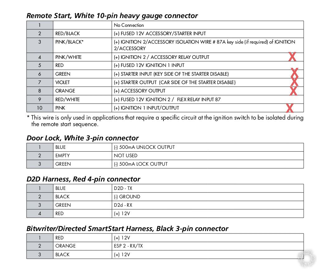

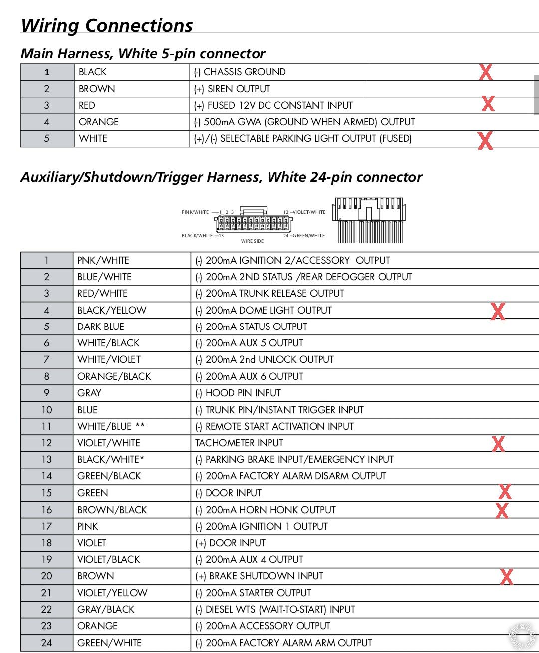

Im installing my alarm now and have a question according to these pics do i need to connect anymore wires? The ones with red x's are the ones that have been connected. 2004 Chevrolet Silverado, Manual to Auto Door Locks, Avital 5305L -- posted image. 2004 Chevrolet Silverado, Manual to Auto Door Locks, Avital 5305L -- posted image.
