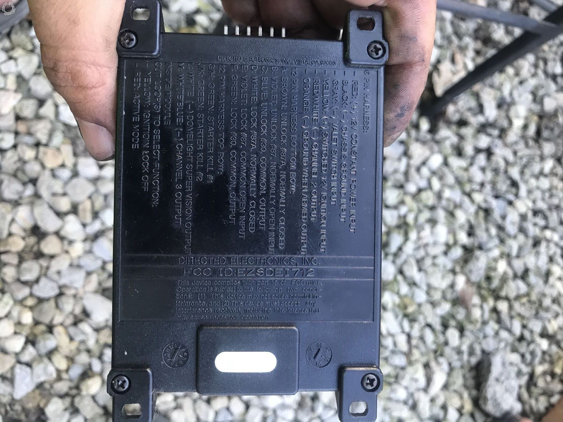

Hi everyone,
I recently bought a very clean 94 k1500 with the 6.5 diesel. It has a system installed in it, but the PO didnt know anything about it. It is a Directed Electronics Incorporated “brand”, but i cant find a model number or anything on it. I want to buy a remote to see if it works.
I contacted dei and sent pics, but never heard back from them. Hopiing someone here can help me out. Identifying This DEI Unit -- posted image.
Thanks!
Mike

Posted: August 19, 2020 at 10:58 AM / IP Logged Link to Post Post Reply Quote i am an idiot
DEI Valet 712 Not 100% sure but there is an install manual in the downloads section on this site.

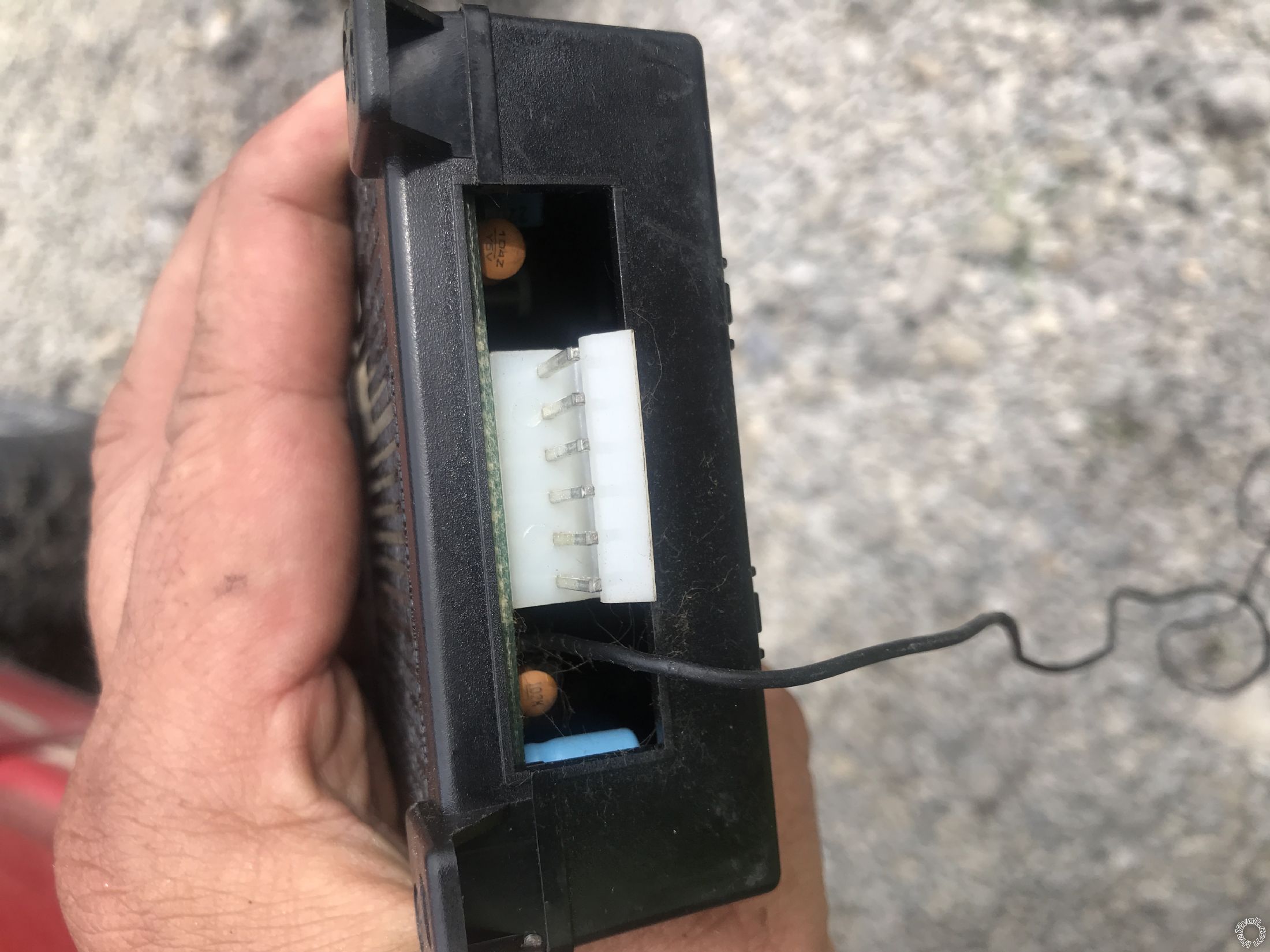

Posted: August 21, 2020 at 10:55 AM / IP Logged Link to Post Post Reply Quote high toned sob
I am an idiot, thank you, i looked at the wiring schematic but that one is different. Still nothing back from DEI, any other way i can ID it? Ill try to put up another pic.. Identifying This DEI Unit -- posted image.

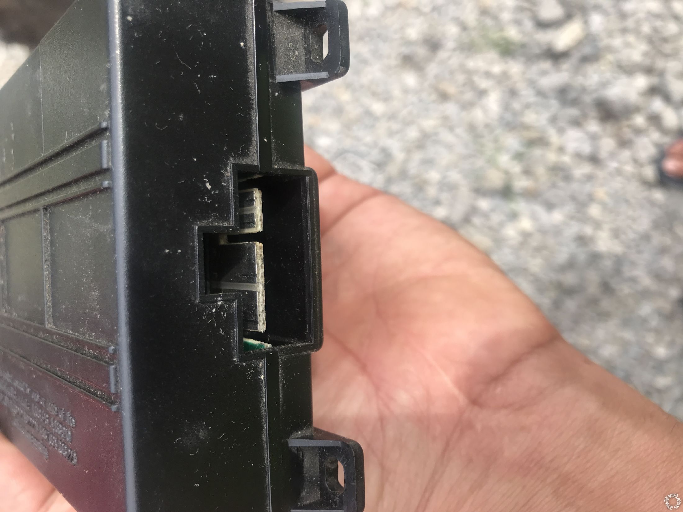

Posted: August 21, 2020 at 11:16 AM / IP Logged Link to Post Post Reply Quote high toned sob

Posted: September 23, 2020 at 9:24 PM / IP Logged Link to Post Post Reply Quote swamprat323
That FCC id number is coming up form 9/6/1990. Does not give any other info. What are you looking to do with it?

Posted: September 24, 2020 at 2:39 PM / IP Logged Link to Post Post Reply Quote high toned sob
Hi,
I am trying to find out what model it is so i can get a remote for it, to see if it works. I bought this clean 94 chevy k1500 diesel, and i was putting a stereo in it, and found it tucked up under the dash, all hooked up.
The previous owner didnt know anything about it, so i am just trying to see if it works.
I finally got a reply back from DEI, he thinks its a Automate am3. I tried lookimg those up to see if i could get a remote, but i dont see anything. Just need to know exactly what it is.
Ill probably find a remote for $35 and it wont work, lol
Thanks

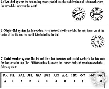

Posted: September 24, 2020 at 7:18 PM / IP Logged Link to Post Post Reply Quote swamprat323
When looked up the FCC id, it did come up with 302 mhz low and 303 high mhz. Found two remote for automate 3. One is no longer made the other if they do have it, is 50 bucks. But need date code form old remote. But even at 50 bucks, not even worth it.
Automate 3      430A      Up to 2B      465T
Automate 3      430A      2C-6C              493T
Remote 1
remote 2

Posted: October 18, 2020 at 10:47 AM / IP Logged Link to Post Post Reply Quote lurch228
Date code is 5 of 93 so should be a 493t remote (scratch code). Code should be on a white sticker inside of brain unit. Identifying This DEI Unit -- posted image.
