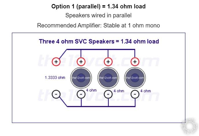

Which Amp to Use on 3 Subwoofers or Can I Use Both? -- posted image. From what I understand you have the sub confugered in the picture. You would need an amplifier that can handle down to the 1 ohm impedance.

You have them in parallel as suggested above, and that amp is not stable at 1 ohm. See here:
https://www.the12volt.com/caraudio/subwoofer-wiring-diagrams.asp?Q=3&I=41

that is the exact picture i posted above, The final resistance in ohms of the 3 subs wired in parallel is 1 ohm. The amp needs to be 1ohm stable. The subs will be ok, the amp may overheat and thermal shut down.     Can you please post exact which model of amp you are using on the subs, Is it a Punch amp, but which model??
It may be stable down to 1 ohm .

The California amplifier is 4 ohm mono stable. Do not even attempt to run it at 1.33 ohms.
