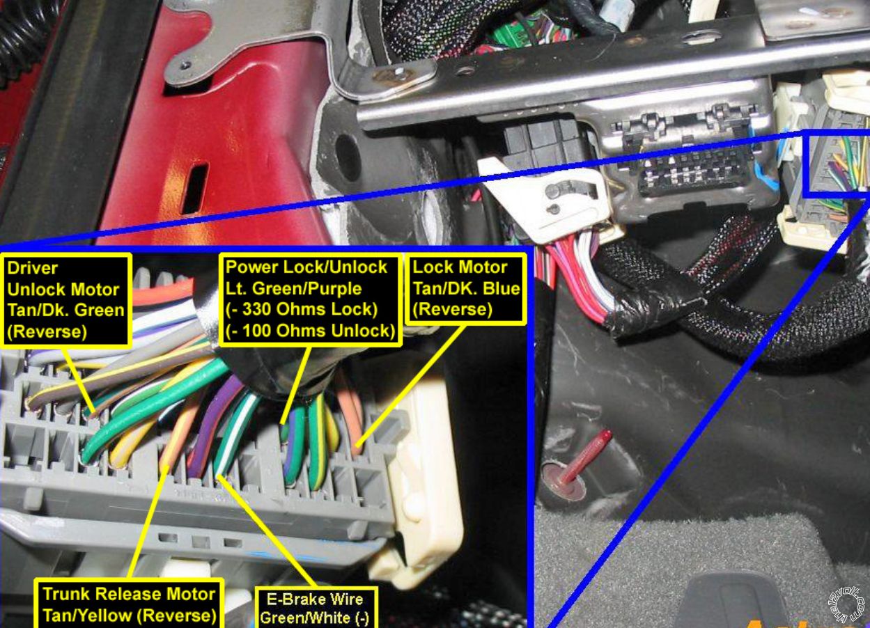

Thanks.2009 Dodge Avenger, Door Locks -- posted image.

Hello, does anyone know where I can find the gray 43 pin connector diagram layout, this plug is located under the steering column.
Thanks

Thank you very much, very helpful
