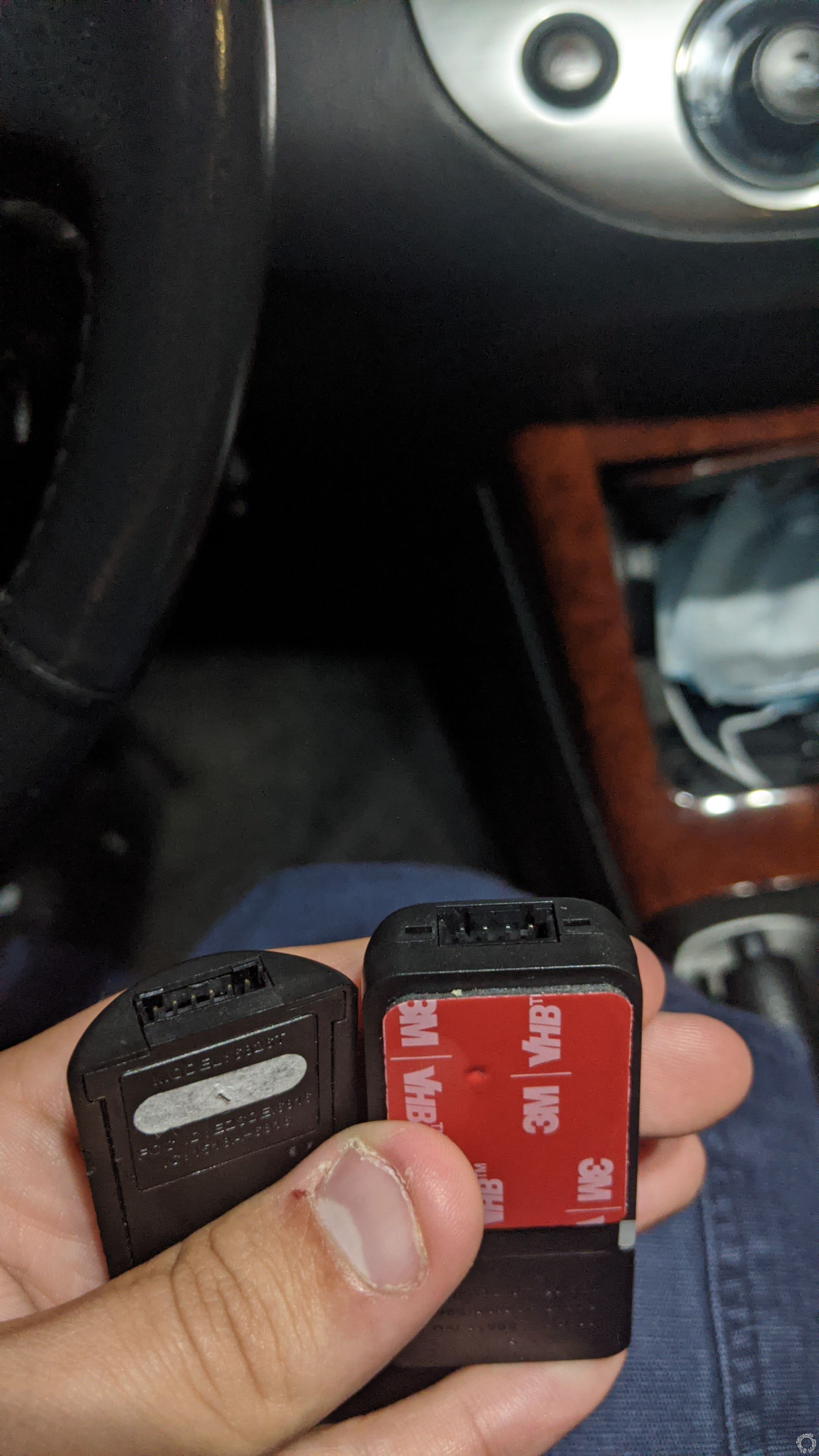

So I needed a replacement remote for my what started life as a 4816v
I've been using a 7856v and 7857v for a while now with no problems, but they've been ravaged by puddles and time
I won a D9857x kit on eBay real cheap, thought I was getting a good deal and they'd pair right up
It came with the new 6867T antenna, and 7656x/7857x
So I go to pair them all up, both two way Vipers take as before, and the one way 7656x pairs and works just fine
But the two way 7857x refuses to pair
I've charged it, tried multiple ways multiple times, I know I'm doing it right because the other 3 go through fine
I erased them all, tried again, no dice
I'm wondering if my original 6826t antenna can't handle the new two way Clifford?
The box makes mention of XDR/DS4, something this install pre dates
I tried swapping in the included XDR antenna, but it's connector has less pins (see the picture)
Do I need a different cable, or a different antenna?
Or is this just never gonna work?
DEIs site says the new control center is supposed to be backwards compatible
Any advice, it'd be appreciated
Thanks,
Mike

The XDR 2-way remote requires the XDR antenna to be used. Use the (black)4-pin antenna to (green) 6-pin brain cable that should have come with your XDR antenna plug or the 5" Adapter cable (6-pin to 4-pin connectors) to adapt to the XDR antenna depending on what came with your kit. If you didn't get the cable then you'll have to get one. The pink and grey outside wires are the led and valet direct to brain wires the remaining 4 wires are(green send) (red) power , (black) ground and (blue) receive data wires. The led and valet should still work on the new antenna with the 4816v brain. Before switching antenna's delete all remotes, or zap with bit-writer if you have one. Then pull power from brain and swap antenna to XDR. Start by pairing the new 1-way XDR remote first then the 2-way XDR remote once successful, program remaining old remotes. If XDR 2-way remote still won't pair then the data id range for the new remote is outside the programmed data id range the old brain is programmed for. But you won't know until you try with the new Antenna control center.
That's the problem then
My kit didn't come with the antenna cable and or adapter
Is there a separate part number, or does anyone have one they'd be willing to sell me?

That explains the killer deal you got! A 4- pin to 4-pin cable might work if you can find one . You would need to center the 4-pin plug in the main 6-pin on the brain leaving 1 unused pin on both sides. This should work as long as the valet and status led are controlled through data on the antenna receiver. Otherwise if you want to try modding the existing cable just find any antenna wire that has the 4-pin connector for the antenna side and de-pin the 6 and and replace with the 4-pin connector and insulate the gray and pink wires.

A d2d cable won't work as the XDR antenna he bought has has a 4 pin version of the 6 pin that comes with his original antenna. The XDR antenna has the black 4 pin that is used with other antennas though they only have 3 wires between the brain and antenna but the plug is still 4 pin! His brain has the green 6 pin plug so no go with d2d cable!
