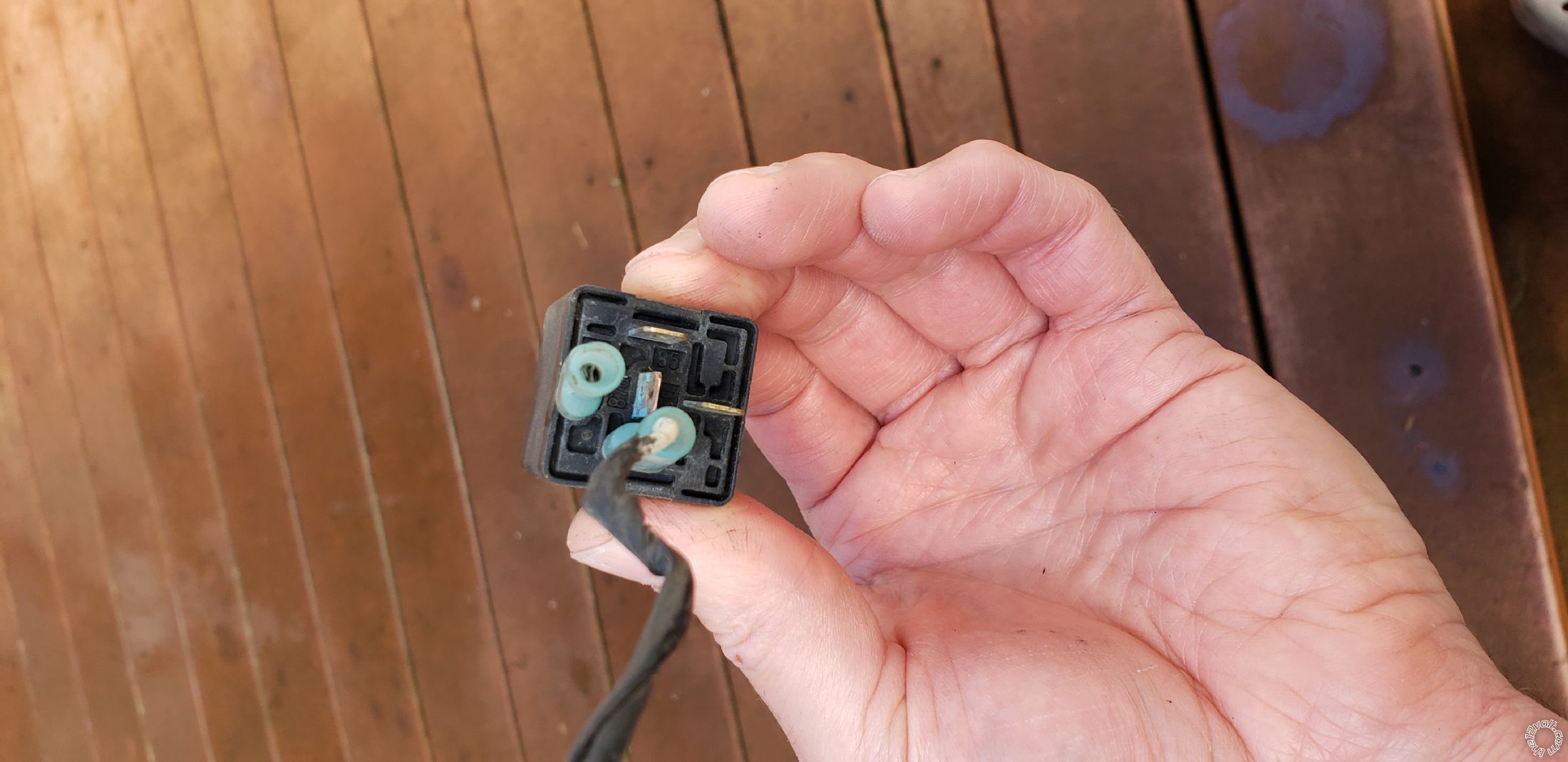

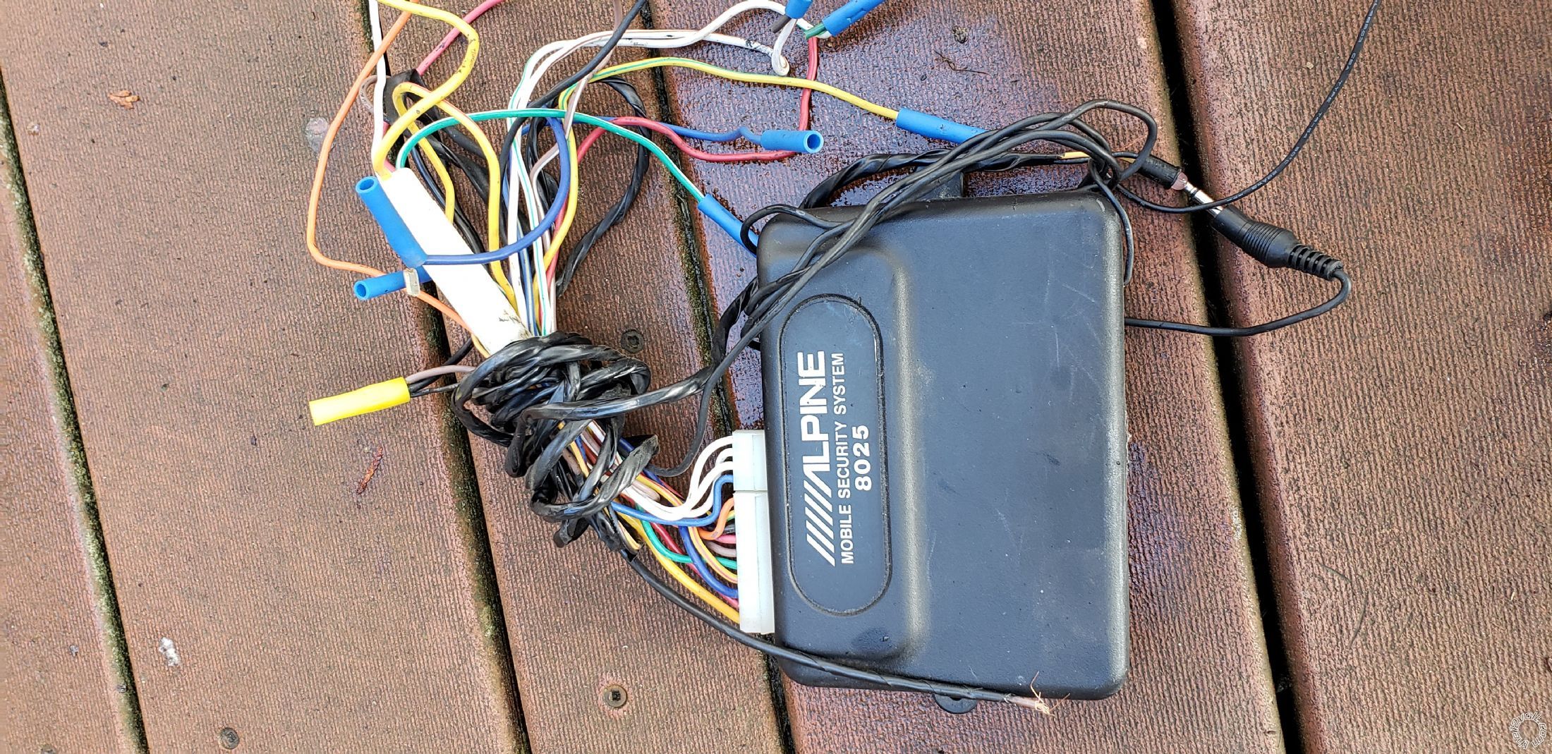

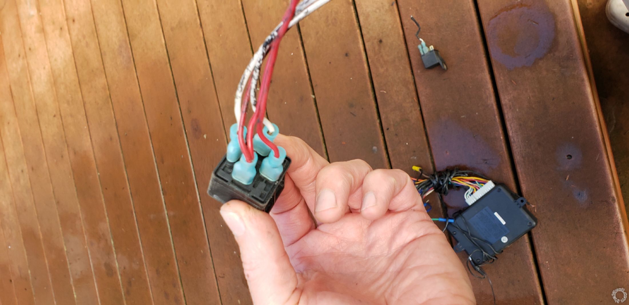

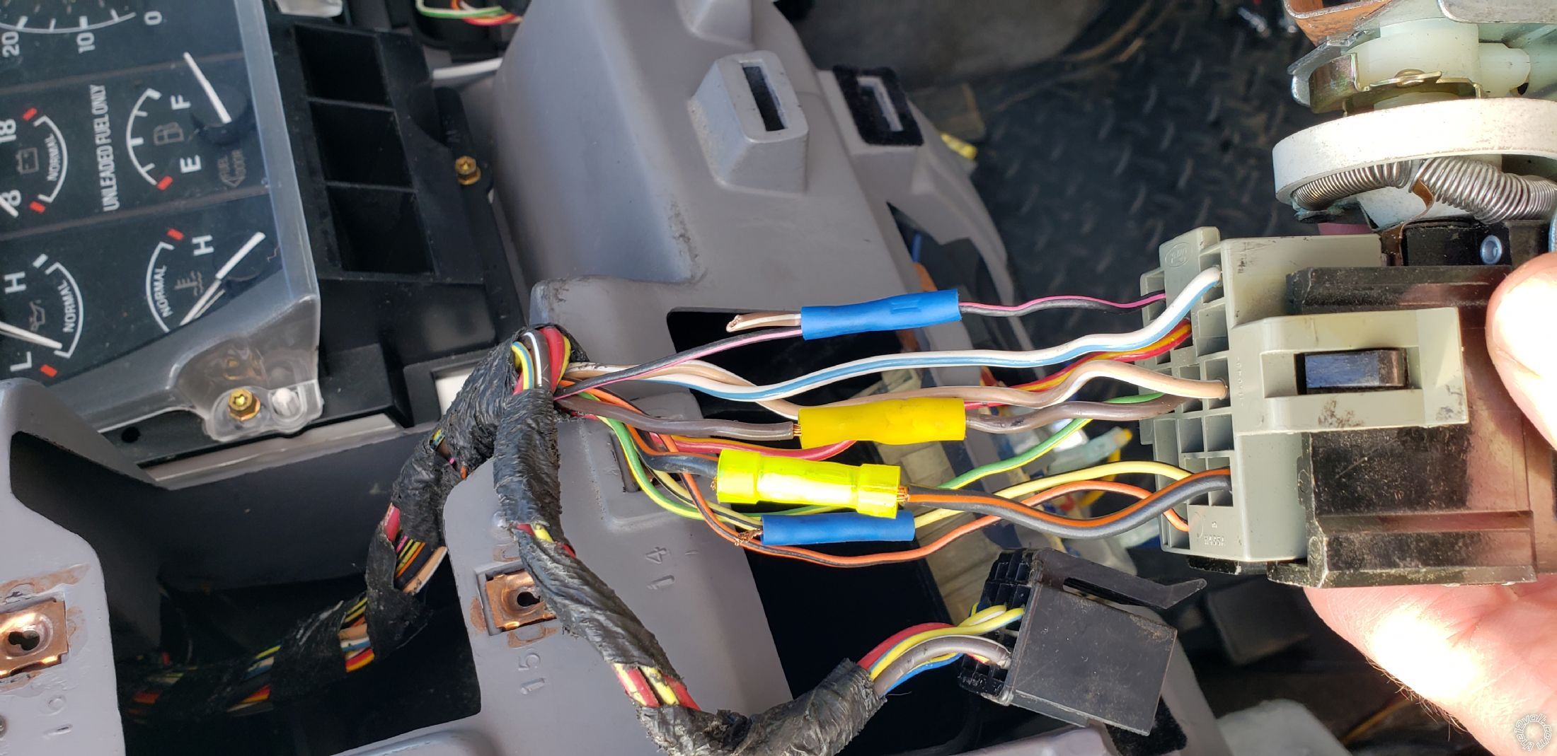

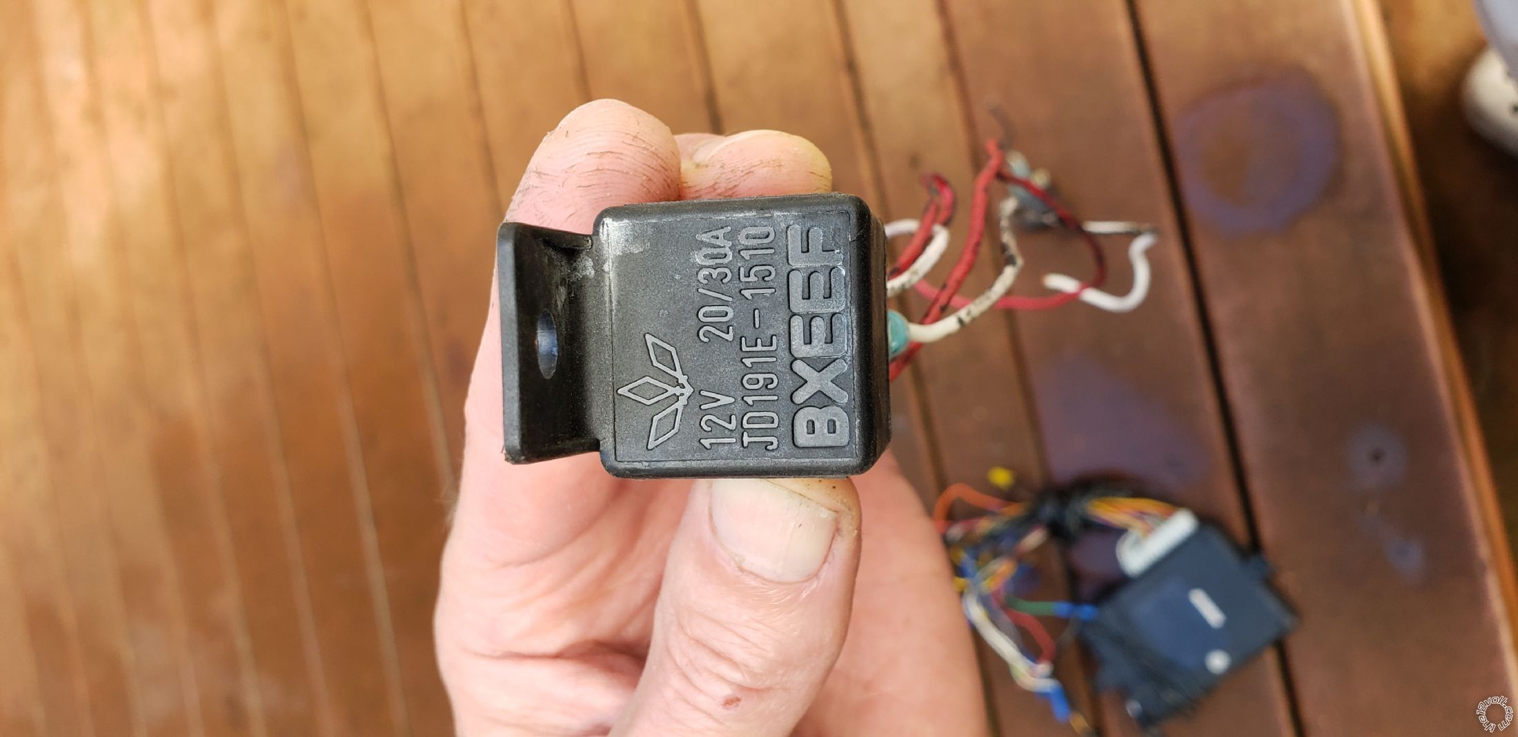

I have a 1994 ford f250 that had this alarm in it. I removed the alarm and am now having trouble. Crank but no start. I have read in other posts that most older alarms don't go beyond the ignition switch (doesn't mess with fuel pump, injection, etc). I need help troubleshooting. There was no ignition wire that I found that was cut and a relay placed in between. Instead wires spliced into the existing wires. So, the simple solution of removing the relay and reconnecting the ignition wires to factory isn't an option. One relay was next to the unit itself, and a second relay was next to the solenoid. Alpine 8025 Removal, 1994 Ford F-250 -- posted image. Alpine 8025 Removal, 1994 Ford F-250 -- posted image. Alpine 8025 Removal, 1994 Ford F-250 -- posted image. Alpine 8025 Removal, 1994 Ford F-250 -- posted image. Alpine 8025 Removal, 1994 Ford F-250 -- posted image.

Not sure about the colored wires you listed. I'll have to dig into the steering column. But, what I did find is of the spliced wires, the black with pink is 12v. The black with orange is 12v. The solid brown will go 12V which I crank. The yellow with brown will go 12V when I turn the ignition on (not cranking).

Well, there are 4 yellow and 2 gray with yellow. Really tight fit in there. Most have 12v to them. One of the grey with yellow shows 12v with ignition on. The red with green is the same. Sorry, I'm not very good with the voltage meter. Some of them shoot up to 50, but it's digital, so the numbers are bouncing all over. I just touch the ground terminal to the door frame?
