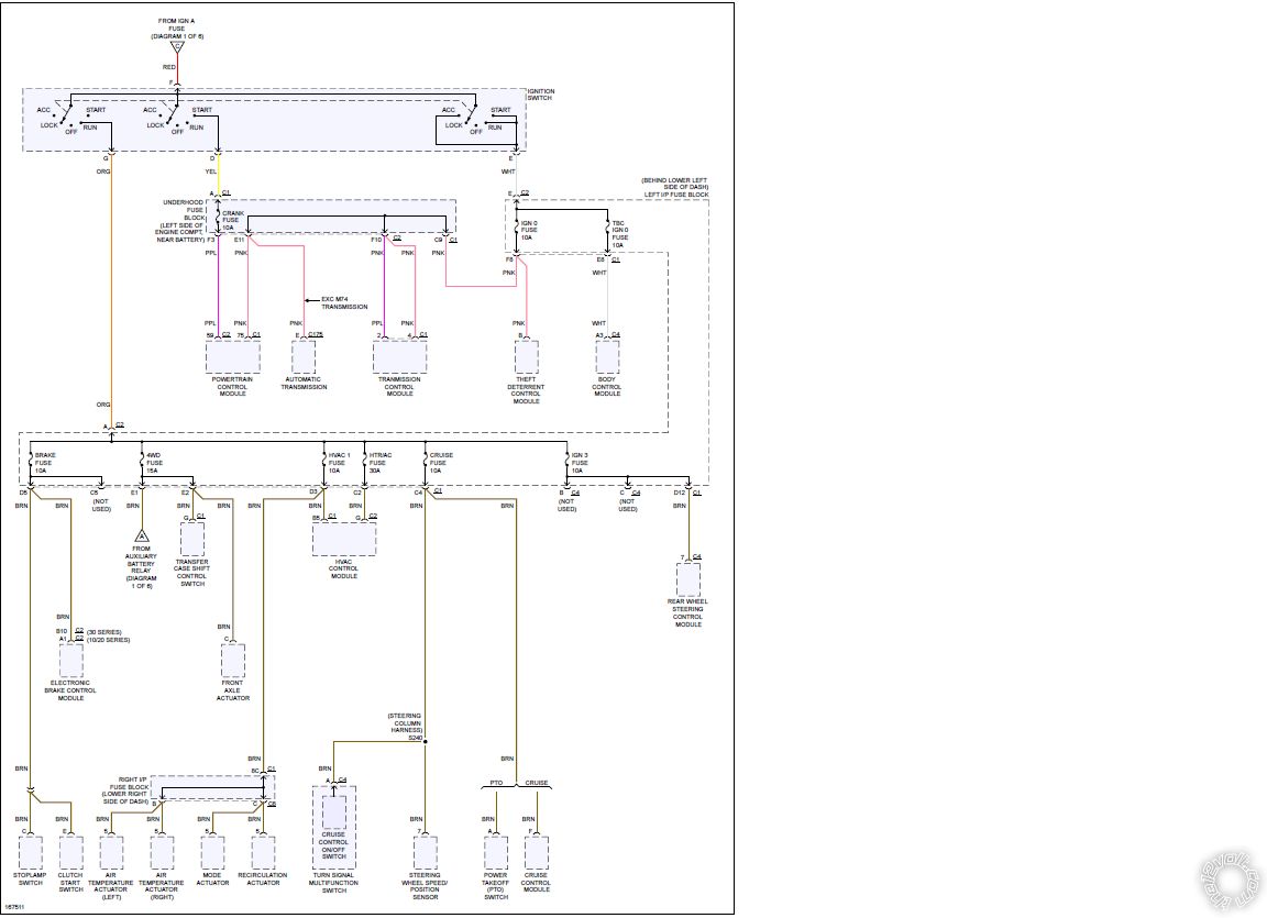

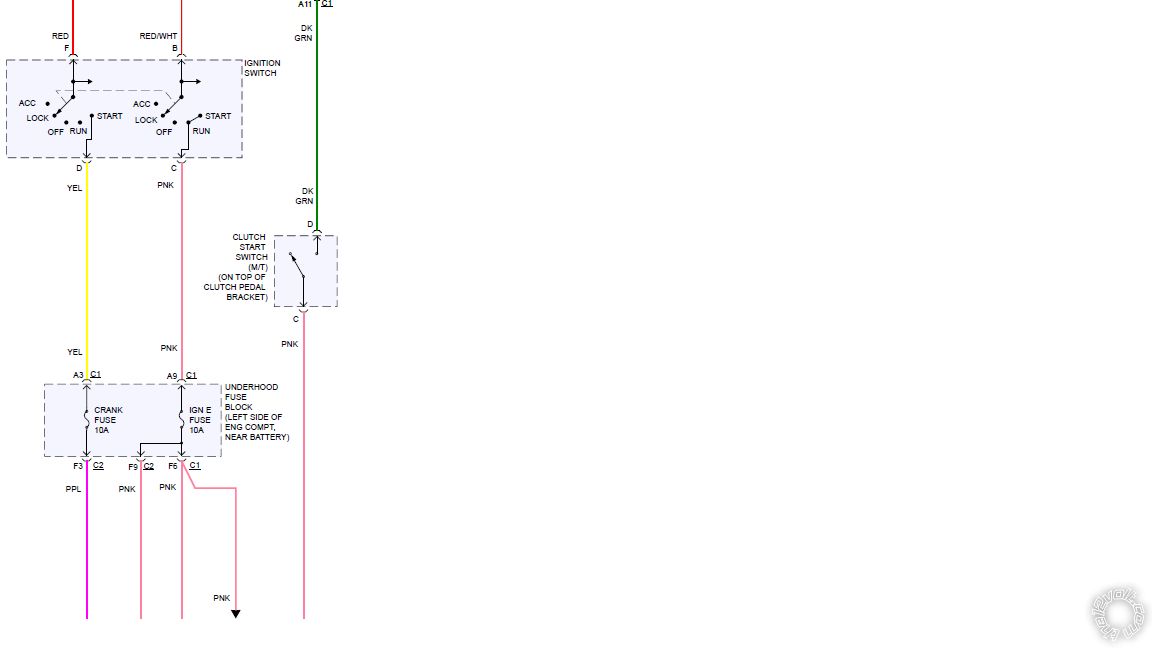

so if i understand correctly connect the blue to the pink wire Remote Start, Passlock, No Shift, 2003 Chevrolet Silverado -- posted image.

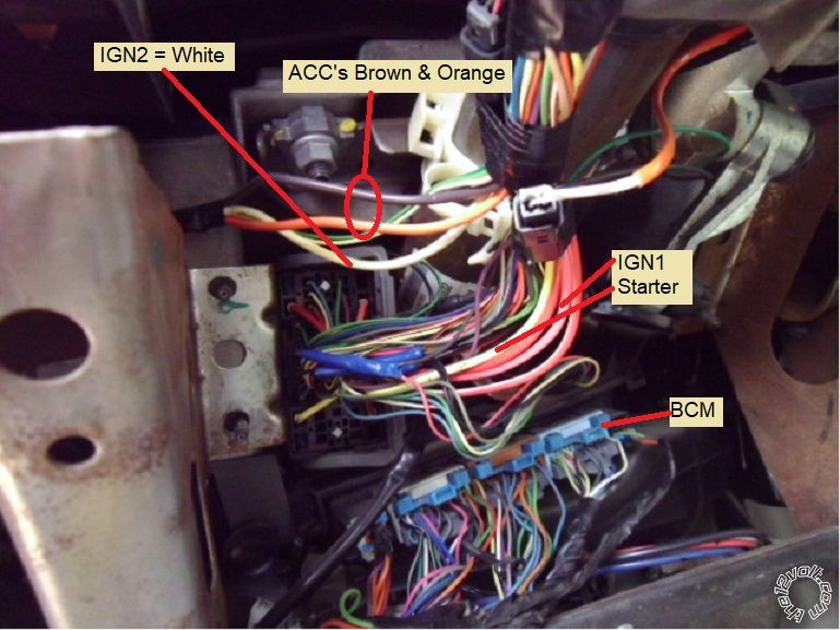

These ignition connections can all be made inside the truck, under the steering column.
Here is a photo of the ignition wires :
