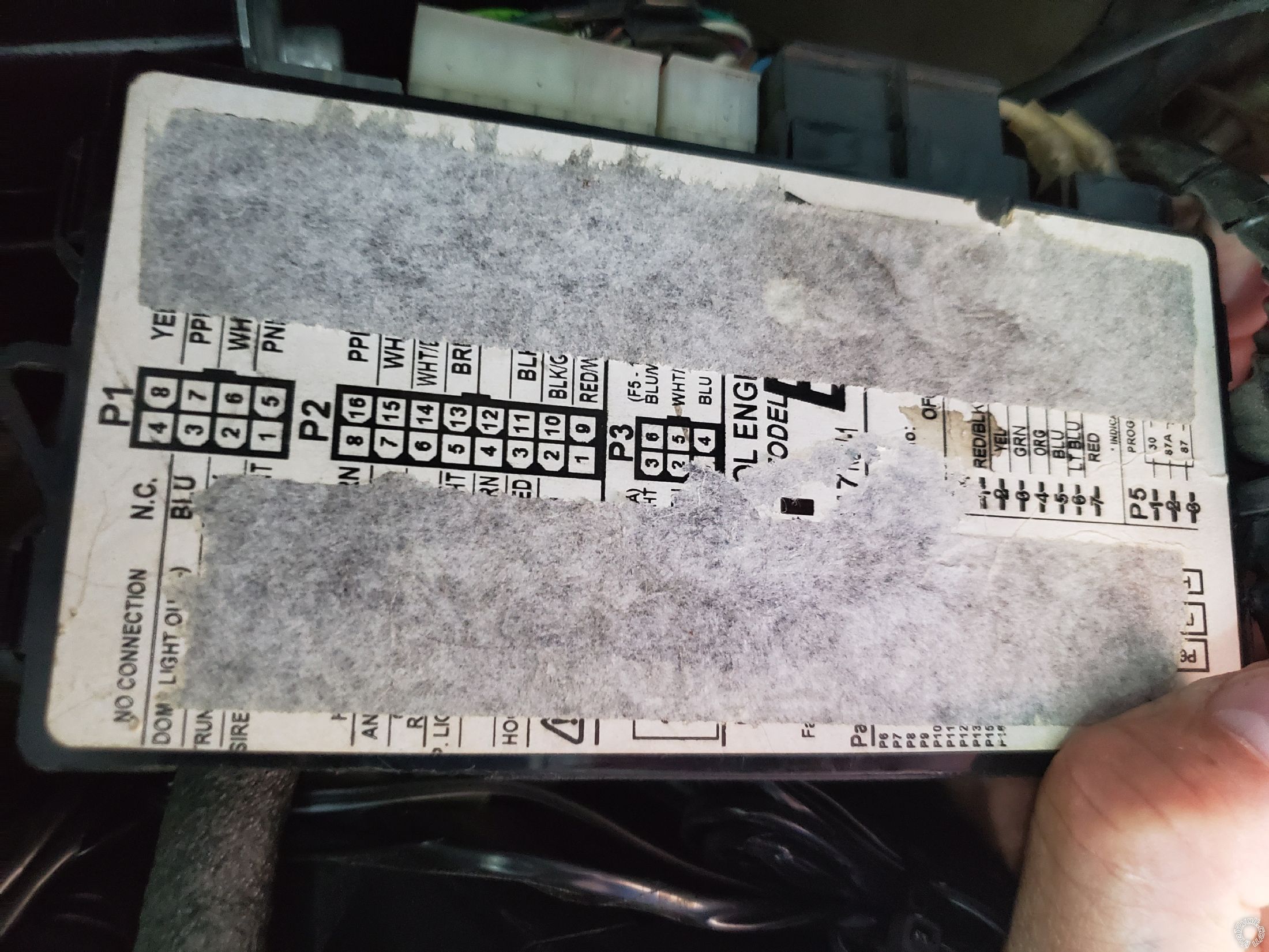

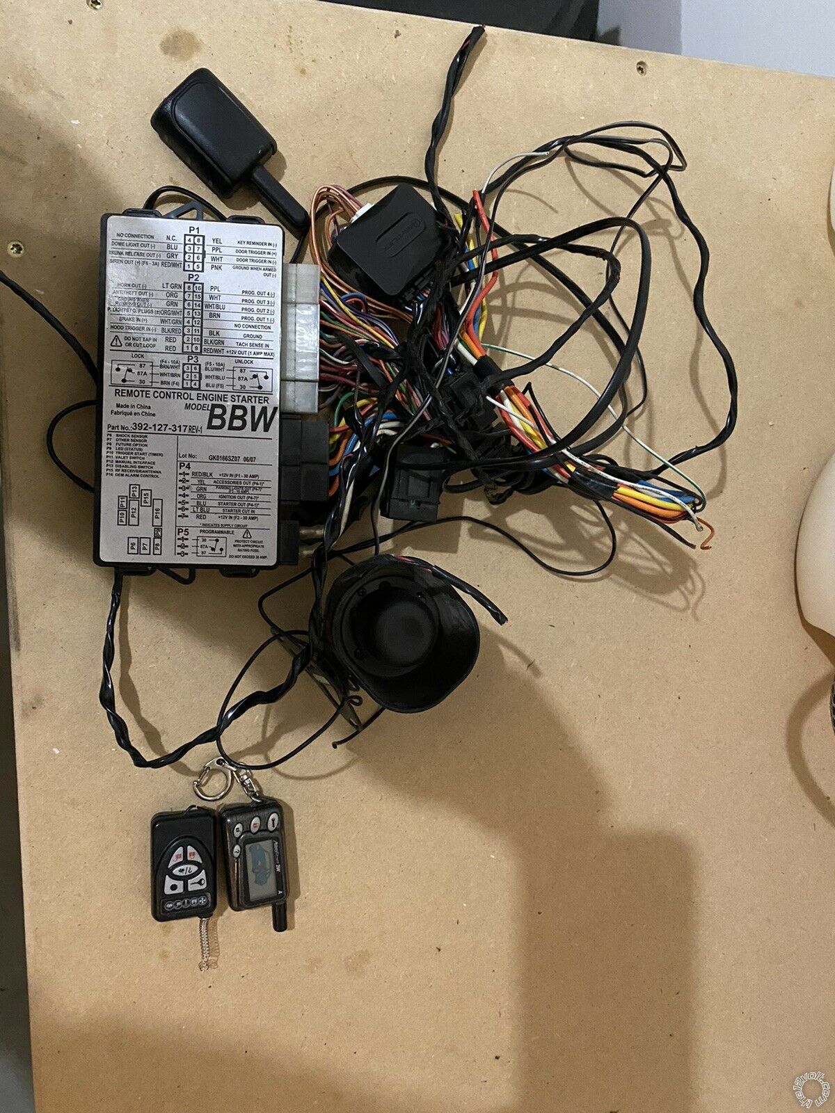

I am wanting to find out which AstroStart model that is in my 2001 F150 Lariat. I was given no remotes, when I bought the truck. I pulled the main box down (it was stuck to the truck module up under the dash) and it pulled the identifying stickers off of the unit, so I can't read any of the numbers that I need. I have pics of the system, and if there is any other way to identify this, so I can possibly purchase the correct remote, then I will see what I can find. Here is some pics of the unit, antenna, and power switch. AstroStart Model Identification -- posted image. AstroStart Model Identification -- posted image. AstroStart Model Identification -- posted image. AstroStart Model Identification -- posted image. AstroStart Model Identification -- posted image. AstroStart Model Identification -- posted image.

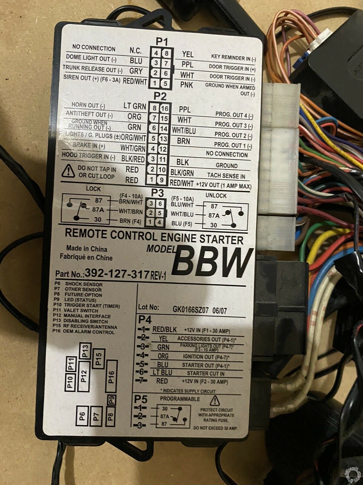

Looking at this post and looking at whats left of your sticker I think its the one that ends in 317 REV1 BBW
https://www.the12volt.com/installbay/forum_posts.asp?tid=131744

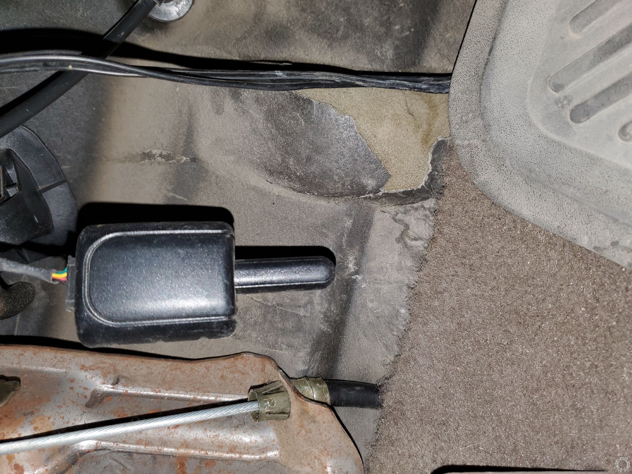

If you get this working you should mount the antenna on the windshield. Having it under the dash really limits the range.
I uploaded the install manual for you that I found with google. Transmitter programming on page 27

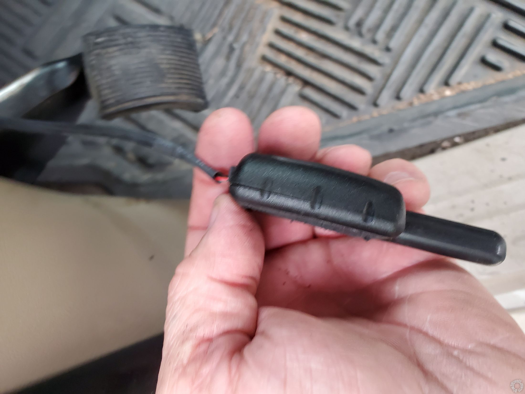

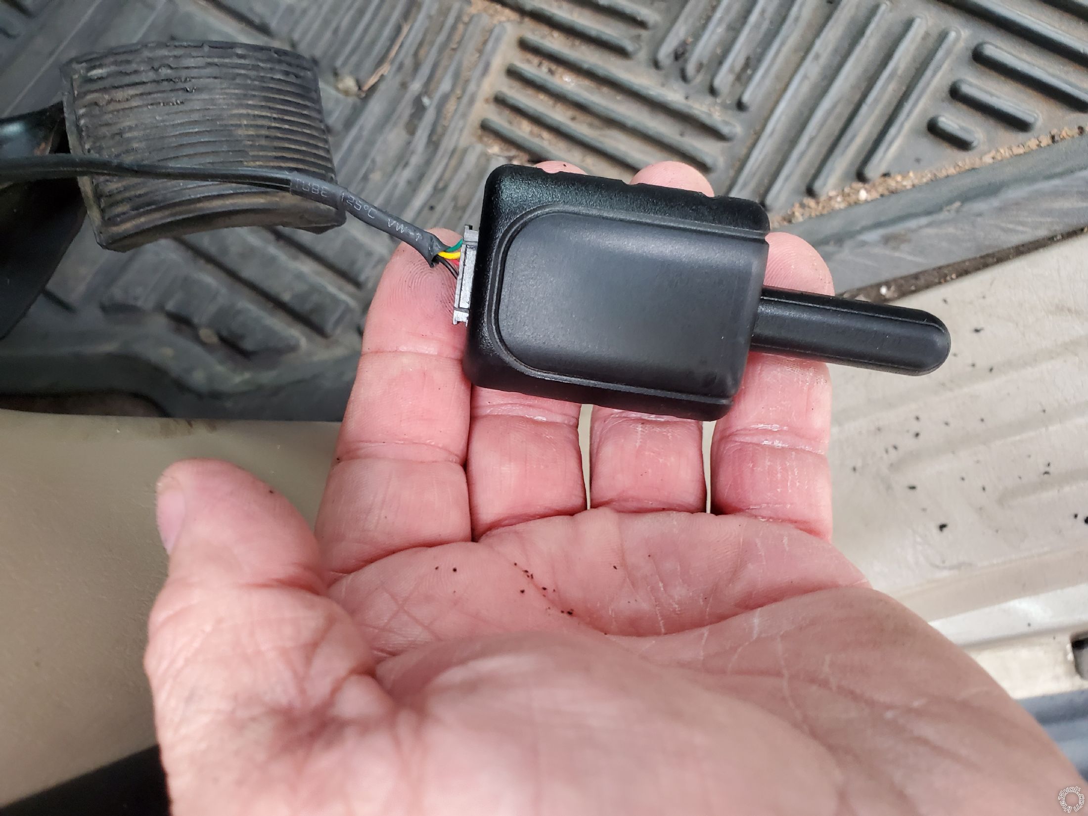

Can you look to see if there are any frequency numbers printed on the antenna case?

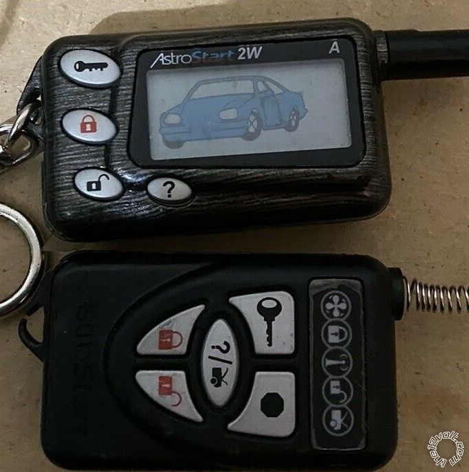

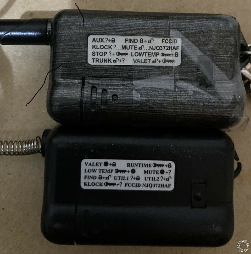

Posted: November 22, 2020 at 11:36 PM / IP Logged Link to Post Post Reply Quote iskidoo
Found an ebay auction that has the brain and remotes together so thats good. Makes it easy to figure out the exact remotes that came with that BBW system.
Remotes have FCCID: NJQ372HAF on them.
https://www./i/264942543307?chn=ps&norover=1&mkevt=1&mkrid=711-117182-37290-0&mkcid=2&itemid=264942543307&targetid=882300791467&device=c&mktype=pla&googleloc=9002593&poi=&campaignid=1669934603&mkgroupid=65058347419&rlsatarget=pla-882300791467&abcId=1123856&merchantid=6296724&gclid=CjwKCAiAtej9BRAvEiwA0UAWXg8lUgKQbLp3pAsbJFdoQDl4vquF3ykeNB9C2fNd7QH82LkGX1lv9BoC3dwQAvD_BwE
So you can use this LCD one here LCD Remote https://www.keylessentryremotefob.com/astrostart-NJQ372HAF-4-button-screen-key-fob-p/astro%20njq372haf%204btn.htm
Or this LED remote LED Remote
https://www.keylessentryremotefob.com/astrostart-NJQ372HAF-5-button-keyless-entry-remote-p/astrostart%20njq372haf%205btn.htm
This should be the Owner's Guide for that outlines the functions for the remote transmitters.
AstroStart 4204A Owners Guide

I will try to see if there are any on the antenna, and let you know, thank you.

Ok, I got more pics of the antenna, but with the way it was mounted, I can tell if it even ever had any markings or numbers on it, but here they are. AstroStart Model Identification -- posted image. AstroStart Model Identification -- posted image. AstroStart Model Identification -- posted image. AstroStart Model Identification -- posted image.

Some adhesive remover and elbow grease will get rid of the mounting tape. Then you can see the numbers underneath.
