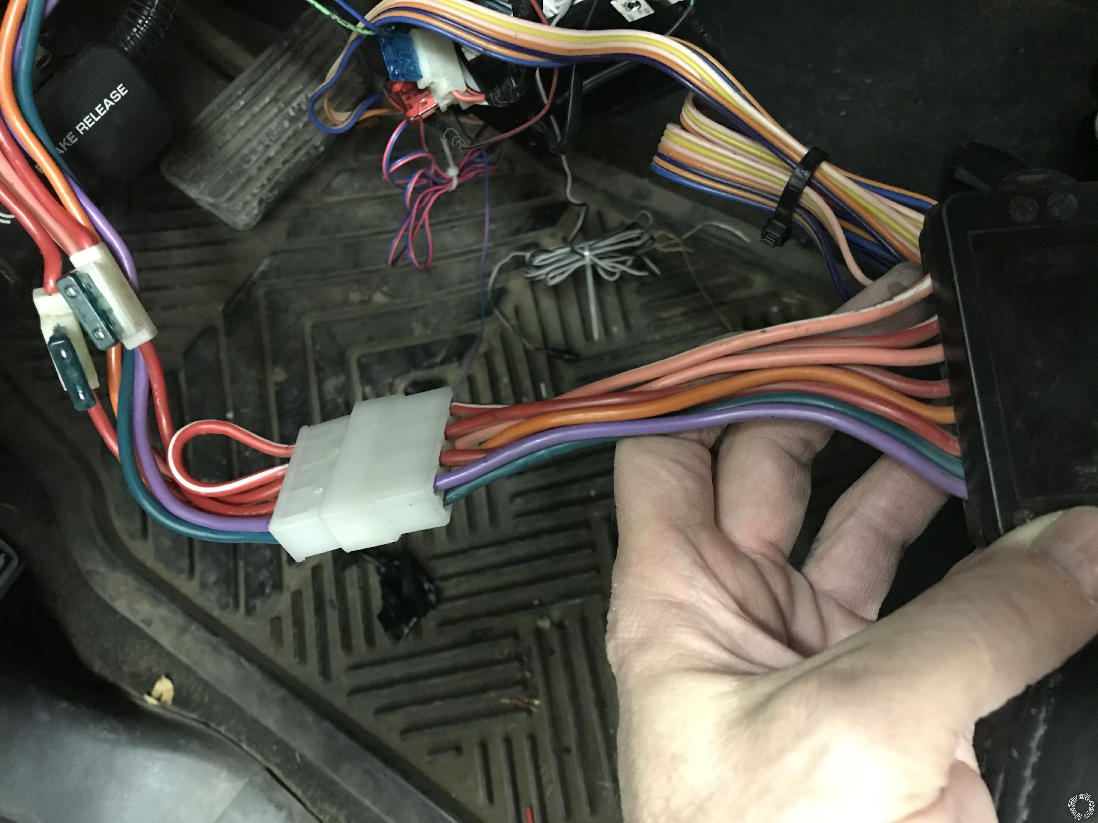

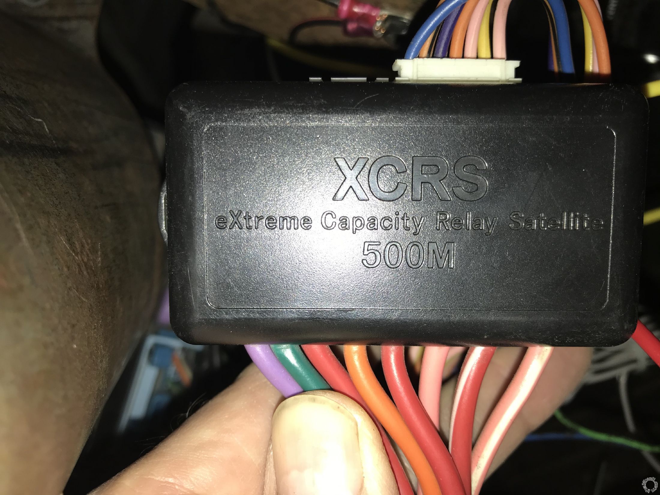

Posted: November 26, 2020 at 2:00 PM / IP Logged Link to Post Post Reply Quote wittler
Yes have power to both heavy red wires fuses good. Power comes out on ignition 1 but not 2. Wondering if the relay module is not working properly Viper160xv, Check Engine Light, 2000 Chevrolet Silverado -- posted image.

Posted: November 26, 2020 at 4:12 PM / IP Logged Link to Post Post Reply Quote kreg357
There might be three +12V input power wires, Red, Red and Red/White. All three must have +12V constant.

Posted: November 26, 2020 at 8:49 PM / IP Logged Link to Post Post Reply Quote wittler
Here is pic of heavy wires all red and the red/white have power. Viper160xv, Check Engine Light, 2000 Chevrolet Silverado -- posted image.

Posted: November 27, 2020 at 8:16 AM / IP Logged Link to Post Post Reply Quote wittler
How could I test that this relay module is getting a signal to turn on ignition 2? Would I check for - 200ma signal on pink/white small wire on ribbon coming from the main unit?
