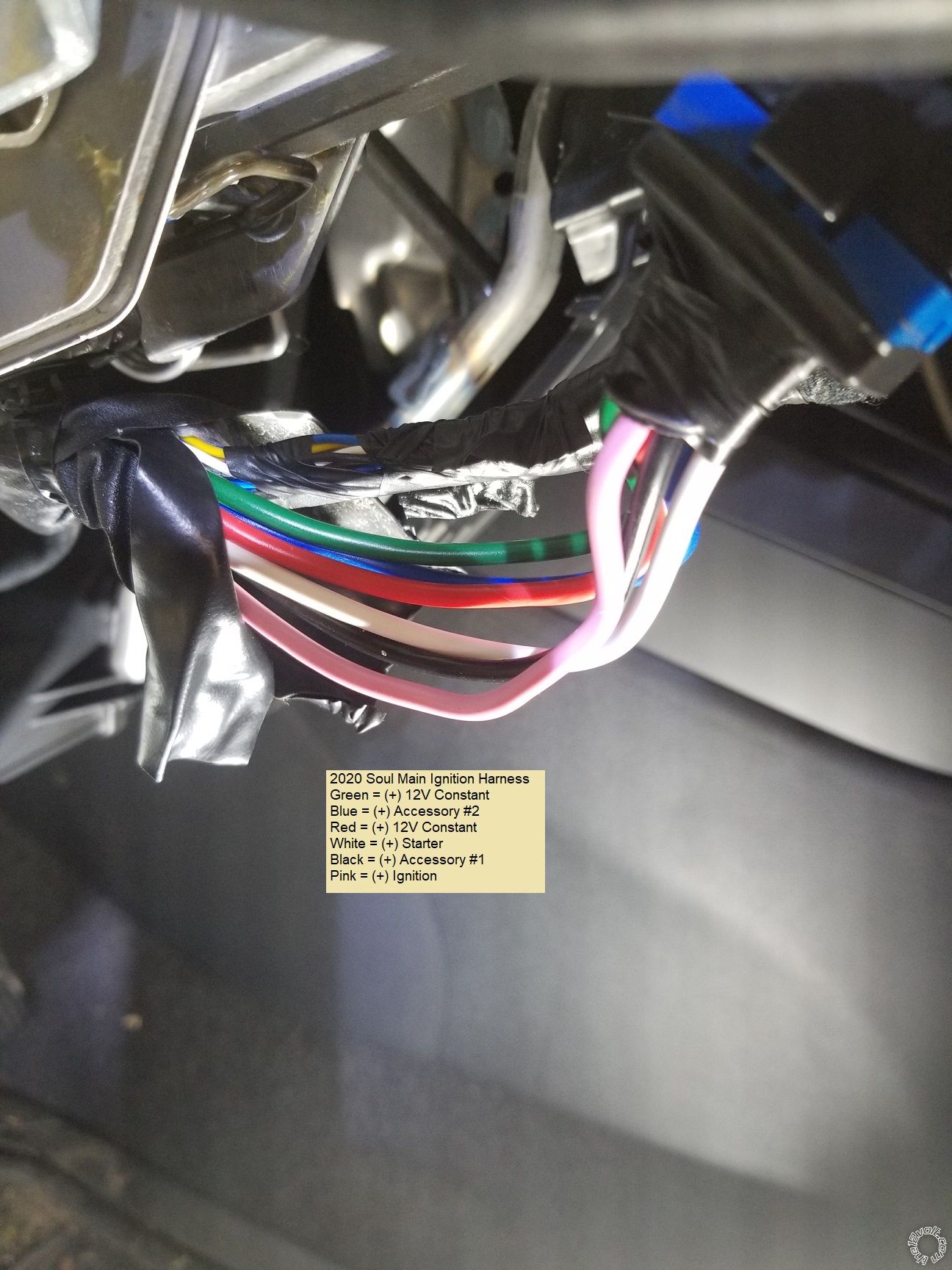

As shown in the Bench Prep photo, power for the R/S system was obtained from the fuse box and not at the main ignition switch harness. This is strictly an installer preference. There are two perfectly good +12V constant wires at the ignition switch but due to the limited access area and the tilt/telescopic steering wheel, I usually get power at the fuse box.

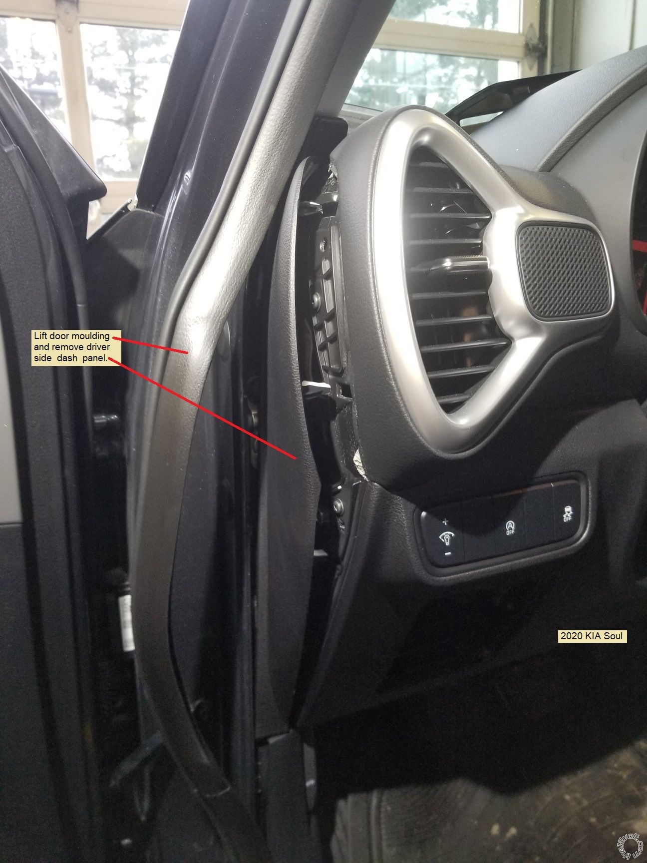

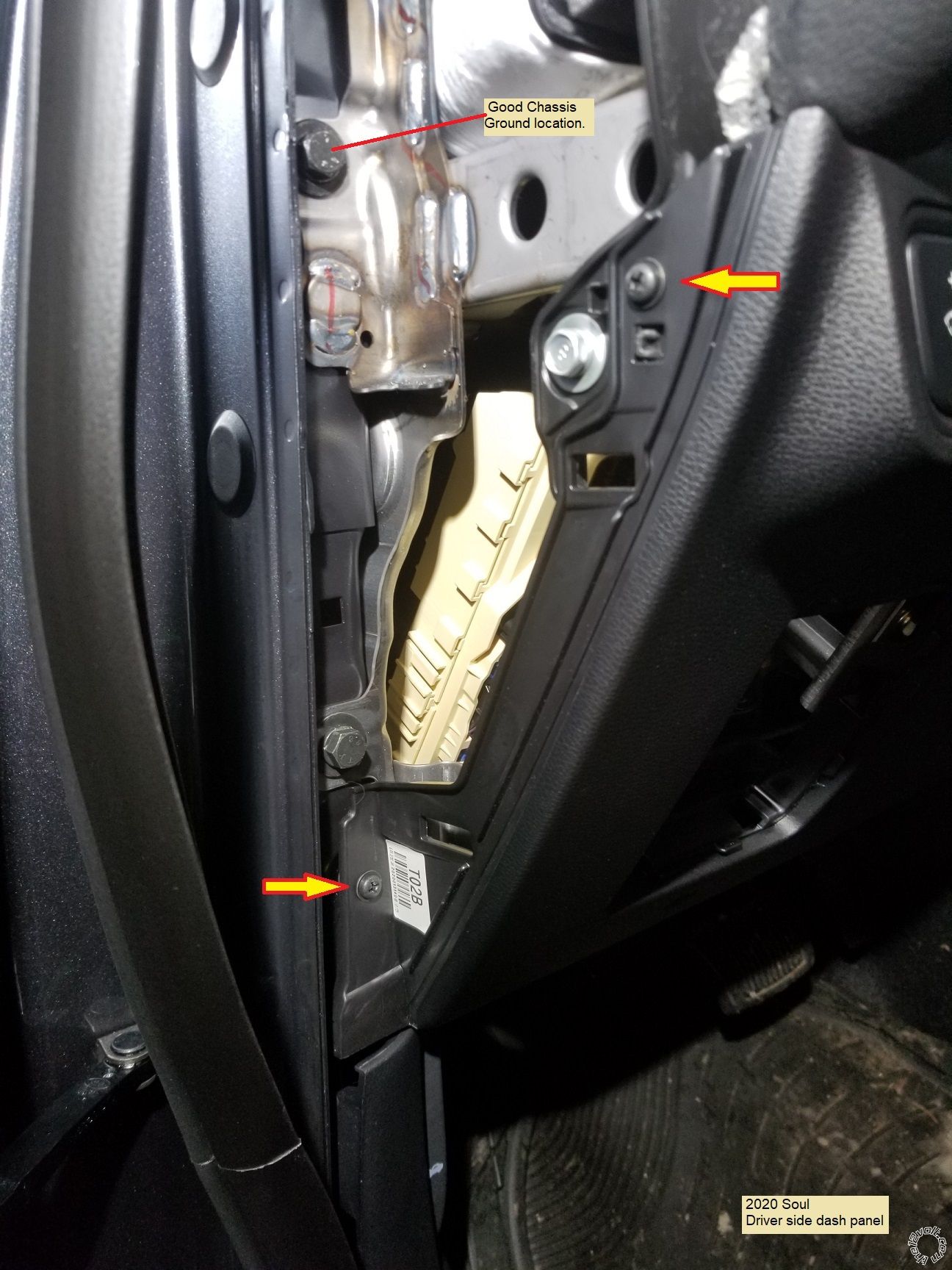

Lift the door molding along the drivers dash pillar. Remove the driver side dash panel with a non-marring trim tool. This will expose two Philips screws, allow antenna harness routing to the upper windshield and access to a good chassis ground location.
2020 Kia Soul, Regular Key, Remote Start Pictorial -- posted image.
Remove the two Phillips screws indicated in the photo below.

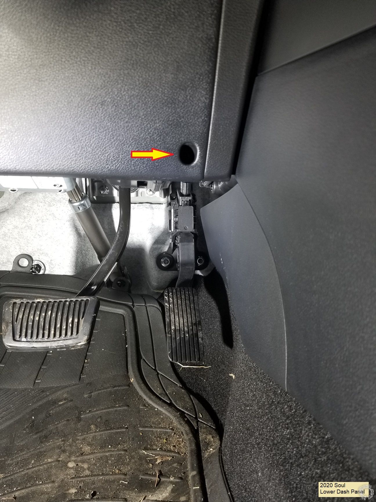

Next remove the lower dash panel Philips screw indicated below.
Release the lower dash panel at the door side and remove the panel. Pop the OBD2 connector out of the panel and unplug the other attached harnesses. Place the panel to one side.

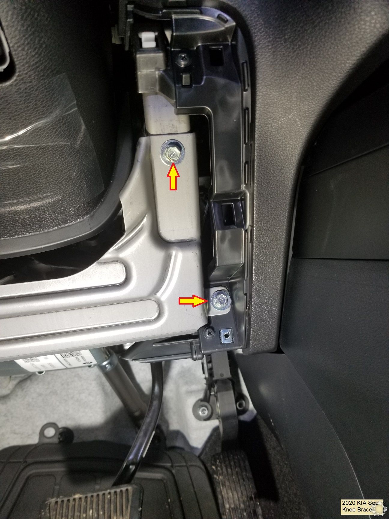

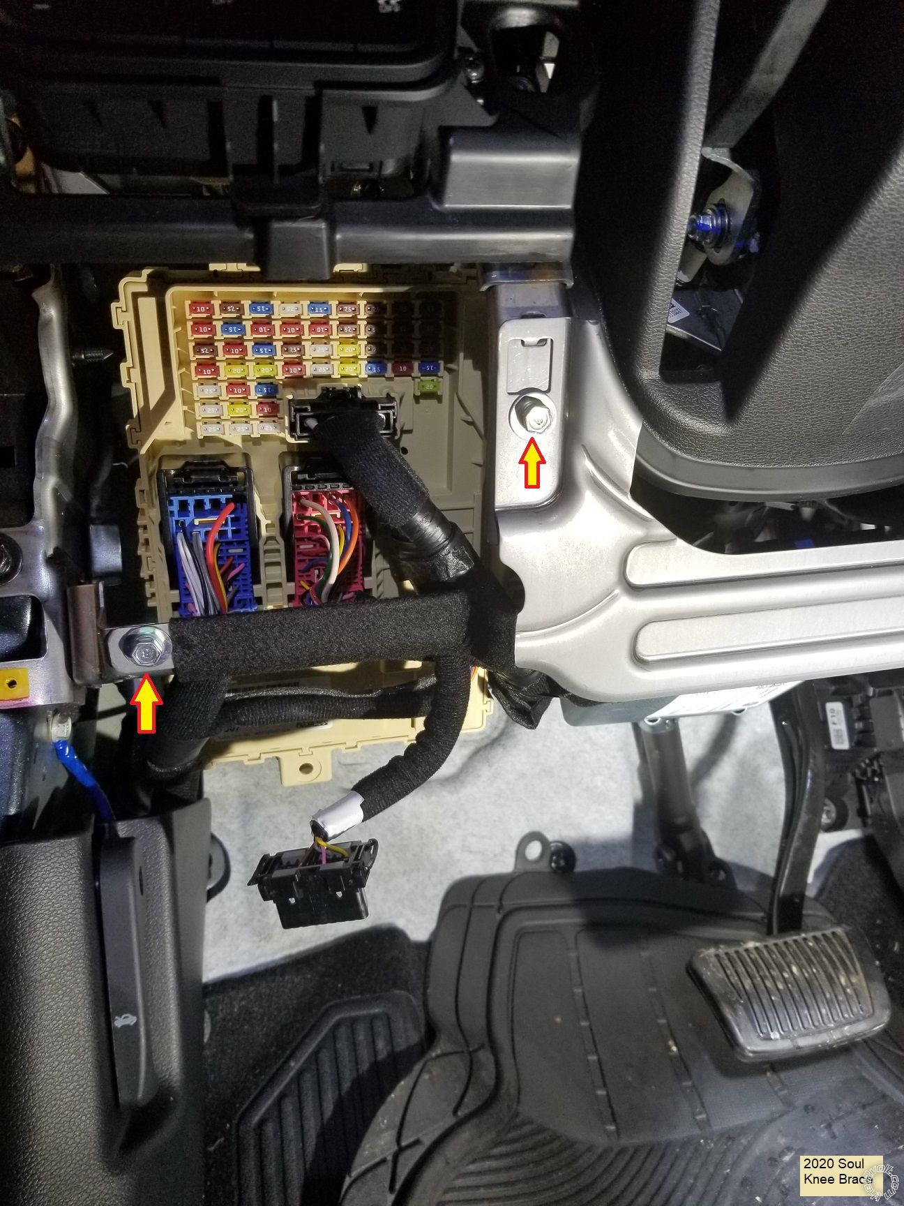

Remove the four 10mm bolts from the knee brace and remove to provide better access to the fuse box.

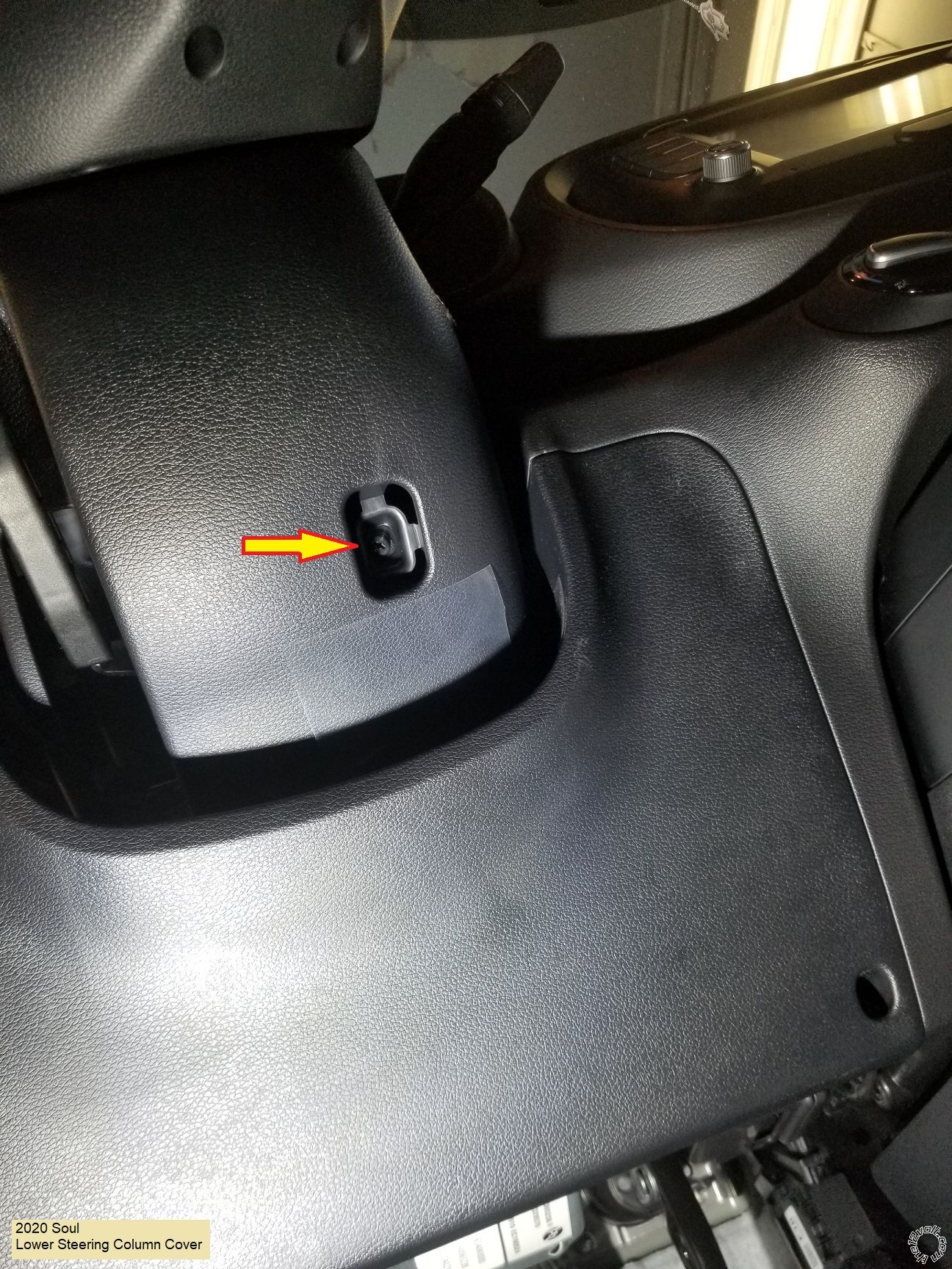

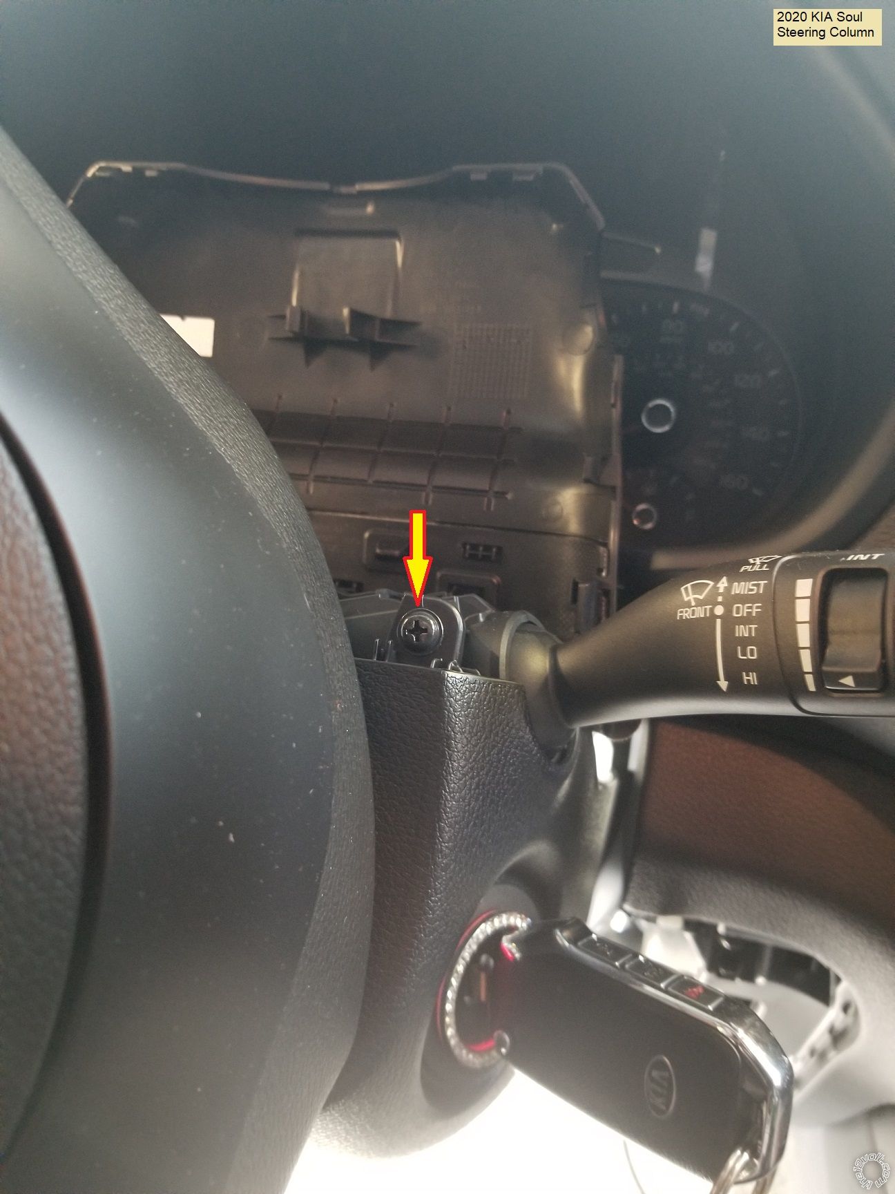

Remove the Phillips screw from the lower steering column trim.
Use a non-marring trim tool to separate the upper steering column trim and tilt it up to expose two Phillips screws that retain the lower column trim panel. Remove these two Phillips screws and the lower trim piece.

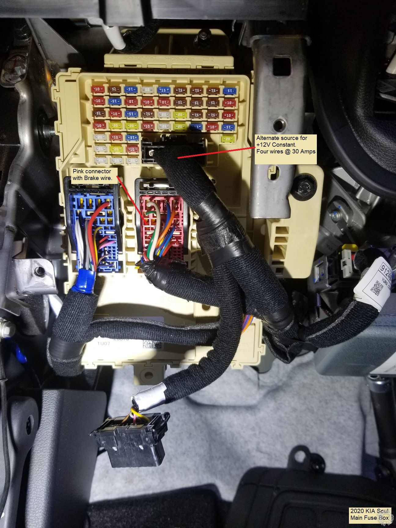

As mentioned above, I went to the main fuse box for +12V constant power. Below is a photo of the four +12V constant power wires. There are 4 available, use any two.

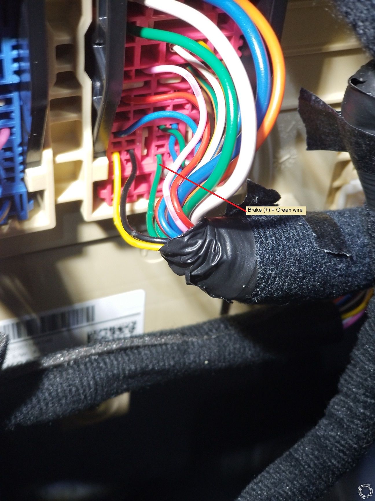

This vehicle did not have a transponder immobilizer system. The iDatalink install guide suggests using the Brake wire found near the transponder wire in the Driver Kick Panel but rather than remove more trim and run a longer wire, I used the Brake wire at the fuse box as shown below.

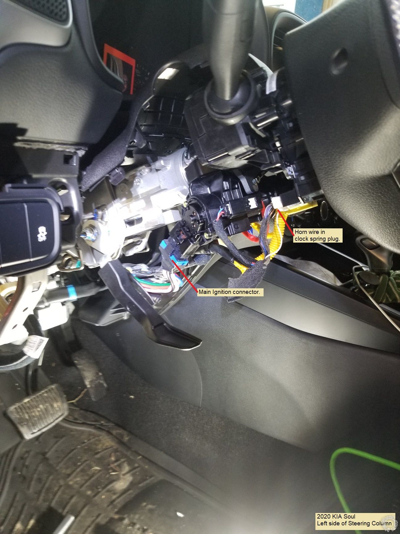

In the steering column are the remaining wires. This is a picture of the left side of the steering column with the horn and ignition wire locations marked.

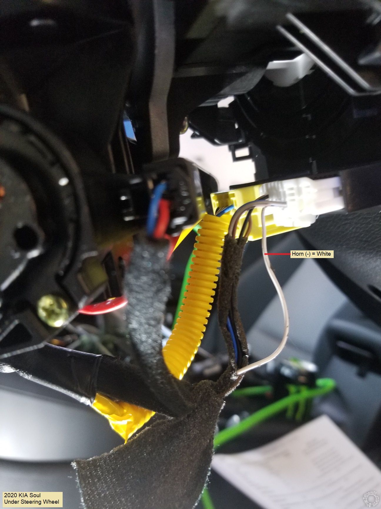

Next is a close up of the horn wire :
Here is shot of the ignition wires.

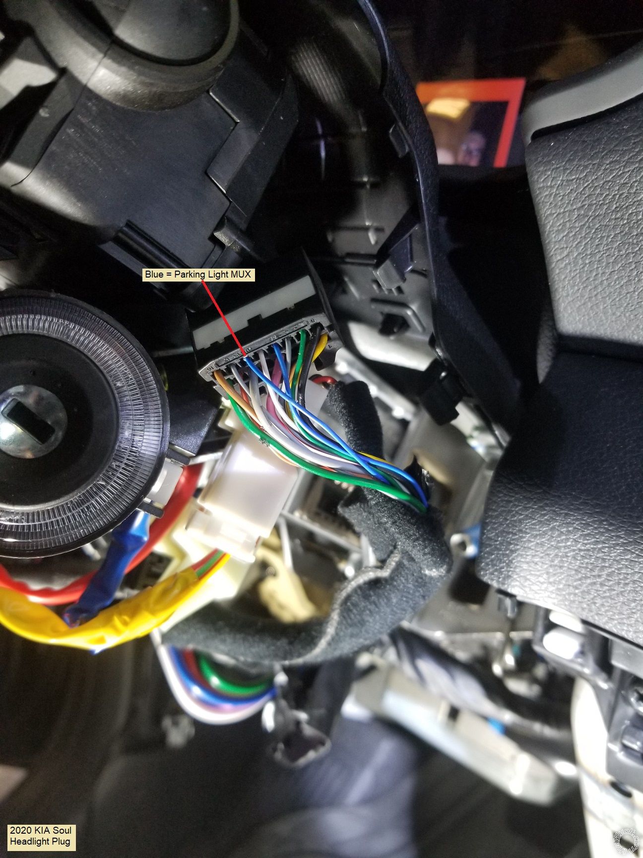

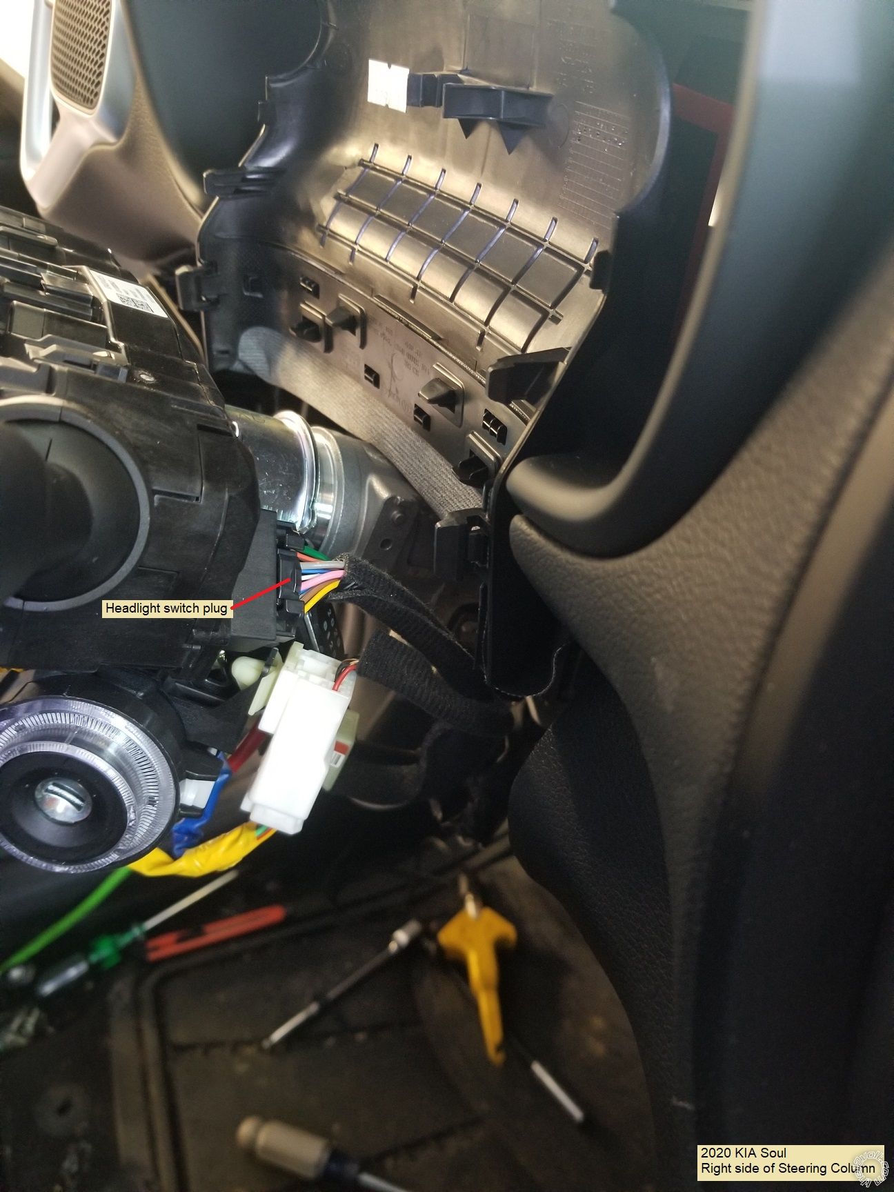

At the right side of the steering column is the Headlight Switch connector. Photo below :
Standard installs require a 1680 ohm resistor on the (-) Parking Light output wire. The Blade-AL produces this signal so no external resistor is needed. Shown below is the Headlight connector unplugged and the Parking Light MUX wire :

Make the Chassis Ground wire connection with a soldered on terminal ring to clean, paint and rust free solid metal.

Pin 9 Light Blue/White - Brake 12V positive (+) input_______________________________________Green at fuse box Pink connector

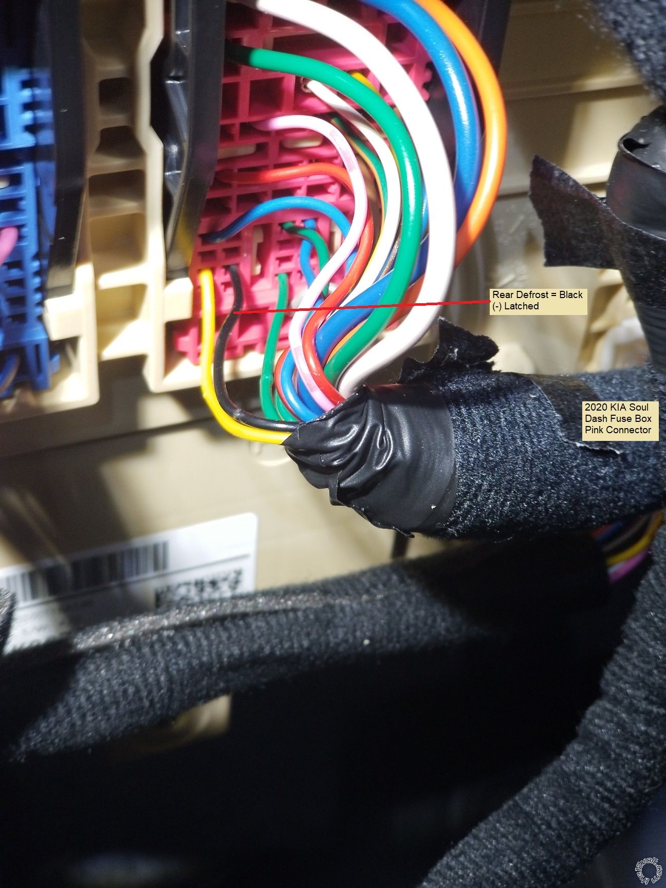

Bonus wire :
With the CM900-s and the OP-500 Programmer, you can reassign one of the unused POC wires in CN3 to Rear Defrost ( Value 17 ) and set 3-17 to Option 3 for a 7 minute latched output starting a few seconds after a Remote Startup. If you wanted to get extra fancy, you could get a Compustar FT-TEMP SENSOR THERMISTOR, plug it into the CM900-s port CN7 and set 3-13 to Option 2 or 3. This will turn on the rear defroster only if the temperature is below the set temp during a R/S.

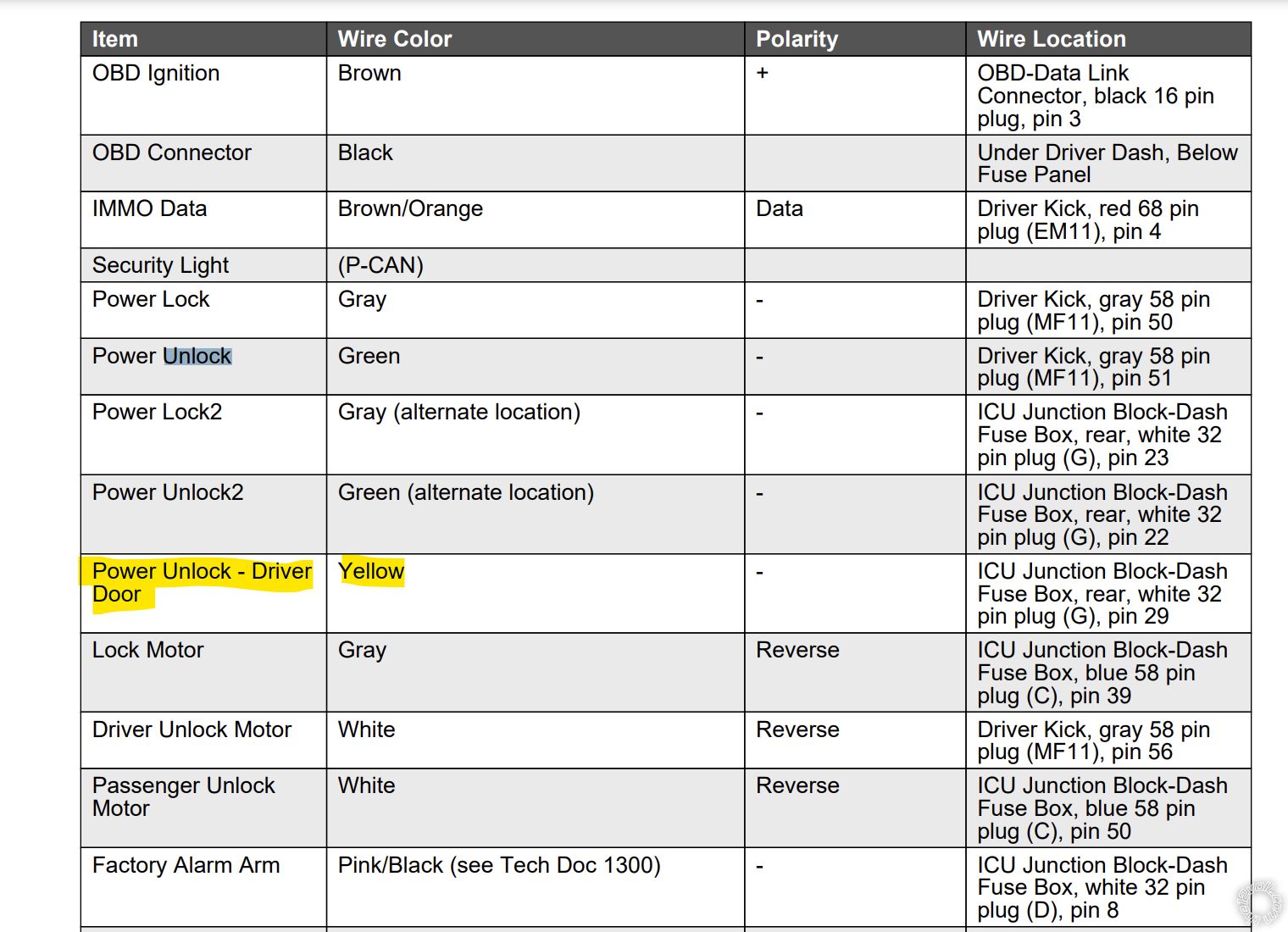

So Im looking over this newly received PDF for direct wire for this generation of vehicles and Im guessing that:
Power Unlock - Driver Door
Yellow - ICU Junction Block-Dash
Fuse Box, rear, white 32
pin plug (G), pin 29
may also work out of the box since its negative polarity, but havent tested.
Pulled the info from this PDF:
2021 KIA Soul DirectWire Vehicle Information (PDF)
