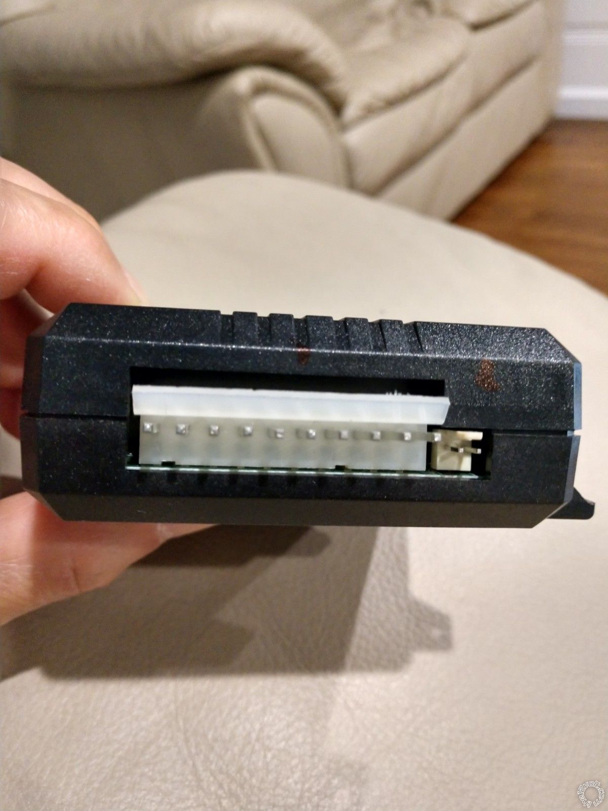

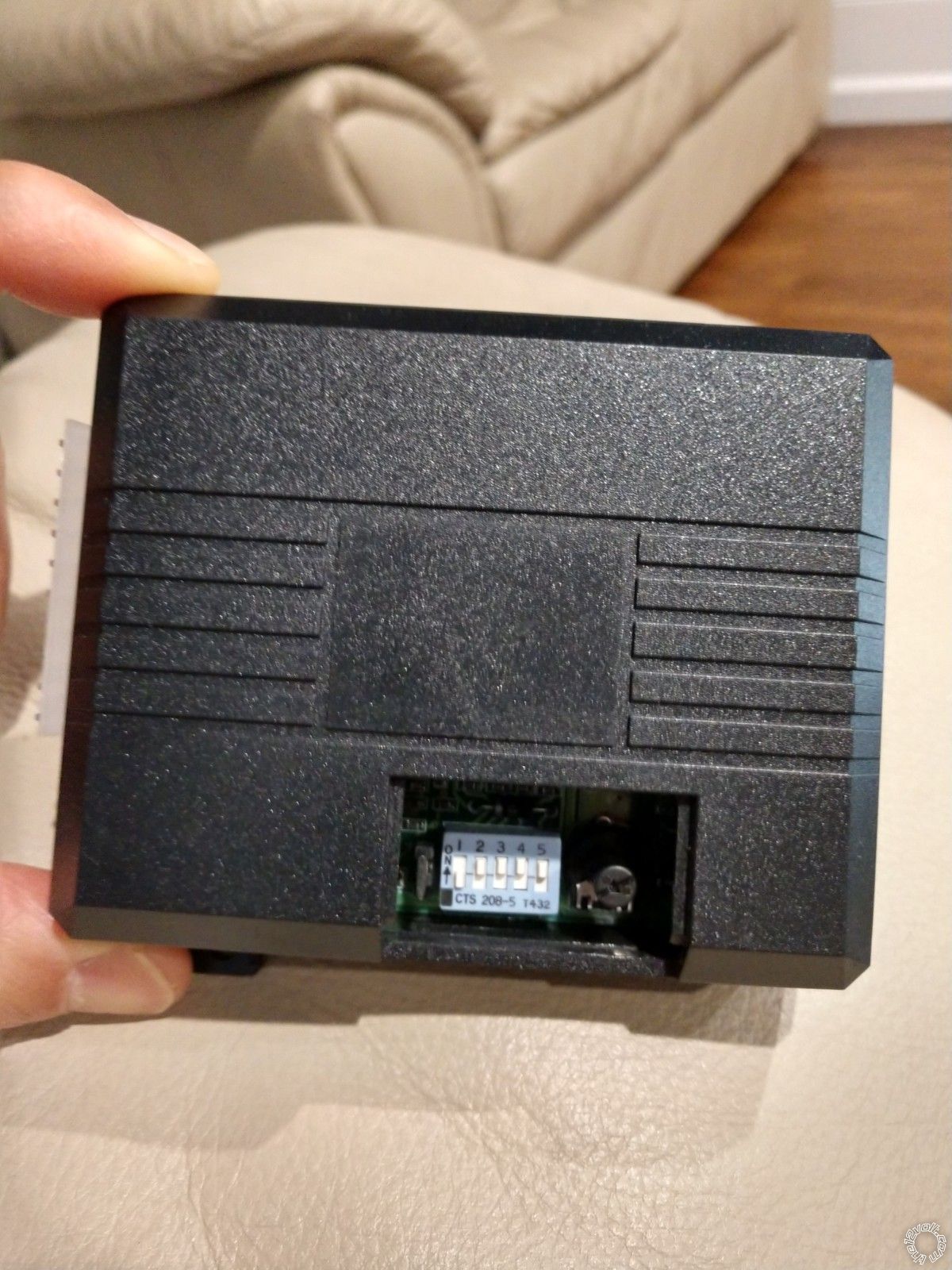

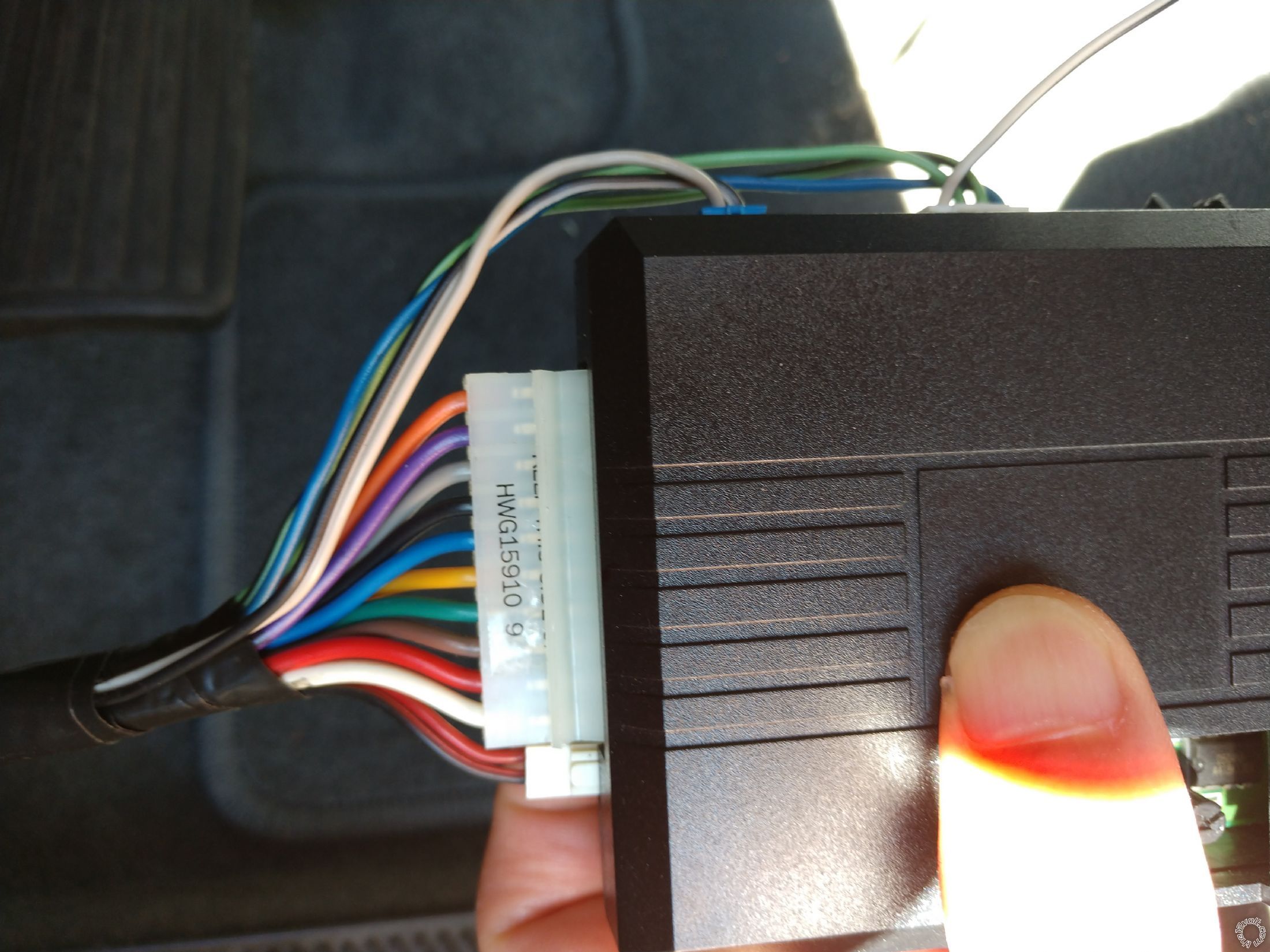

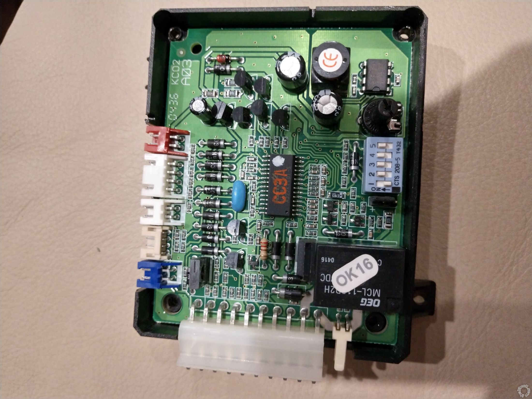

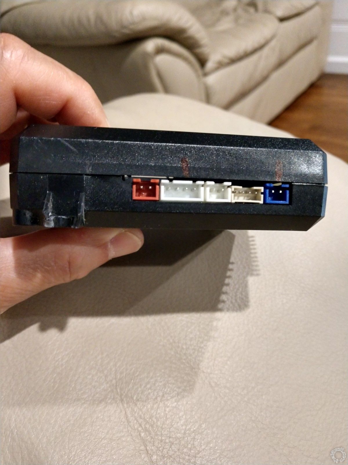

Hi first post. I found this aftermarket alarm that was installed by the dealer on my 2007 Honda Accord 4 door. They put a Viper 330V manual in the car but this isn't a viper. The wires in the manual don't match the brain. Very sketchy since I don't even have a guide of which triggers match to the respective led flashes. The car has a factory alarm but they added this one to upcharge the vehicle price. It used to work ok, but now it goes off randomly when the sun hits the car in the morning or afternoon but never at night, thank goodness. I traced every lead and it looks like it is a voltage sensitivity issue. On a test bench, I was able to confirm that when there is a slight (ie. a dome or courtesy light turning on) the alarm triggers. On my bench I just hooked up a small 12v bulb on the power lead and could get the alarm to trigger. I'm assuming this alarm brain monitors voltage changes. I changed the car battery to a brand new one and it's still behaving badly. The alarm only monitors the doors and has a shock sensor. Interestingly, the trunk and hood are not wired. The alarm reports flashes for the last 2 trigger events and 1 flash is the shock sensor and 3 flashes are the doors. The false alarm trigger is 2 flashes and I can replicate it if I turn on the interior lights or the headlamps. None of the alarm wires go to any lights. There was one wire that flashed the parking lights but I cut that wire and it still false alarms. I don't see any bulging capacitors or issues on the alarm brain board.
The alarm uses the factory key and it arms and disarms through the door lock/unlock wires. The immobilizer works fine. Other than that, it has 12v power, ground, ignition, siren, led and valet button leads only connected. I'm also stumped because when I removed the alarm for testing on my bench, I can't get the factory alarm to work. I verified the dash light for the factory alarm works through the Honda diagnostic test which flashes all the indicators on the dash. I checked the driver side door switch and don't see anything that was modified there. Under the dash, everything was t-tapped so nothing going on there. Obviously, I'm missing something but you guys must have a better idea.
So I'm stumped and want to either adjust (dip switch setting?) the aftermarket alarm's voltage sensitivity which I can't find any information on or get the factory alarm reinstated. Thoughts?
