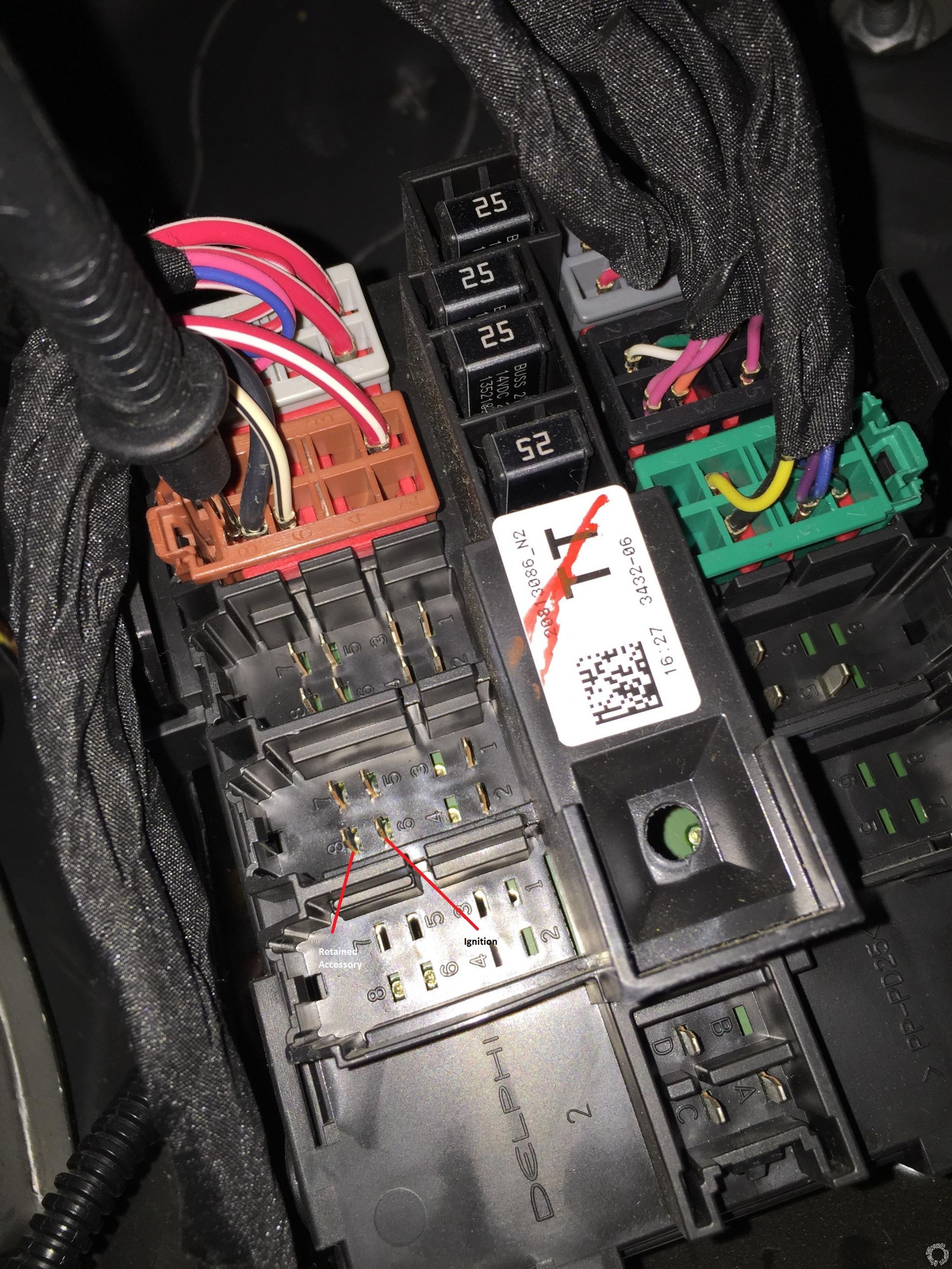

2009 GMC Sierra 1500, Stereo Harness Recommendation  -- posted image.
This is a picture of the junction block just to the left of your brake pedal.
Notice the bottom left slot has no pins in it. The slot just above that is populated with several pins. Pin 8 is retained accessory. If you for some other reason need an ignition source that goes on and off with the key, pin 6.
The bundle of red wire that comes with the above mentioned harness has the proper connector on it already, and it will reach to the radio cavity of that vehicle.

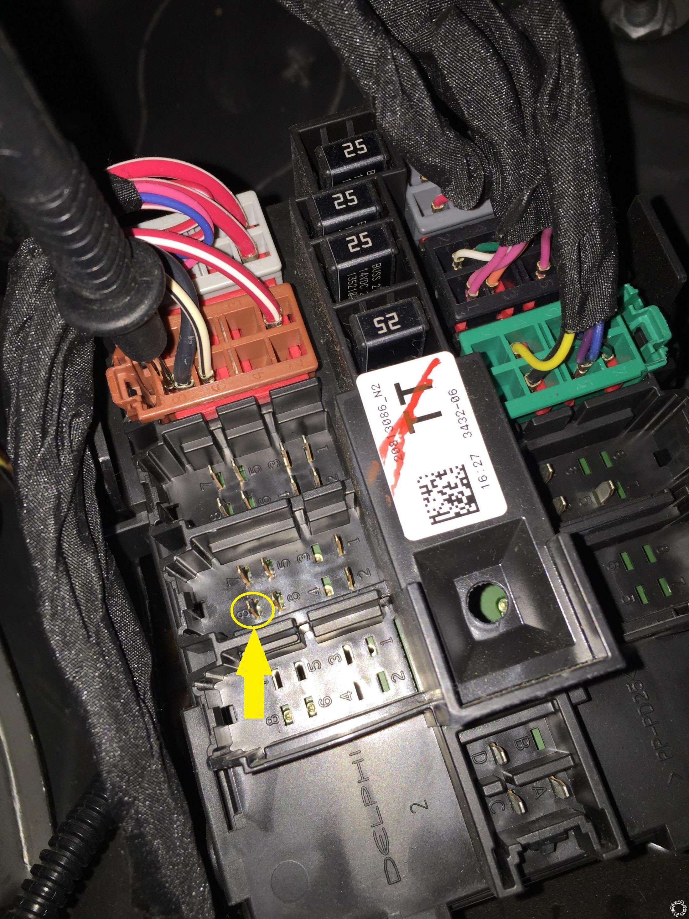

So this one?
Platinum - Posts: 13,723
Posted: May 05, 2021 at 7:48 PM / IP Logged Link to Post Post Reply Quote i am an idiot
