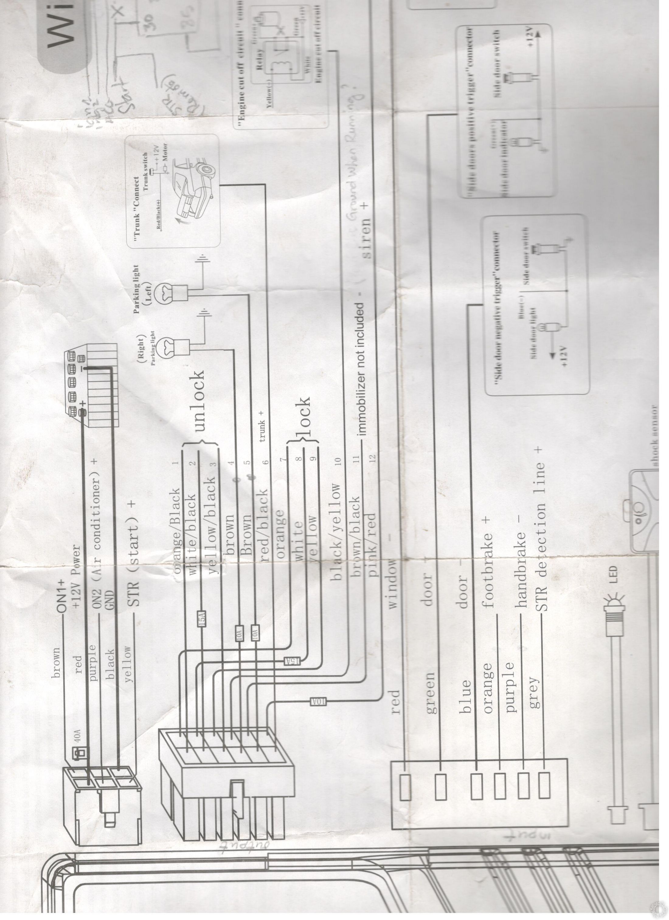

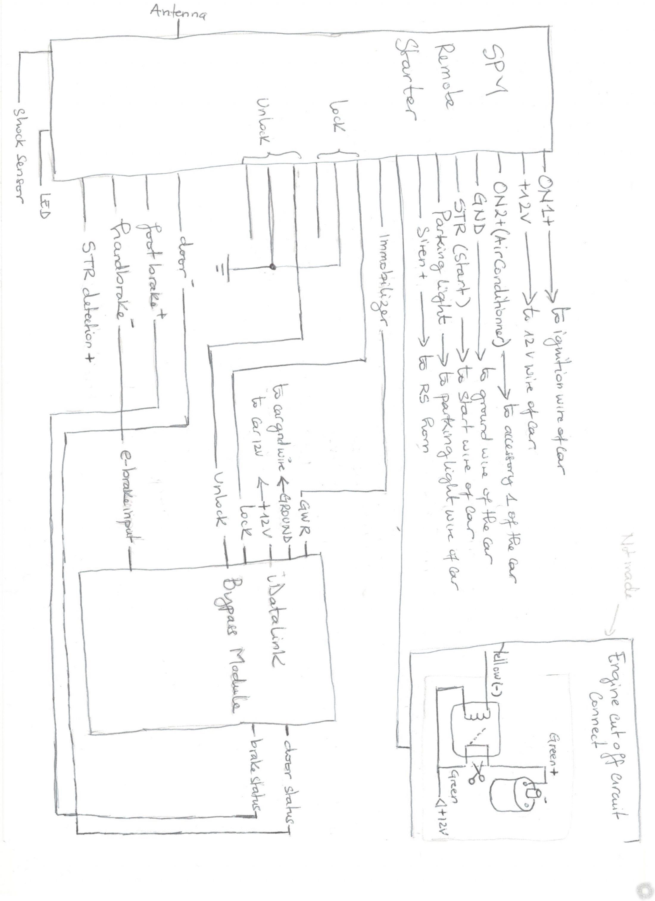

I have try put the key to "ON" and try remote start, but the rm siren start chirp. You can find attached image of my wire connection fron/to remote starter only. Note: the "Engine cut off circuit" and "STR detection line +" are not connected. Do you think with the attached image that i have made a mistake?
Thanks.
Spy LQ090C Remote Start and iDatalink, 2009 Nissan Versa -- posted image.
Here is the manual diagram.
