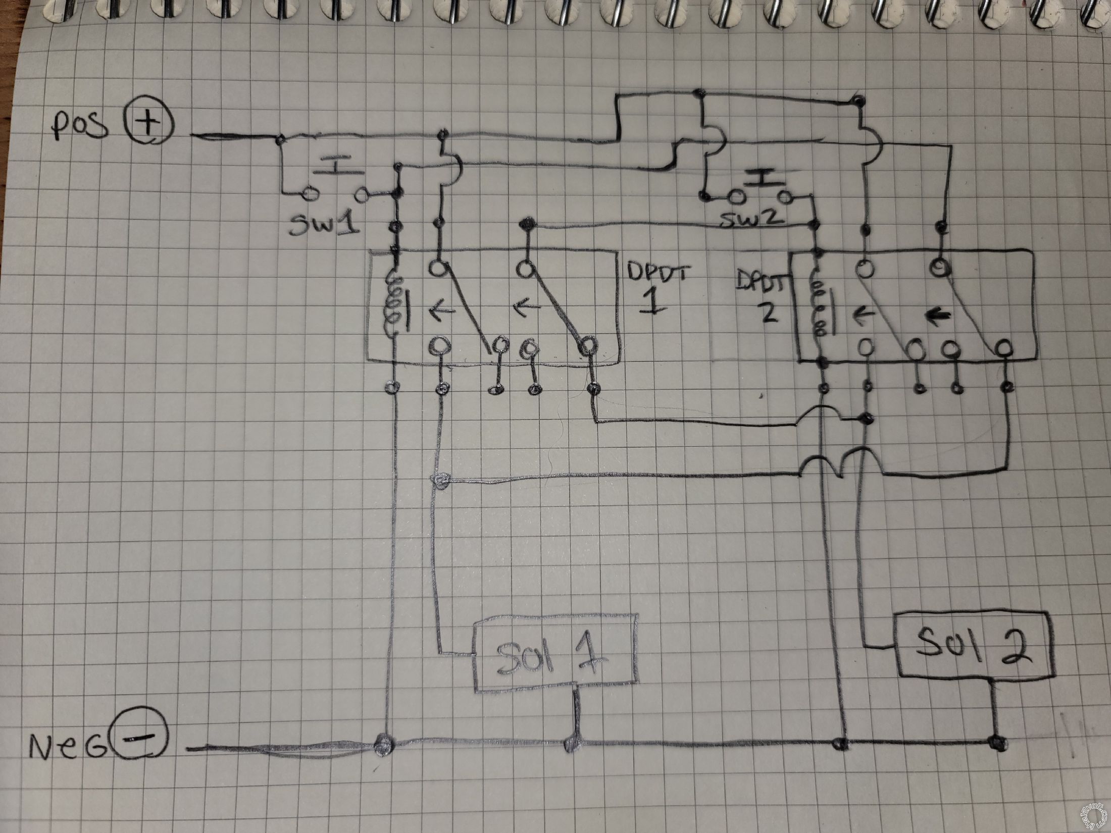

Posted: September 21, 2021 at 8:25 AM / IP Logged Link to Post Post Reply Quote hibrick
3 Solenoids, Only 1 Active At A Time -- posted image.
So I think I figured how to do 2 solenoids and 2 momentary switches. For now I think I have a working plan.

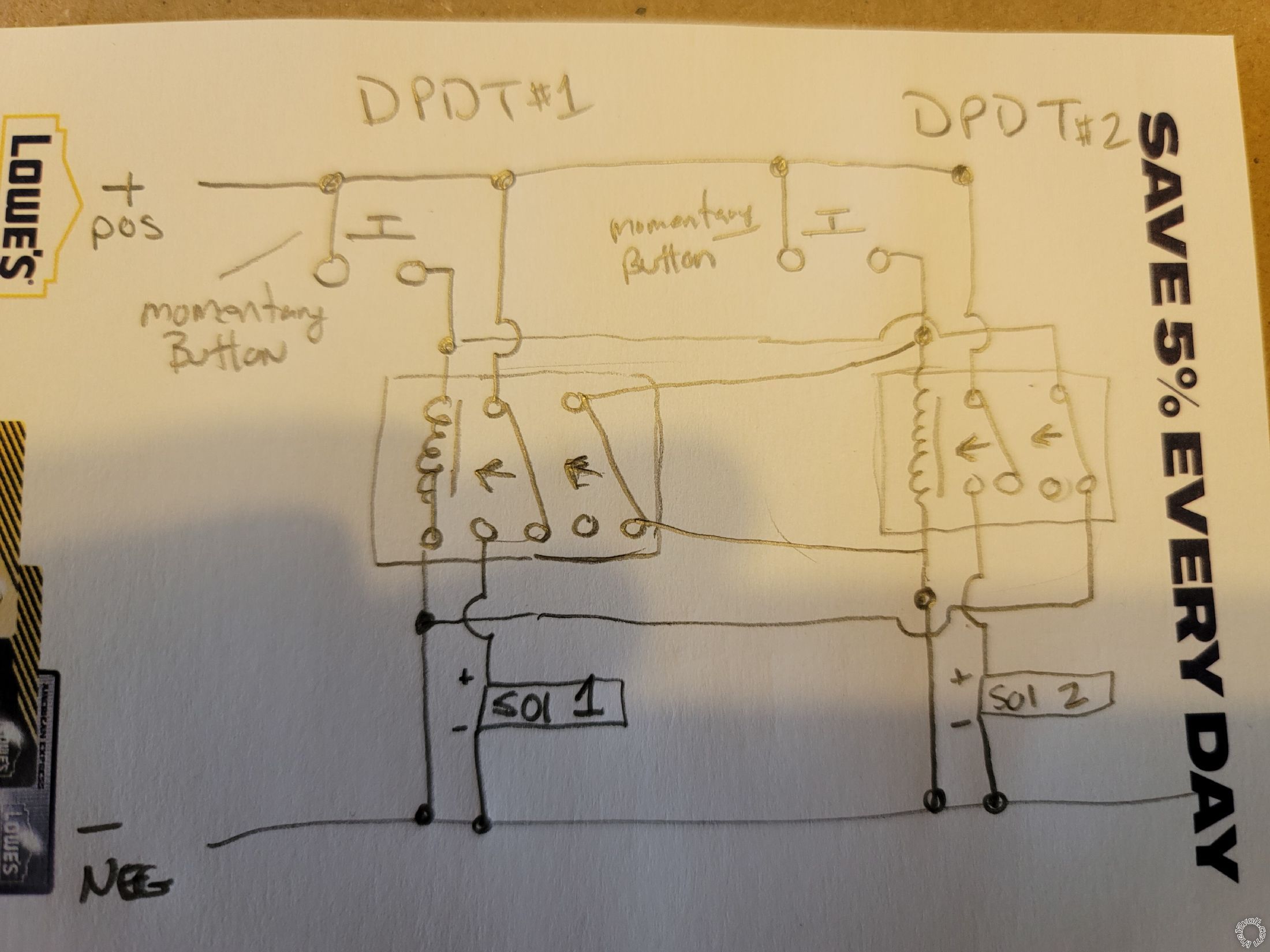

Posted: September 21, 2021 at 6:18 PM / IP Logged Link to Post Post Reply Quote hibrick
So I corrected the previous...3 Solenoids, Only 1 Active At A Time -- posted image.
Worked on my bread board!
