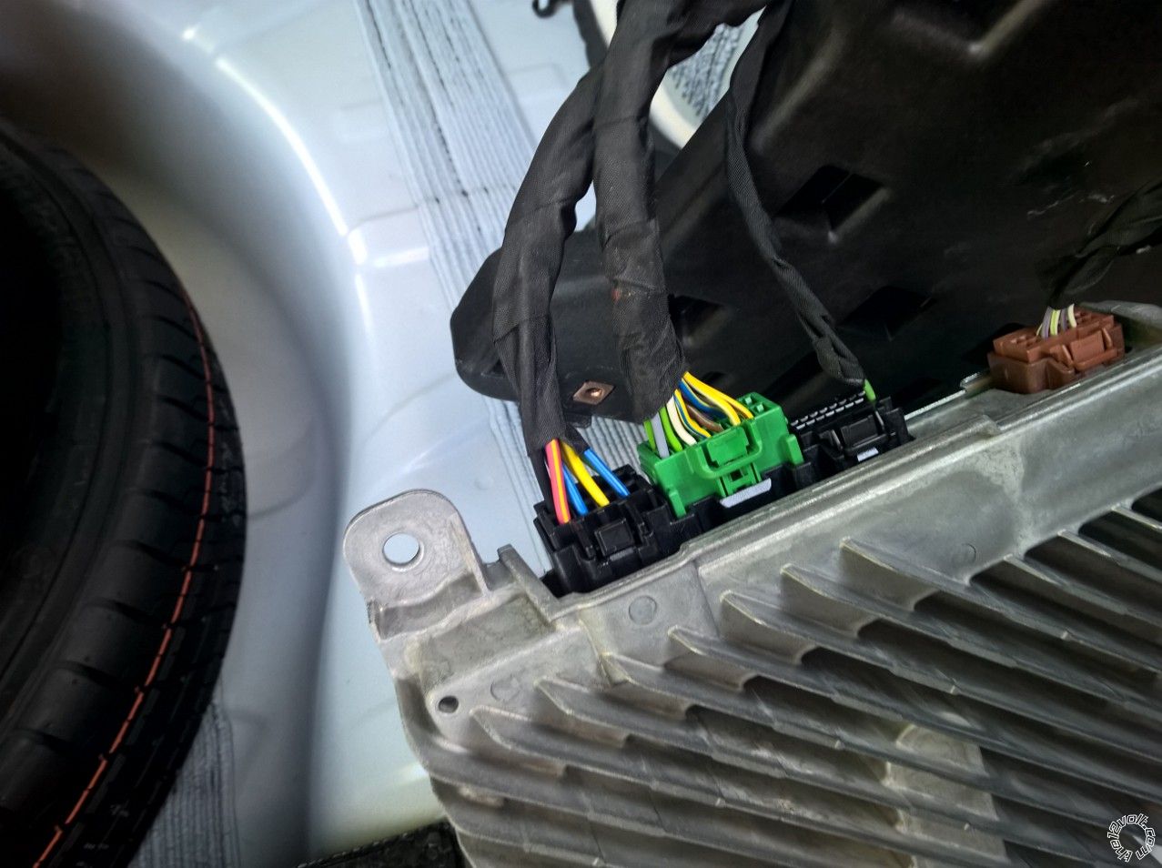

Having the toughest time trying to figure out where did I go wrong... I've been searching for this solution and everyone has a solution but for what I'm dealing with. I recently did a sub/amp add-on and installed a hi/lo converter on the rear speakers at the amp. No after the install, Im not getting sound from the front door speakers. I get sound from the dash and sound from the rear(its low, but there's sound). I've seen the vids where the cut purple/blue wire at the black plug for ANC but i have a BROWN PLUG and I dont have a pur/bl wire. See attached pic... My wire is pur/gry Any help would be appreciated!!! 2014 9th Gen Chevrolet Impala, No Sound After Hi/Lo Install -- posted image.

Posted: December 26, 2021 at 9:14 AM / IP Logged Link to Post Post Reply Quote i am an idiot
Did you unmount the amplifier. I am pretty sure it gets ground through the chassis of the amplifier.

Posted: December 26, 2021 at 11:53 AM / IP Logged Link to Post Post Reply Quote impala706
This was a random google pic showing the color plug that I have...
