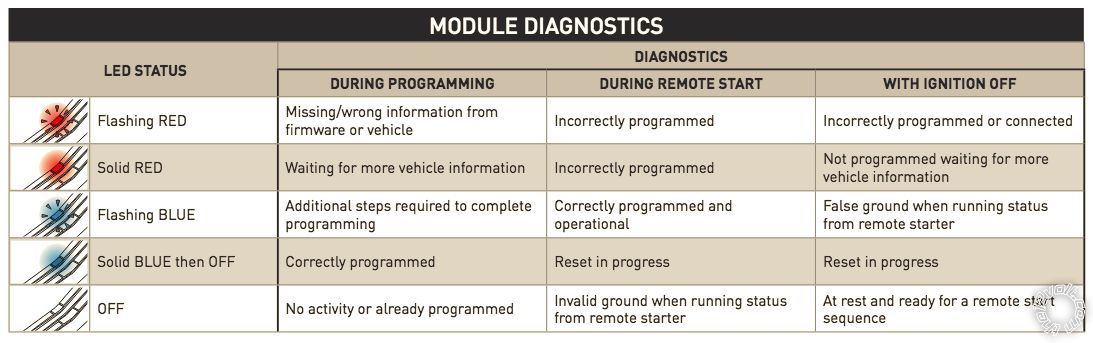

Has anyone ran into an issue when installing a remote starter where when you attempt to remote start the car the display says no key found? I installed an Prestige 57TM with an FLCART. The programming sequence when through fine, but the car won't start. I had a similar issue with an 2012 Nissan Altima. I double and triple checked my wiring. The only thing that i noticed was that the instructions ask to use "keyfob1", but I don't know how to tell if the fob im using is keyfob1 and it's the customers only fob.

What does the FLCART LED status show when you attempt to remote start the car?
2019 Nissan Sentra PTS, Remote Start -- posted image.

are you brake lights coming before it attempts to remote start ?

I'm not too sure on the brake light - I'll check it this weekend. Someone else told me that if the Nissan Fob battery is low it can cause issues while programming

So I found that their are two brake switches and I was wired to the wrong one. The customer is bringing his car in Saturday - hopefully switching to the "top" brake switch fixes the issue.
