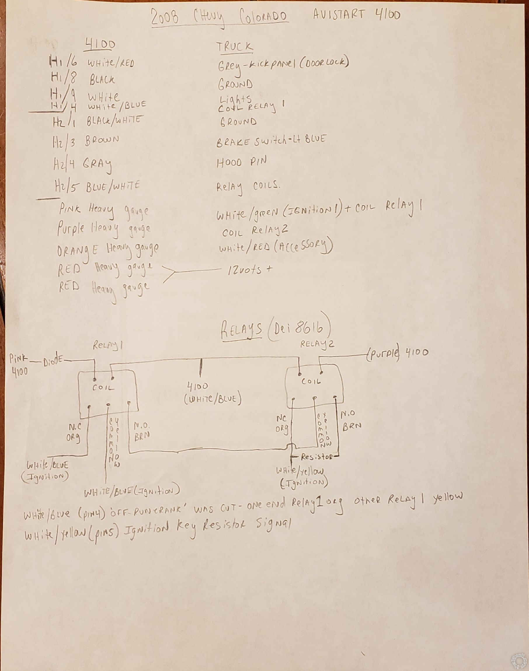

Working on a 2008 Chevy Colorado which already had a working remote start installed for many years. The ignition switch failed which contains the passlock resistor. Now the resistor for the remote start needs changing due to the different value.
What is the procedure to obtain the resistance of the passlock resistor so I can change it to match?
Thank you for your help and support.

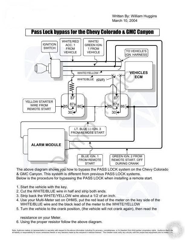

Think I found my answer.
2008 Chevrolet Colorado, Passlock -- posted image.
