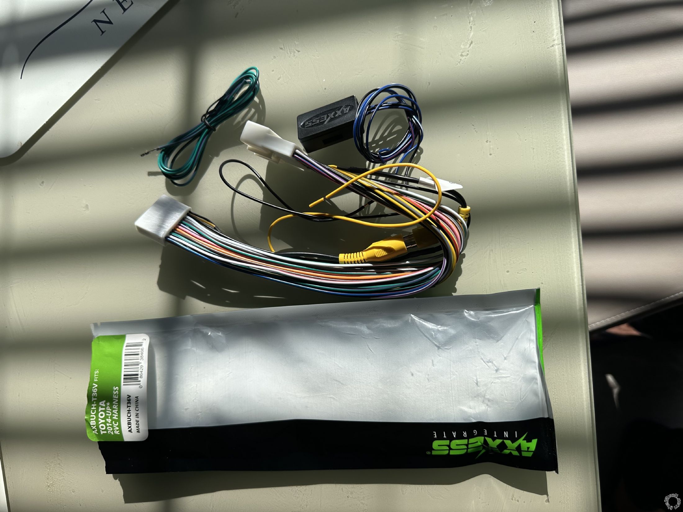

Posted: November 29, 2022 at 12:50 PM / IP Logged Link to Post Post Reply Quote tthaitd
These are what i have:
2015 Toyota Tacoma, Factory Back Up Camera -- posted image.
Are they right one? Thanks

Anyone please. Thanks
