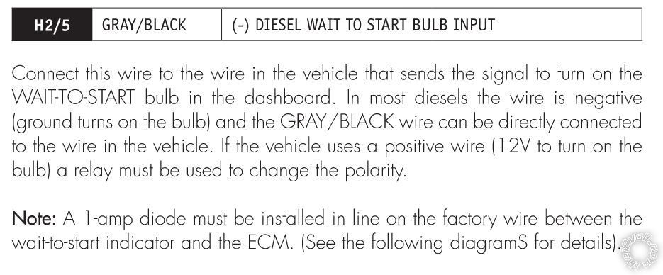

3. I have a Holley EFI installed and Holley suggested waiting about ~5-10 seconds for the LCD screen to come on before cranking. Is there some way I can program the viper to turn on the accessory power, then wait a few seconds before cranking? I know there is a tie in for diesel wait-to-start signals, I am wondering if there is some way I can use this input but not exactly sure how I would do that.

3. Menu 3-7 should power up the accessory wire during diesel wait to start. So the actual wait to start wire won't need to be connected but the feature should be on and the minimum setting which appears to be 15 seconds.
