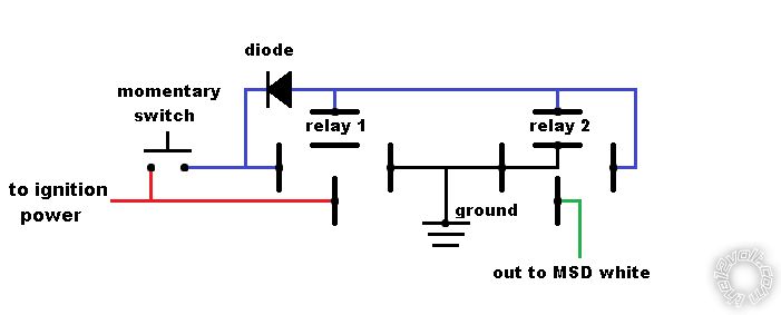

How do I wire a 30a relay to get it to latch non-ground when a momentary switch is held down? I would like it to be normally grounded because an MSD 6A box will not fire spark if the white wire is grounded. I would like to be able to hold a button down while starting and stay latched non-ground (12v) while the car is running, but reset to ground once I turn the car off. I don't want to have to remember to flip the switch to have security in place. I saw this post from 2003: https://www.the12volt.com/installbay/forum_posts.asp?tid=15762 but it didn't answer my question. I also looked over the relay section of this site, but wasn't sure which one to use. Thank you!

Try this:
MSD 6A Killswitch, Latching Relay? -- posted image.

Thanks! I'll give it a shot.
