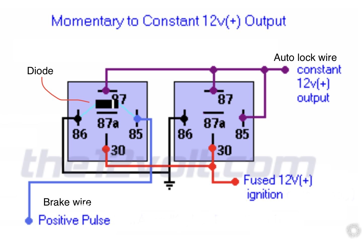

Perhaps you could trigger it from the foot brake? When you get in the car, you typically don't need to touch the brake but when you shift into any gear you would. It may be suitable for mimicking the timing that you are looking for. Maybe a relay setup that sends 1 pulse until the circuit is reset.

Only thing is it needs a constant 12v. The wire it uses is 12v ignition.

Posted: April 06, 2023 at 2:59 PM / IP Logged Link to Post Post Reply Quote iskidoo
iskidoo
Silver - Posts: 1,046
Joined: December 08, 2002
Posted: April 06, 2023 at 3:40 PM / IP Logged Link to Post Post Reply Quote iskidoo
Avital 2101L, Auto Lock In Drive, 2014 Toyota Tacoma -- posted image.
Steve G
kingz97
Joined: April 04, 2023
Posted: April 07, 2023 at 10:29 AM / IP Logged Link to Post Post Reply Quote kingz97
hmm interesting.. might need to try that.
Thank You
