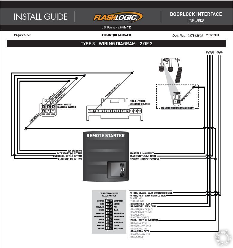

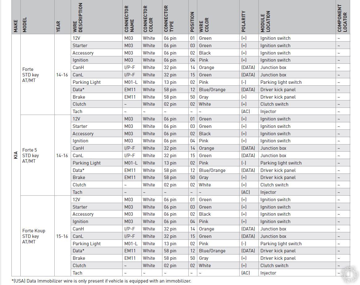

Looking for information on installing a Compustar CM-X with the Blade AL and DAS Sensor.
I can find all the wires needed in the vehicle but I'm not sure where they connect to the CM-X.
I have the ignition wires (High Current) but I don't see anywhere to connect the PARKING LIGHT (-) OUTPUT, STARTER 2 (+) OUTPUT.
Thanks in advance for any help.

The CM-X is a nice unit but for your application you will need to change several programming options.
First a question. You said 2014 KIA Forte Koup? While I was able to select a 2014 through the FirsTech menus, when you open up the Blade AL Install guide it shows only 2015 and 2016 Koup, not a 2014. That could be a slight typo or something important, not sure.   Just strange that they don't list a 2014. As long as all the listed wire colors and locations are the same, you should be OK.
Next, the install guide you posted is for a FLCART not the Blade AL cartridge. The install document you should be using is #79127. Probably no differences but...
Anyway, the Blade AL cartridge must be flashed with the correct Blade AL(DL)-HK5 firmware.   If you have the ADS USB cable then you are all set. When you flash the firmware you can check/update the CM-X firmware to the latest version. Most importantly you can make the necessary changes to the CM-X options at that time.
As you noticed, you need a Starter2 output from the CM-X to handle the clutch bypass. You need to change Special Option Group 4, Feature 3 to Option 2 (2nd Start). This will change the CN1 Blue wire at Pin 5 to a Starter type output for use as Starter2 to the clutch bypass.
For the needed (-) Parking Light output, you can re-assign POC #2. It is the White wire at CN4 Pin 3 that is for the Horn output, but with a Siren/Alarm you really don't need it. Change Special Option Group 3, Feature 2 to Option 1 (2nd Light). That will make the White wire a (-) Parking Light output.
Additionally, not shown on the Type 3 Install Diagram are the two fused +12V input wires, Red and Red/White. They both need to be connected to the cars' ignition switch. Use Pin 1 Green and Pin 5 Red, one wire to each. Also, the CN1 Black wire needs to go to a clean, solid chassis ground point. Verify that the vehicle has a factory hood pin for proper R/S and alarm functions to be supplied by the Blade-AL. If the R/S'd engine does not shut down when you pop the hood, install the kit supplied hood pin.

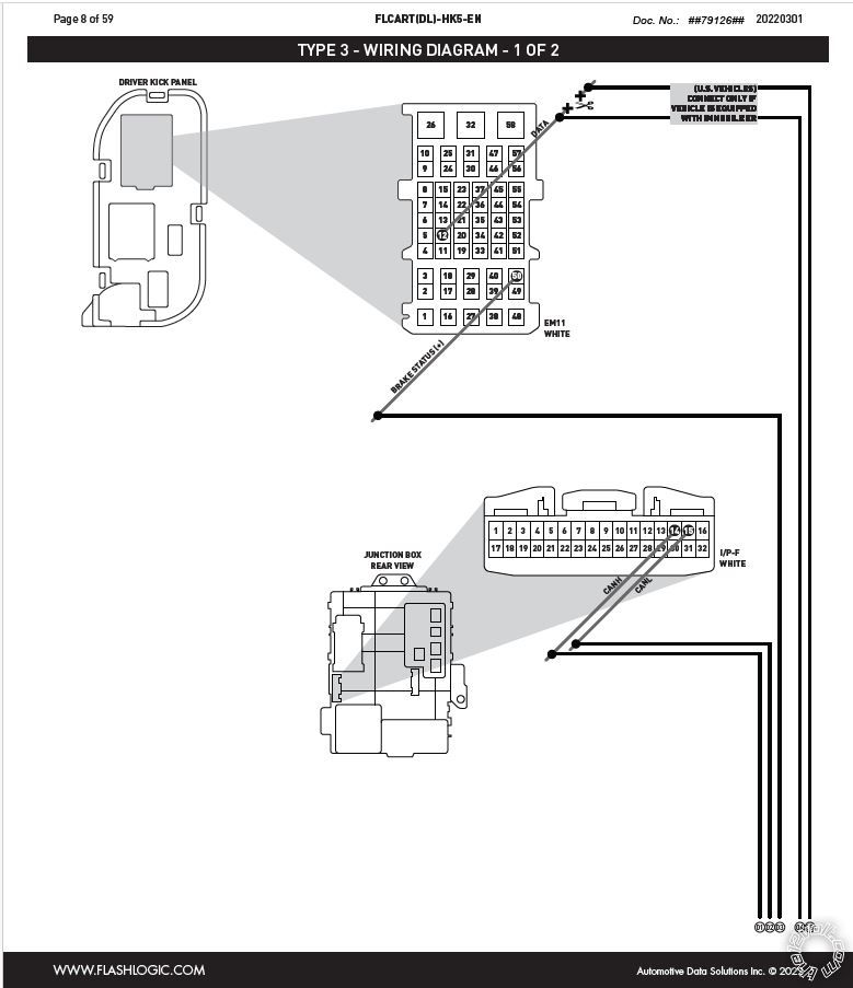

Everything makes sense and I'm in the process of the install but on the 32 pin connector on my fuse panel, I don't have the Can H and Can L. My wiring diagram lists them as (B Can), can I use the Can H and Can L that's on the OBD port instead my wiring diagram calls them (C Can)?
Thanks
aceinny
Member - Posts: 7
Joined: February 05, 2024
Posted: February 09, 2024 at 10:56 PM / IP Logged Link to Post Post Reply Quote aceinny
I found there another 32 in connector on the back of the fuse panel that contains the Cam wires so I'm all set with that. I have all the wires connected that is called for on the Blade AL-HK5-EN wring, plus the tach wire (coil pack to CN4 yellow/black wire. Plus the Black Ground and other 12V+ from CN1 as you described. For the siren, do I use CN15 or CN4 Brown wire #2? Do I need to hook up the siren or will it use the factory car horn? For CN4, The wires I have connected is the Tach In, Foot Brake In, and POC#2 (White Wire for the parking light output. Do any of the other wires need connected? For the Blade CN3 connector, I have the Data connections, Can connectors, Ignition Input, and Data. Do any of those other wires get connected?

Q. For the siren, do I use CN15 or CN4 Brown wire #2?
A. Either will do but if the Siren comes with a 2 Pin harness with a convenient 2 Pin connector, go with CN15.
Q. Do I need to hook up the siren or will it use the factory car horn?
A. The car horn must be controlled directly by the CM-X and you have re-assigned POC#2 for the Parking Lights so use the siren only.
Q. For the Blade CN3 connector, I have the Data connections, Can connectors, Ignition Input, and Data. Do any of those other wires get connected?
A. No, only those shown in the diagram for the 20 Pin Blade harness.
Q. Do any of the other CM-X wires need connected?
A. Not really. The Blade supplies the door and trunk status for the alarm and R/S Reservation Mode. As mentioned above, ensure the vehicle has a functional factory installed Hood Pin.
The last part is connecting CM-X CN4 Pin 6 Light Blue E-Brake wire to the car. Here is that vehicle wire info :
Parking Brake    ORANGE (-)    AT BRAKE SWITCH OR FUSE/SMART JUNCTION BOX WHITE 32 PIN CONNECTOR, PIN 23
This wire is needed for the MT Reservation Mode sequence. Additionally, there are two Reservation Mode programming options that must be set.
See Menu 2-14 and 2-15.
