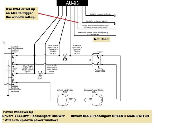

the car will go into reservation mode and remote start with the windows open
Yep. That's one of the reasons a R/S on a MT convertible or some Jeep CJ's is discouraged. While it would require extra parts and wiring, you could do a "total closure" on your Forte Koup.
I don't believe there is a "windows closed" signal so doing "total closure" is the next best solution.
Info below (using Omega AU-93 module) :
2014 Kia Forte Koup, Standard Key, Manual Transmission, Compustar CM-X  - Page 2 -- posted image.
You could use a Directed 529T or similar module.
