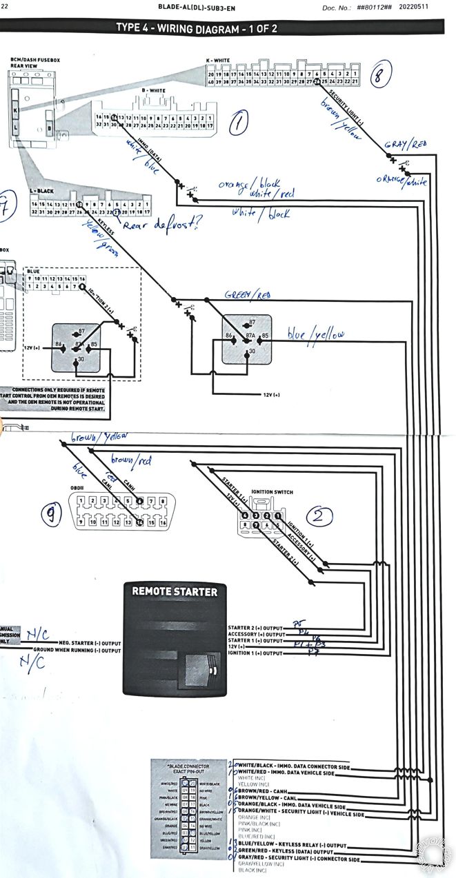

This is the connection(type 4) from the blade install guide.

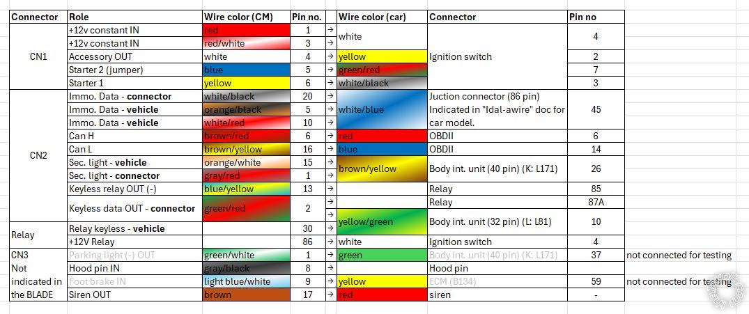

Forgot my reference table.
CN1 = main control module connector to ignition switch
CN2 = blade connector
CN3 = gray connector on control module

Flip your IMMO cut, it's backwards..

Posted: May 22, 2024 at 8:11 PM / IP Logged Link to Post Post Reply Quote waterresistro
Wow,that was the issue!
Thank you so much for your time silvercivicsir!
