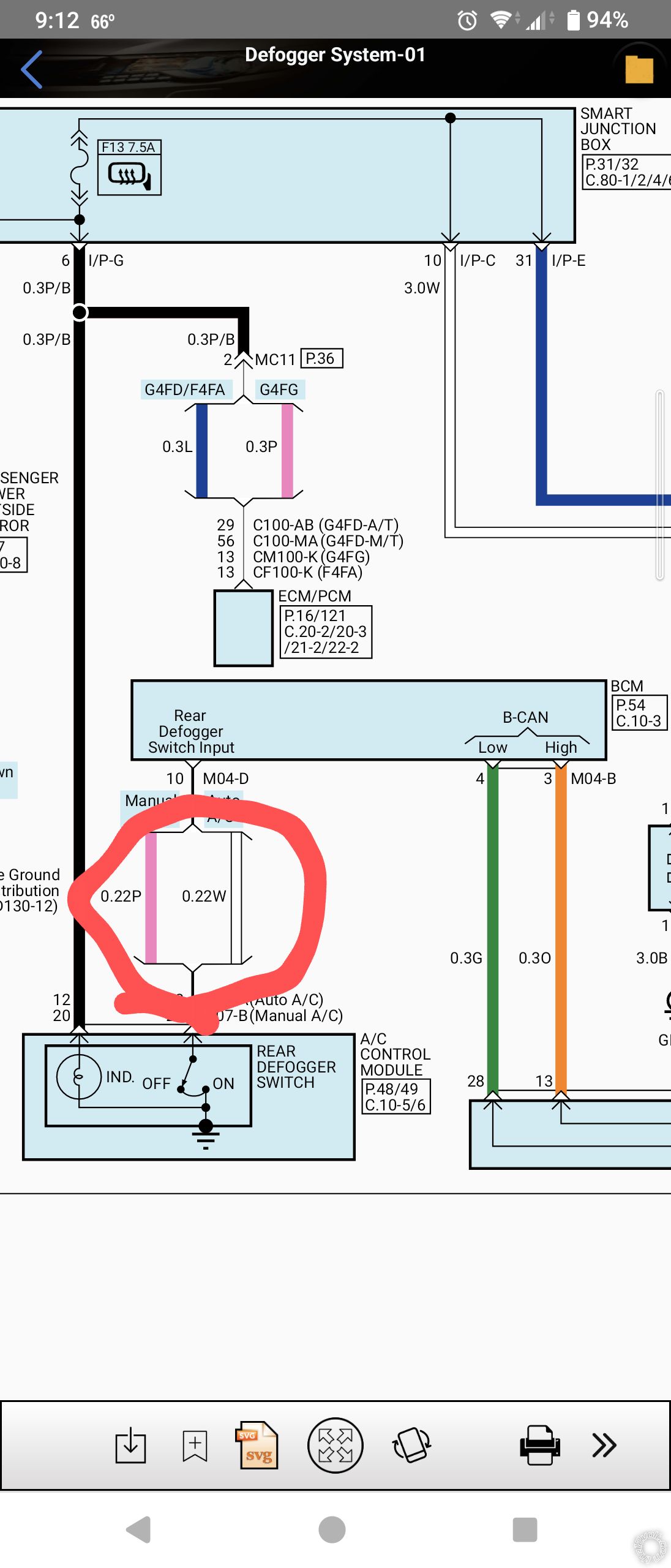

2019 Kia Soul, Rear Defrost Wiring -- posted image.

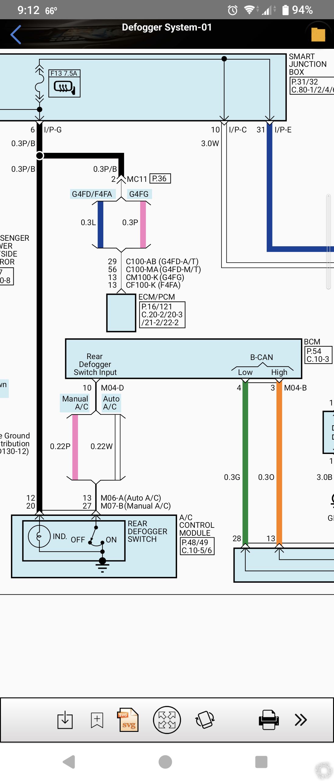

Posted: October 22, 2024 at 1:10 PM / IP Logged Link to Post Post Reply Quote lee.lopez
Not the black wire, that's just power for the indicator light at the switch.
The negative switched wire you want is either pink or white (depending if you have manual or automatic controls) between the rear defrost switch and the BCM. Look at the area in the red circle.

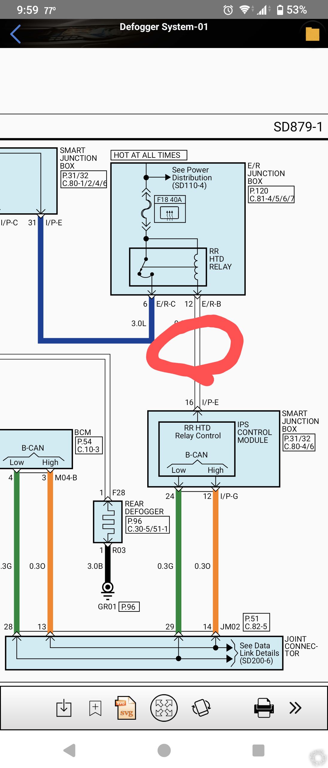

You could also check for the white wire between the E/R Junction Box and the Smart Junction Box.

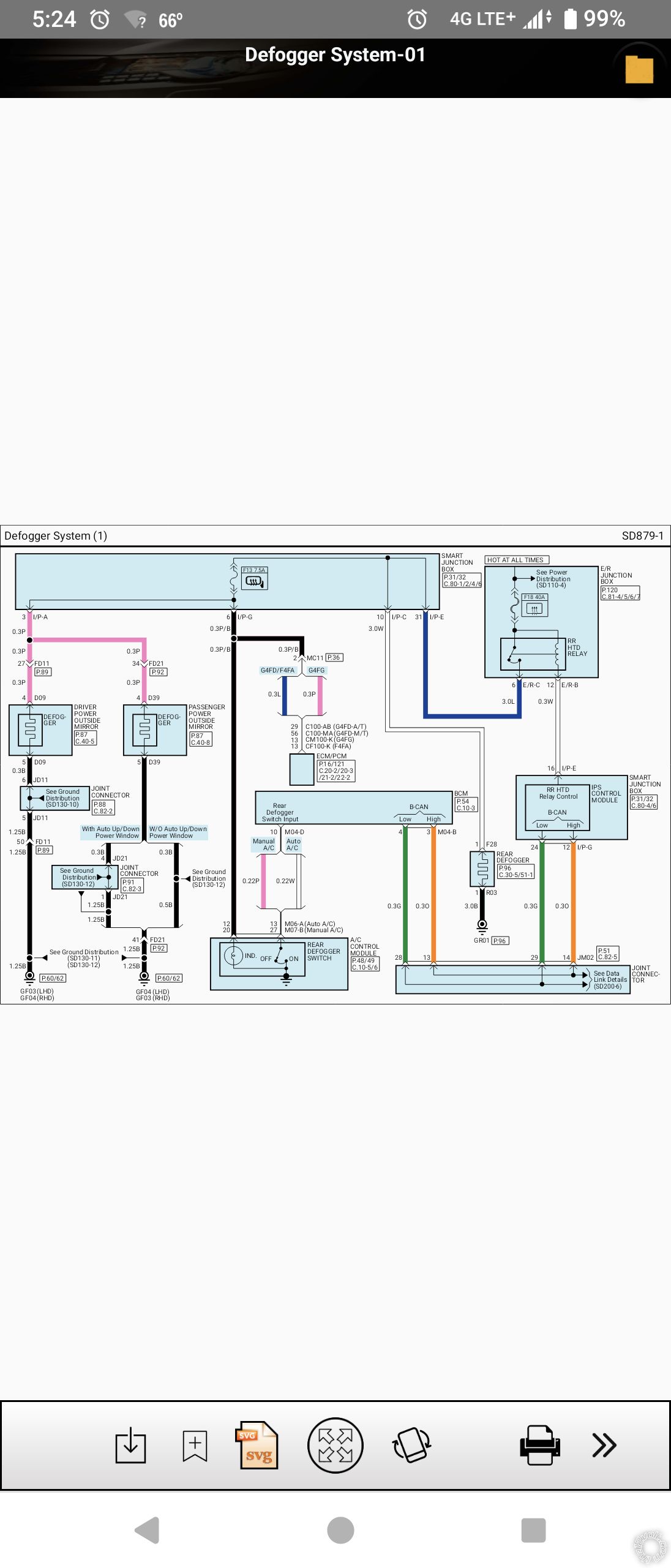

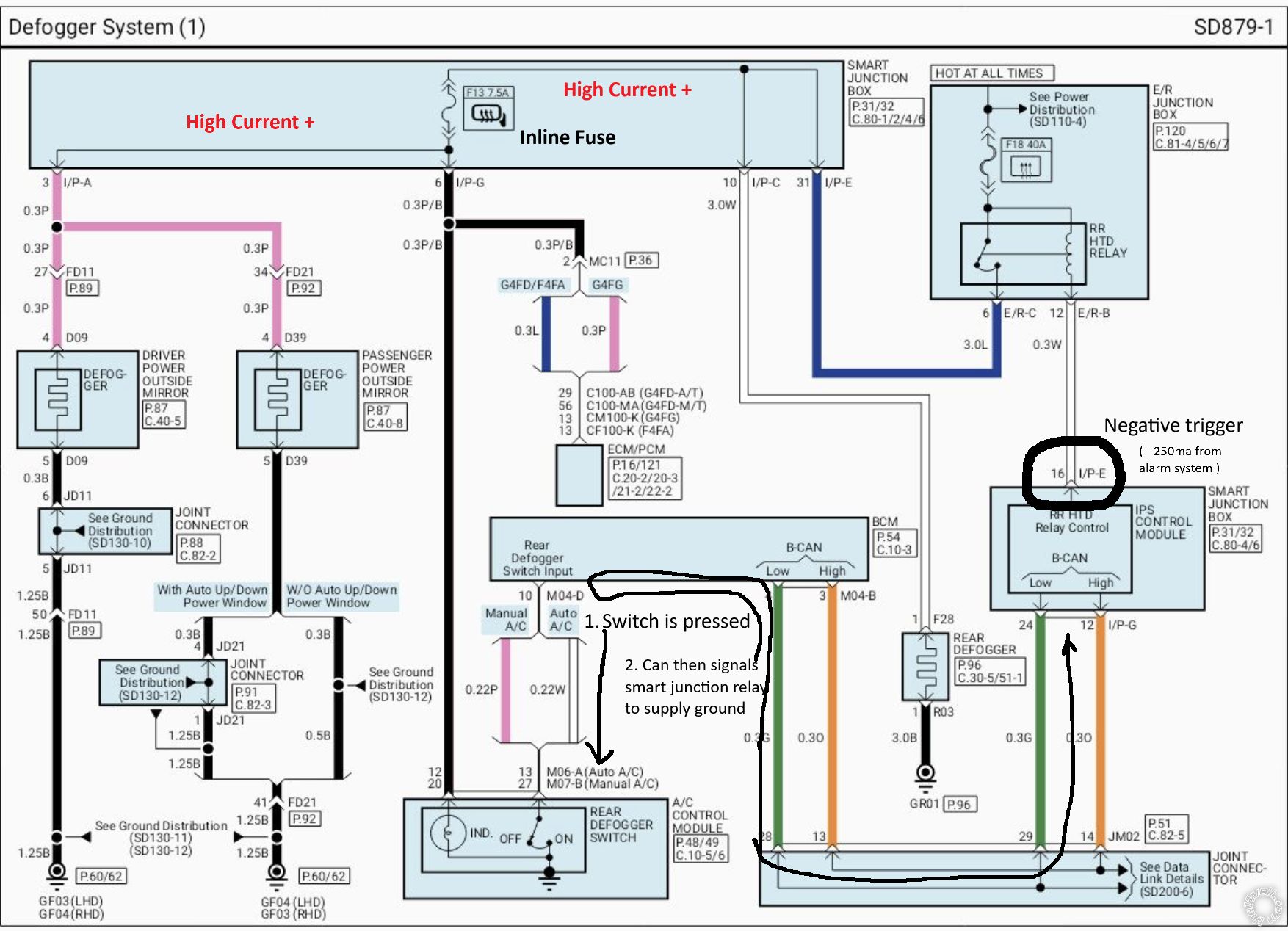

Posted: October 23, 2024 at 6:27 AM / IP Logged Link to Post Post Reply Quote ftb_soup
Thank you!
I think Im reading this right
