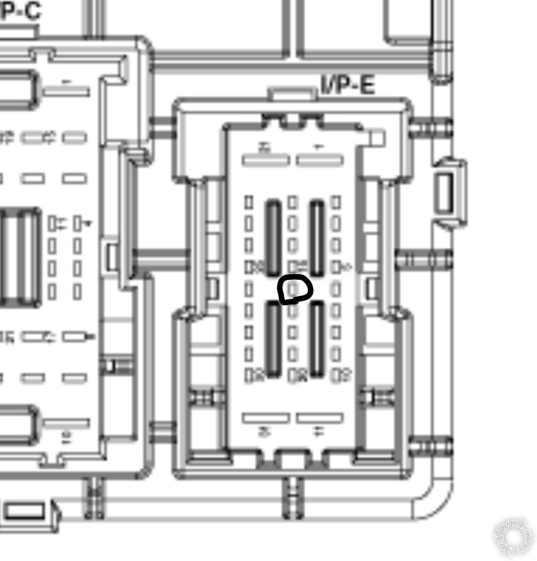

Found it! 2017-2019 2nd gen defrost trigger wire (not sure if 2nd gen 2014-2016 are the same) is in the smart junction box (fuse box lower left of steering wheel)
I/P-E connector, pin 16, White wire

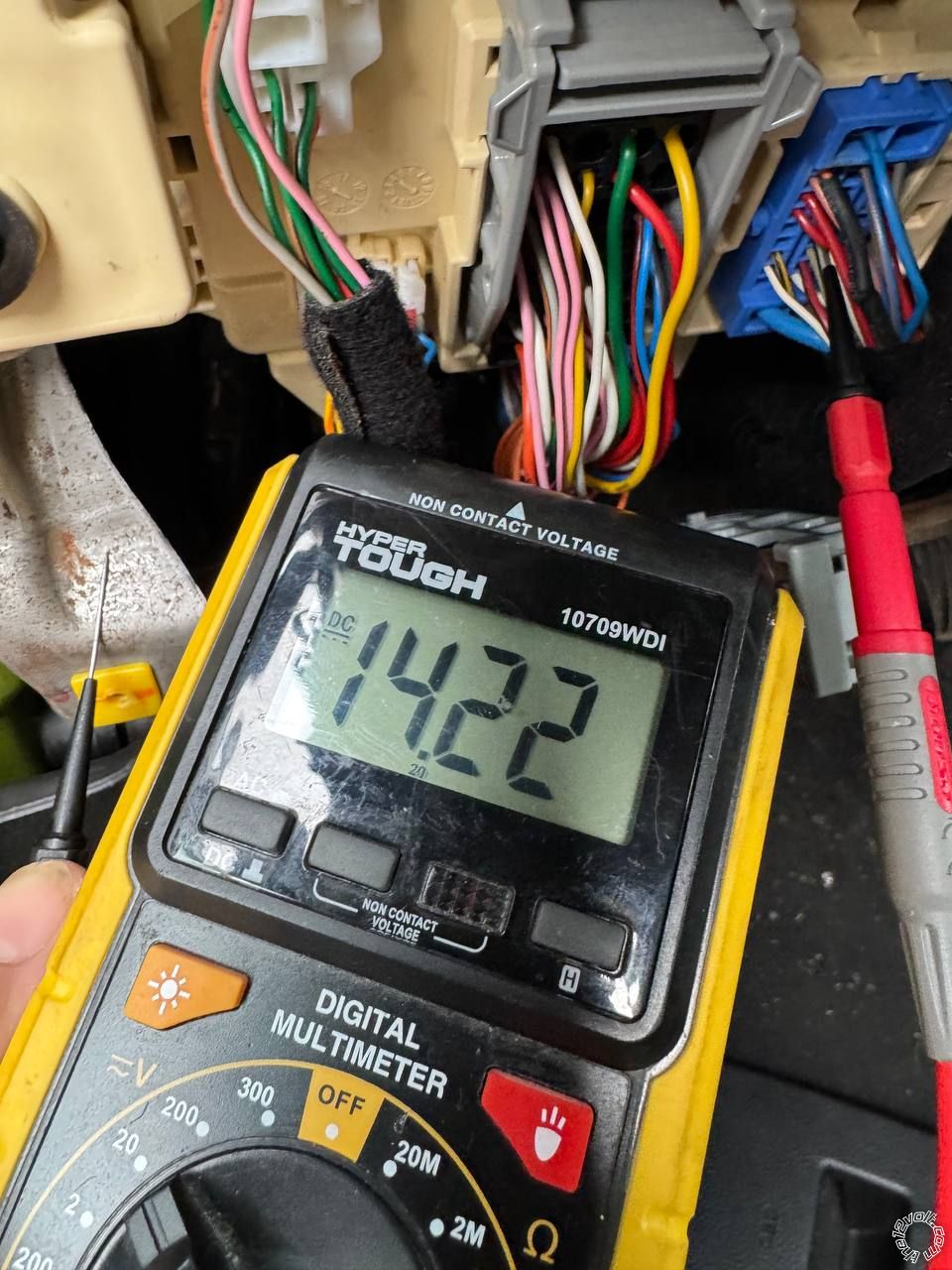

When testing voltage it WILL read 12+ volts with car running and defrost OFF because the multimeter is reading the positive wire that is connected to one side of the relay coil waiting to be triggered with a ground signal.
With defrost ON it will register a very tiny amount, around 0.22 volts

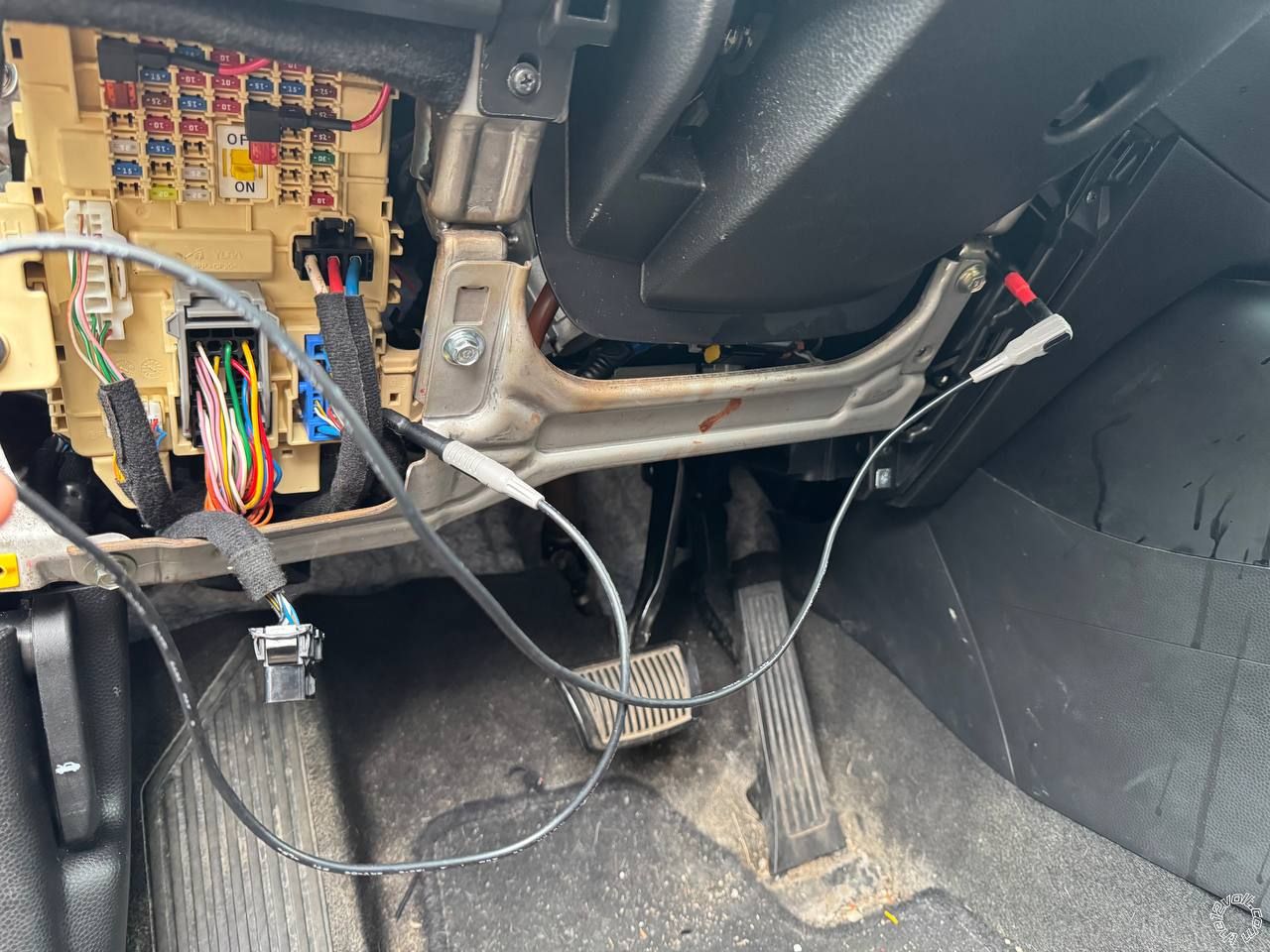

Running pin 16 to ground:
2019 Kia Soul, Rear Defrost Wiring - Page 2 - Last Post -- posted image.
Running pin 16 to ground SUCCESS (heating element did indeed warm up during the testing time):

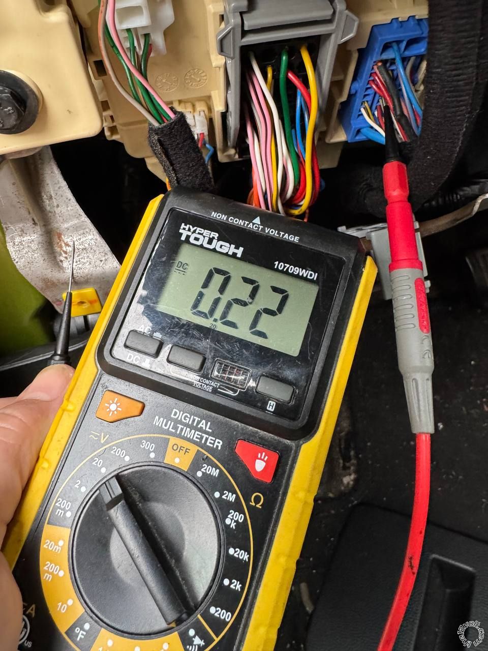

Measuring pin 16 voltage with car on, defrost off (normal reading as you are reading the positive wire on relay coil waiting for ground):
Measuring pin 16 with car on, defrost on:
THANK YOU! lee.lopez for providing me with that diagram. Made all the difference and saved me from testing MANY wires lord knows how many times each.
