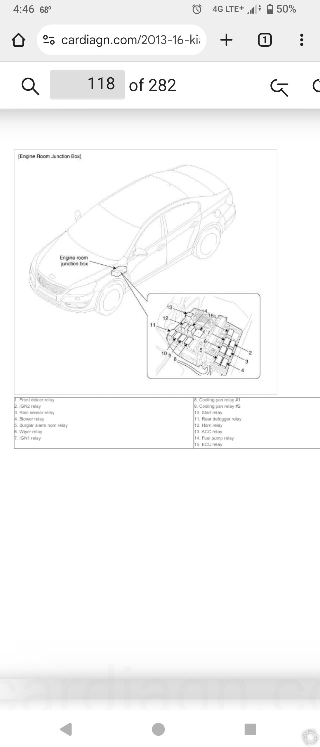

Try pulling relay 11 from under the hood.
2014 Kia Cadenza, Battery Drain -- posted image.

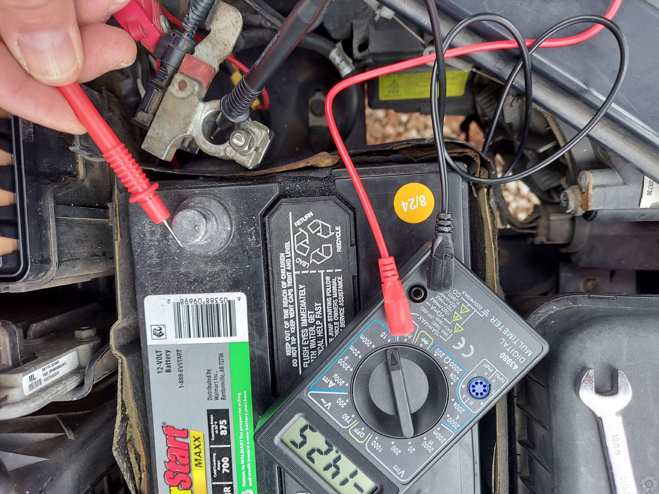

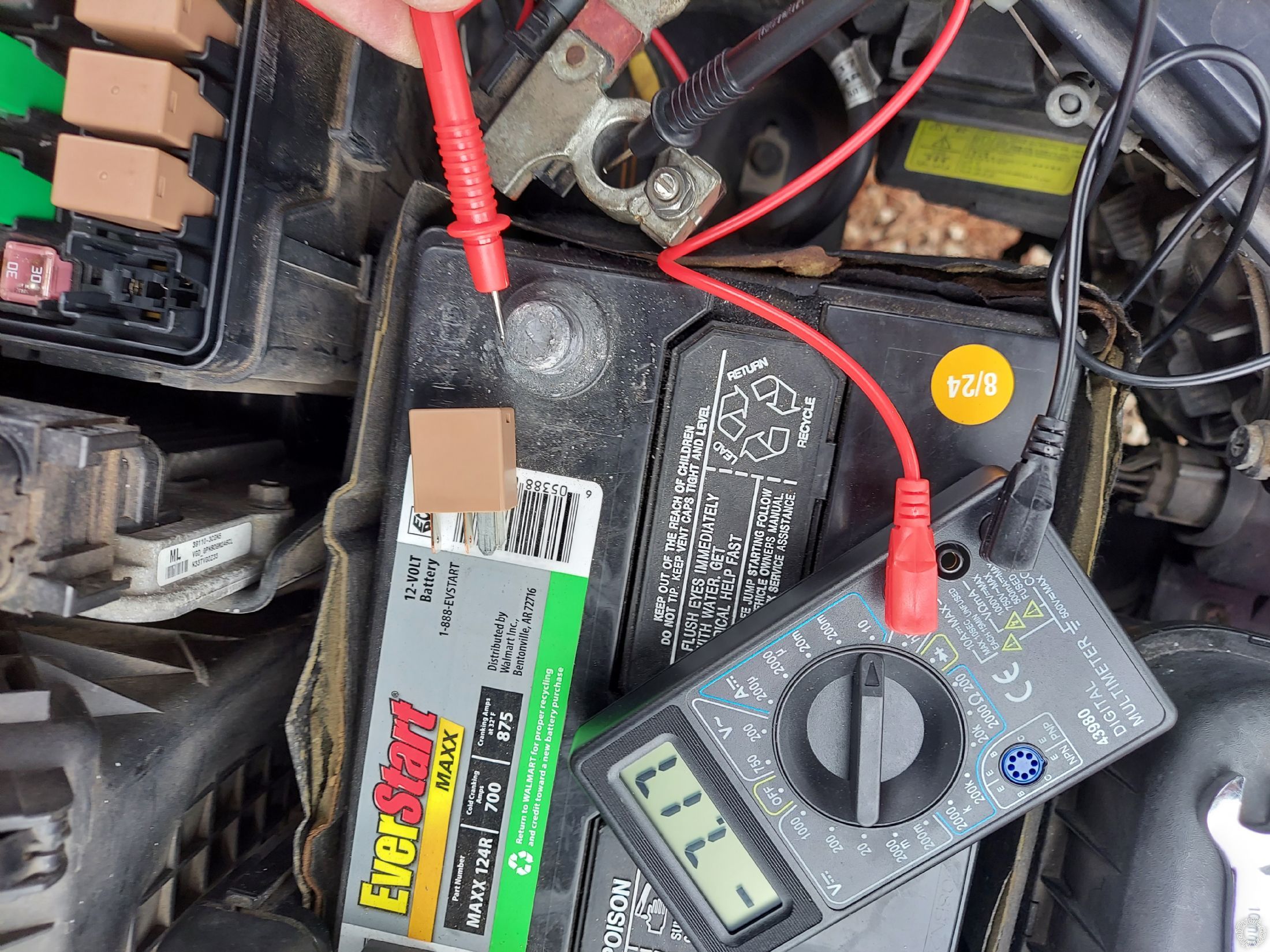

2014 Kia Cadenza, Battery Drain -- posted image. 2014 Kia Cadenza, Battery Drain -- posted image.
Pulled the suggested relay. Drain went from 14 to 7, but still have some sort of Drain.

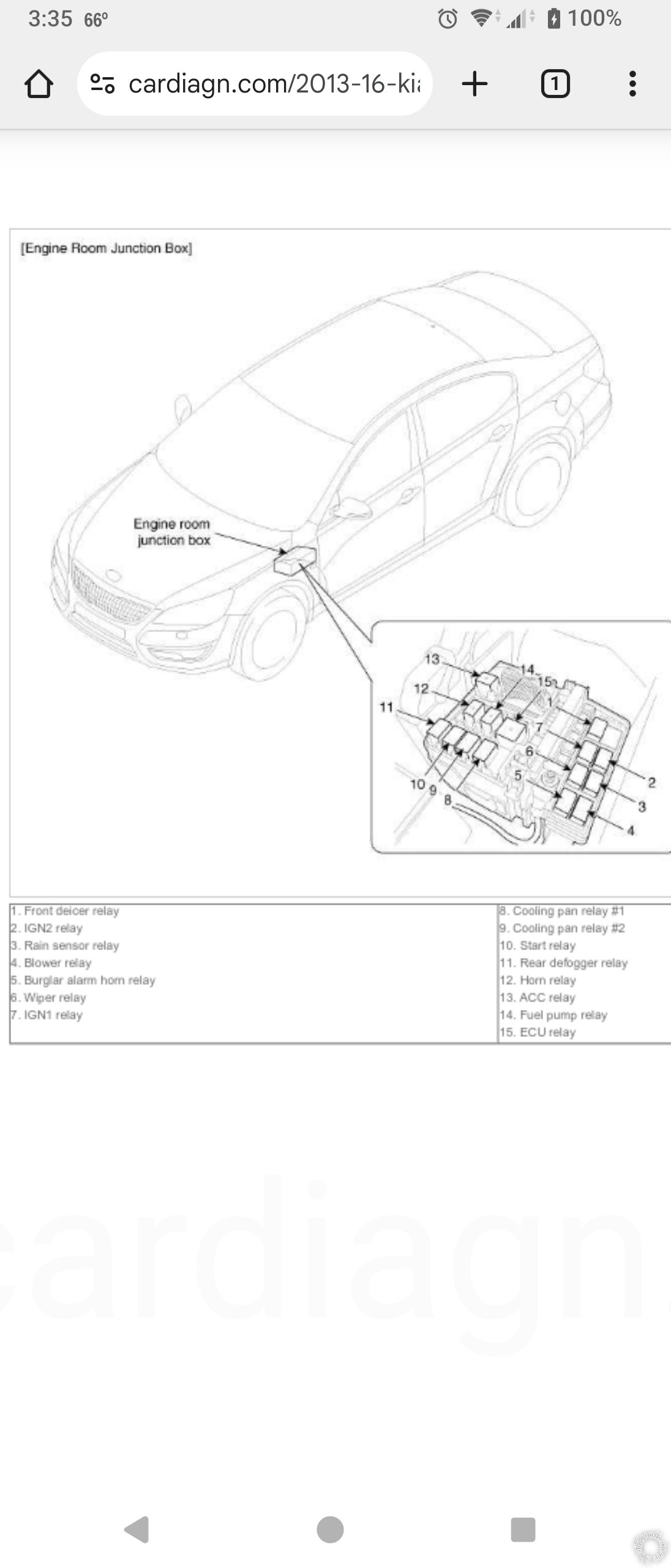

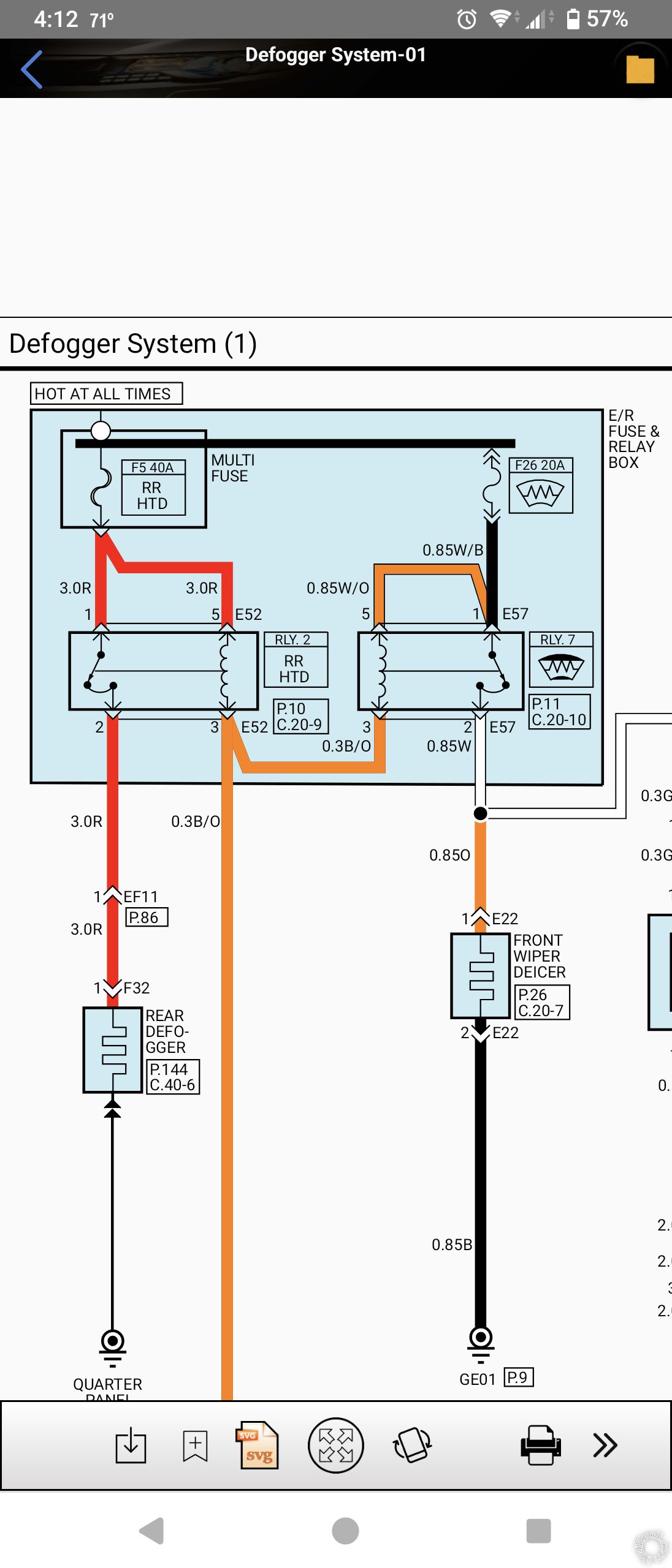

This shows relays 2 and 7. This is probably wrong, though. That picture above shows 2 and 7 are ignition relays.

The cover on the car's fuse box also indicates that 2 and 7 are ignition relays. For the time being I've decided to install a wireless disconnect relay. At least I won't have to physically disconnect the battery whenever I stop. I'm puzzled by why removing #11 relay reduces the drain only by half. I can never find info on the Cadenza. I had to figure out how to replace the steering assist rubber gear buffer, the speed control sensor on one of the wheels and how to disassemble one front door. No posts or videos. I was very glad to find this site and to get your assist. Thank you!
