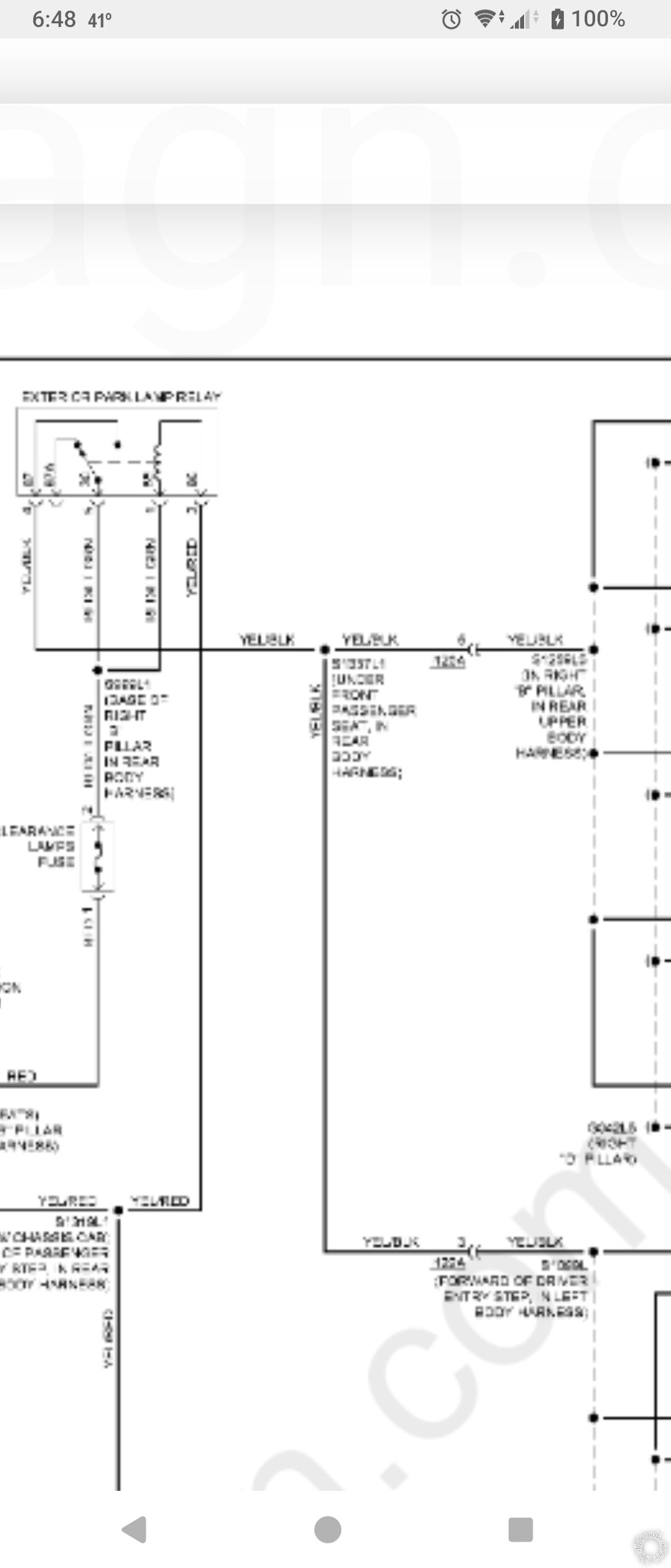

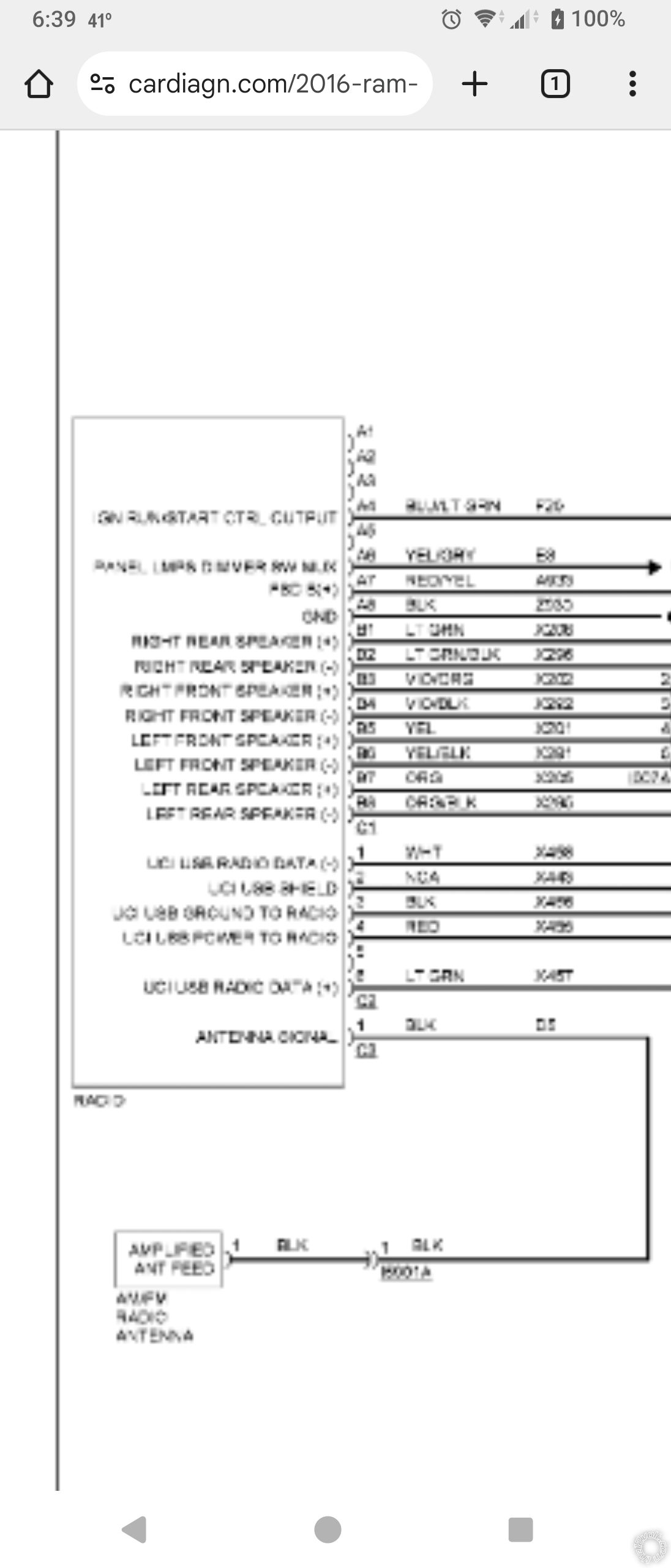

Pin A7 (red/black) should be constant. Pin A4 (blue/light green) should be switched. Dimmer and reverse signal are not in the same harness.

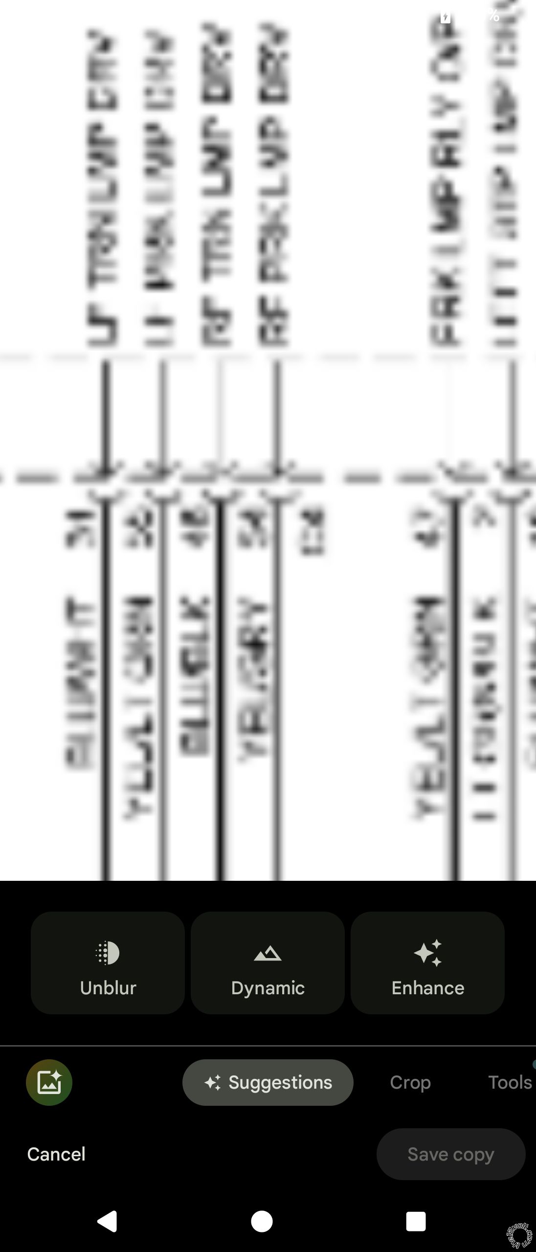

Rather than dimmer, it may be easier to use the illumination wire (positive parking light wire). The left front parking light wire shows yellow/light green at the BCM (C4/pin 56 I think) or right front shows yellow/grey (C4/pin 54 I think). It's pretty blurry. Or the yellow/black at any of the clearance lights would work.
Alternatively, you could use a relay to convert polarity from the switch (green/black negative).

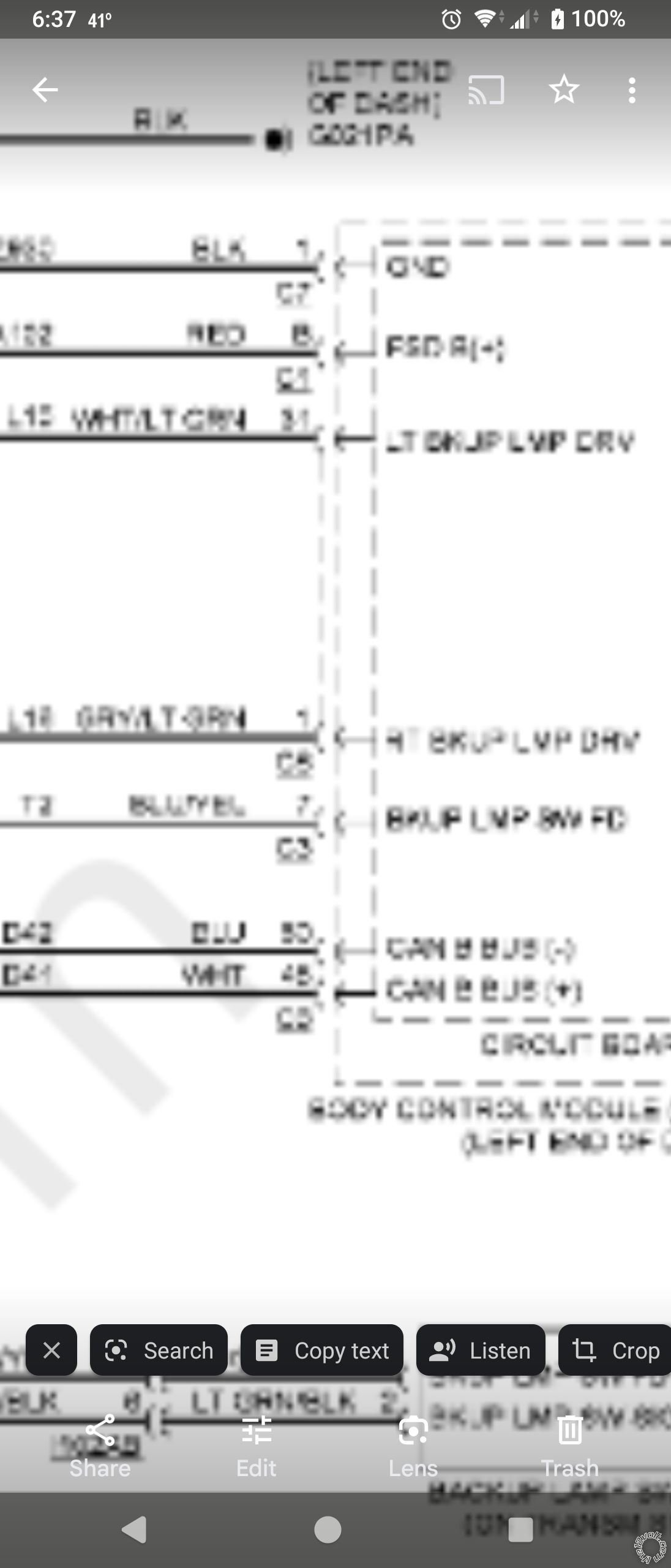

Left reverse lamp wire is white/light green at the BCM (C5/pin 31 I think). Right reverse lamp is grey/light green at the BCM (C5/pin 1 I think). It's pretty blurry.
