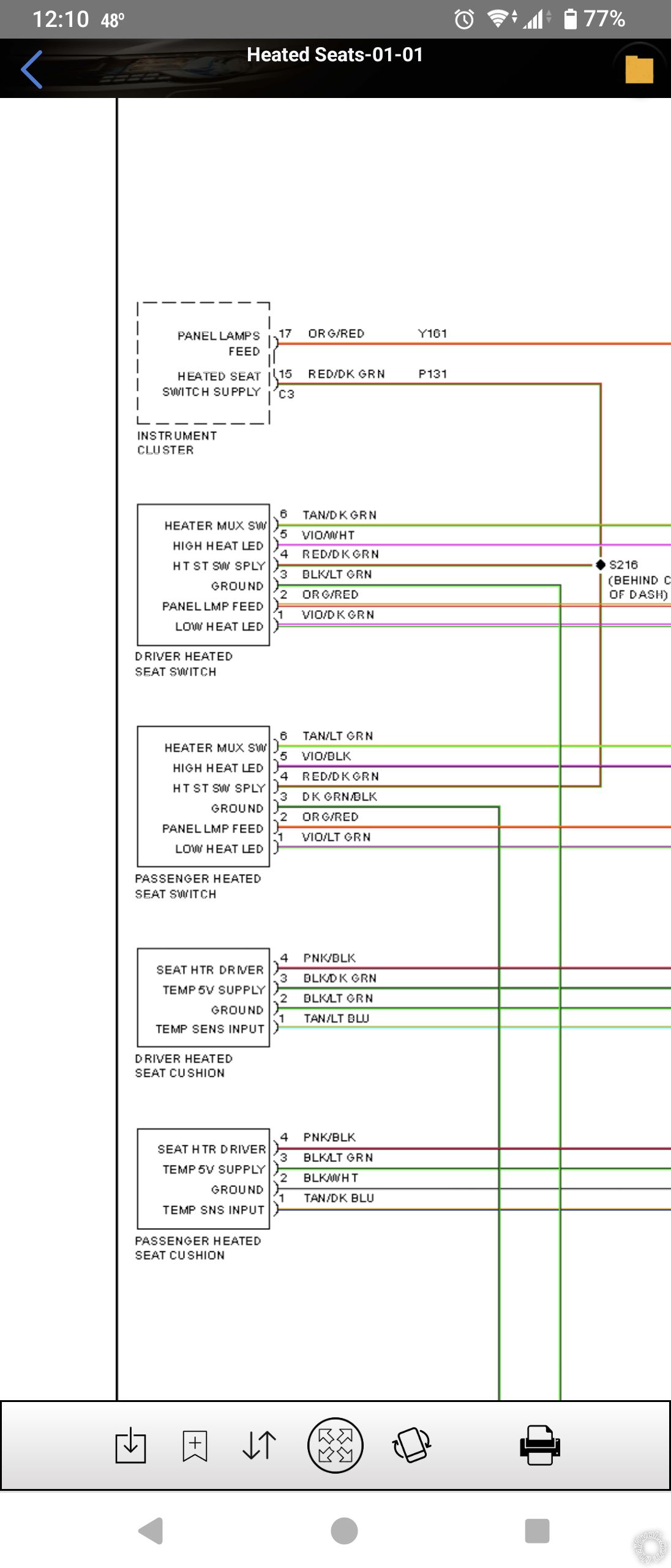

So I have a 2003 Dodge ram 2500 with factory heated seats. I am getting ready to install a compustar two way remote start with the drone add-on. My question is I would like to turn on the heated seats when I remote start the truck is that possible? If so, how would I do that pretty confident in putting in the remote start and wiring it in I’ve done a bunch of them. The heated seats, however, is a little above my knowledge base. Any input would be greatly appreciated.
jjr32111
lee.lopez
Copper - Posts: 312
Joined: September 02, 2024
Posted: January 24, 2025 at 12:12 PM / IP Logged Link to Post Post Reply Quote lee.lopez
Since it's a multiplexed system, the best method may be soldering small wires to the switch contacts and using a relay to jump the switch. You'll probably need to probe around with a meter to find what you need.
You can use the Compustar's rear defroster output to control this.

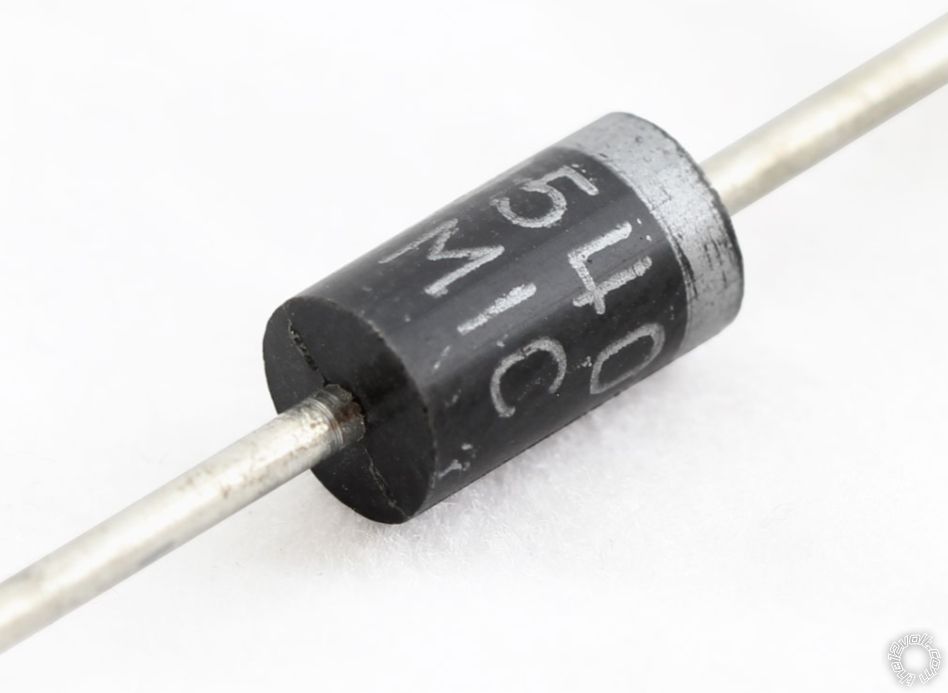

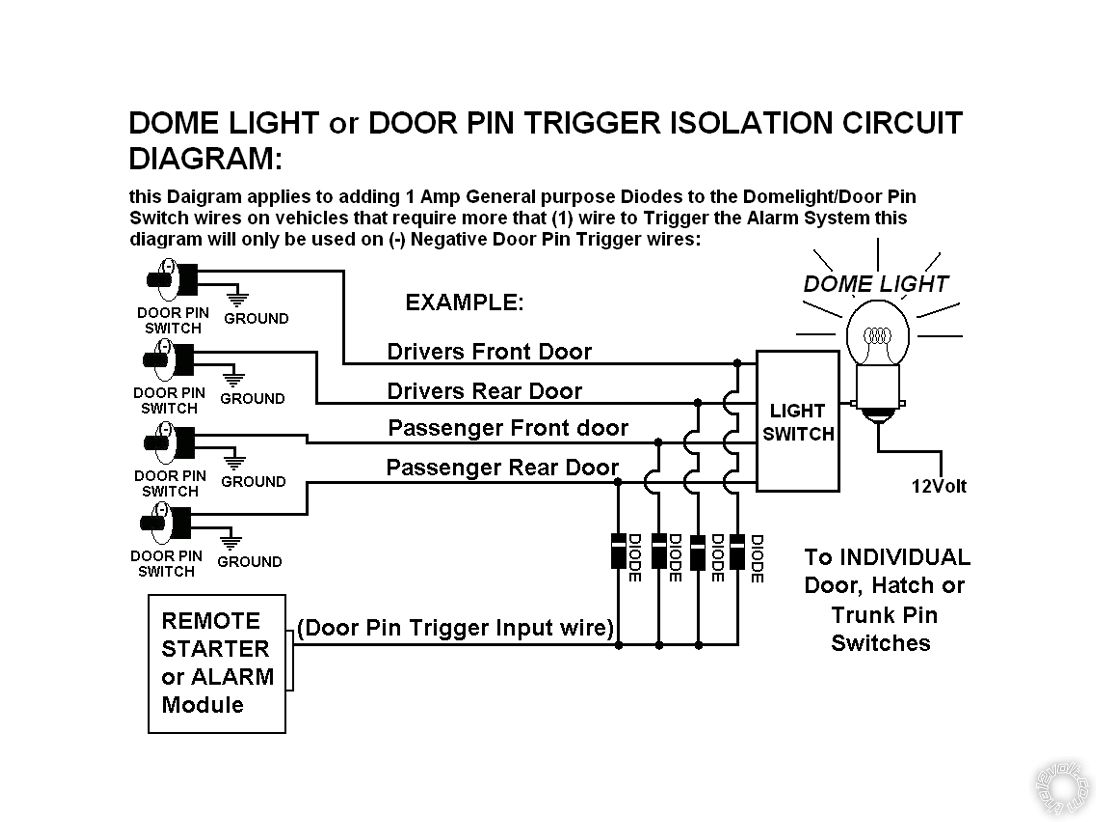

Yes, I saw that and definitely want to use it as a full alarm with all features. I grabbed some diode that were listed in the install directions from Amazon. Please forgive me for my ignorance. I know how to wire up a lot of stuff. Not really sure about diode. If I remember correctly they are Directional which direction do they go? Do I connect one to each of the door triggers And then connect them all together and send that wire to the coumpustar. Thanks again for all the help. I really appreciate it.
jjr32111
lee.lopez
Copper - Posts: 312
Posted: January 31, 2025 at 4:57 AM / IP Logged Link to Post Post Reply Quote lee.lopez
Diodes usually have a colored band on one end of the body. This is the negative side or cathode. This side will connect to the door side and the other side will connect to the alarm. Many multimeters have a diode testing function you can use to verify. You will get a reading with the leads connected if you have your negative lead connected to the banded side and positive lead connected to the other side. If you reverse the leads it should not give you a reading or display OL (outside limits). If your meter doesn't have a diode test, you can use the resistance setting.
Yes, you will bring them all together and connect them to the alarm input.
